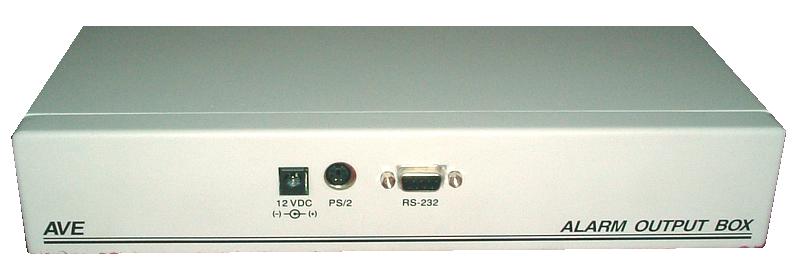

all of which can also connect PTZ or alarm I/O boxes (alarms)
I/O alarm box.
Most DVR Cards have alarm input cards or separate devices as an option.

As the others have said, most will use either an existing serial port, or some sort of add-on card. Some software can also use external USB or network-attached I/O devices, like this:
That's a function of the software, though, not the card itself.
