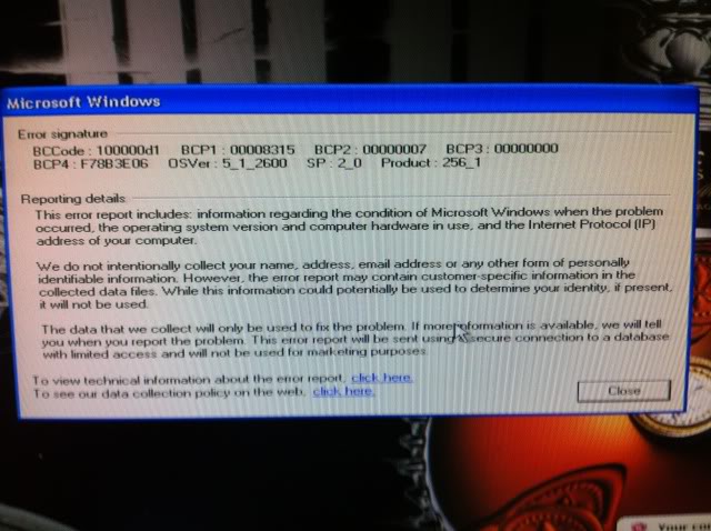

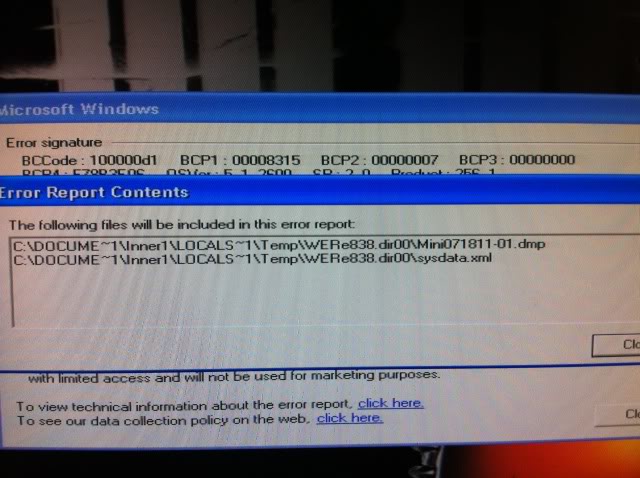

LQ1985 0 Posted July 19, 2011 Hello, My geovision V 8.31 keeps crashing every 2-3 hours 24hrs daily. I keeps saying Microsoft recovered from a serious error, i had the same PC for 1 year no issues till past week were it started to do this crash non-sense. Anybody know what i could do? Share this post Link to post Share on other sites

LQ1985 0 Posted July 19, 2011 Thank for all the help everyone. But when i go to the database repair after closing geovision and try to run database repair, i get the following (Repairlog500- database file is used by another application!. Please close another application before execution repairlog500.exe!.) I looked at my PC performance and its 90%-100%. Maybe this PC is just the bare minimum to run these 8 camera's? Specs: AMD Athlon XP 2600+ 2.13 GHz 736mb ram XP SP2 Will buying an newer PC help run the system better? Share this post Link to post Share on other sites
