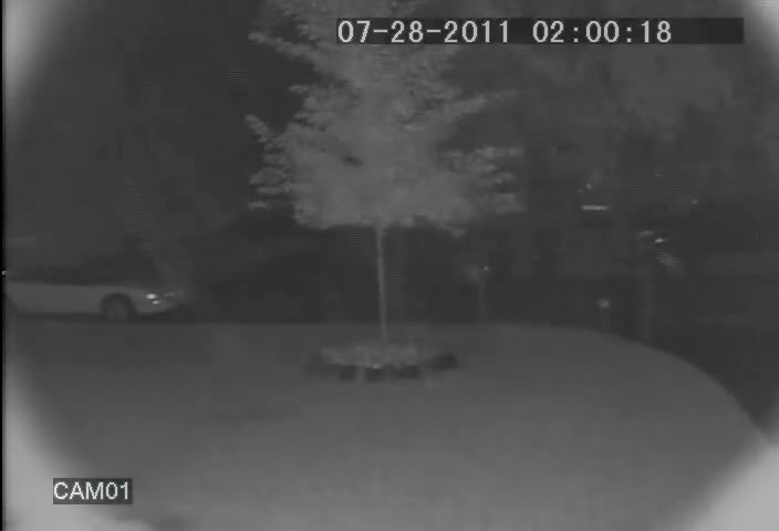

Marky48170 0 Posted July 28, 2011 I have a SONY CCD EFFIO-E 700TVL 2.8~12mm Camera Wide Angle and @ night with the IR's on, there is a ring that shows up. Is that because the IR is reflecting off the lens ring? The night pic isn't that good because its raining. Also I can see the IR's glowing red and my other cameras I can't even see them unless I take a digital picture then the show up as a blueish light. Share this post Link to post Share on other sites
rory 0 Posted July 28, 2011 Make sure the lens is as close to the front cover as it can be without the actual lens glass touching. Make sure if it uses a rubber ring and not a separate compartment for the IR that the ring is tight up against the glass. Its possible it IS tight against the glass and the camera is as far forward as it can go, but you might just have to zoom it in a little more. BTW, the camera looks like a Color IR camera, not a TDN with IR cutfilter, hence the washed out colors in the day. Share this post Link to post Share on other sites
Marky48170 0 Posted July 28, 2011 The ring extends beyond the IR's. The IR's are behind the lens. It's like this camera thats on youtube. I'm all new this this. Thanks Share this post Link to post Share on other sites

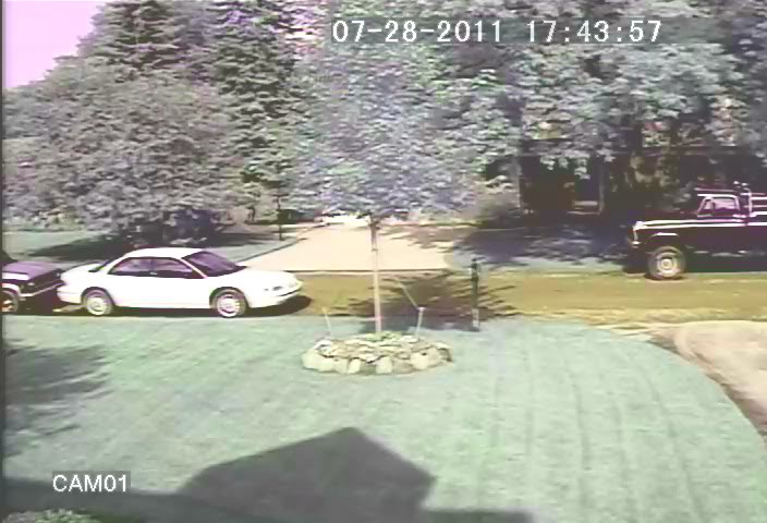

SEANHAWG 1 Posted July 29, 2011 Try zooming your lens in as rory said just a tad. I dont know why your picture looks so washed out during the day. I have dealt with a few cameras with effio chips in them and even without IR cut it produces a nice colorful picture, you may try checking your color settings on your DVR, perhaps lower the brightness and upper the saturation. The IR's glowing red is normal. Different cameras will have different strengths and more IR leds hence the differences in redness intensity. Share this post Link to post Share on other sites

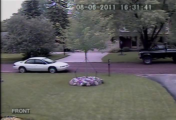

Marky48170 0 Posted August 6, 2011 Well I made more adjustments, looks alittle better than before. Not so washed out but then again its overcast outside. Between the camera and the DVR color adjustment this could drive you crazy Share this post Link to post Share on other sites
SEANHAWG 1 Posted August 7, 2011 Cool. Do you have your DVR set to the highest resolution and quality settings. The image appears a little "un-sharp" Also, you may want to check if your lens is fully focused too. I think you can get a sharper image with that camera. Of course you can also turn up the sharpness settings with that camera too but make sure your DVR is recording on the highest pixel size (d1) and make sure it is at its highest quality setting (bit rate). Check your lens too. Share this post Link to post Share on other sites
Birdman Adam 0 Posted August 7, 2011 If your DVR has a 'quality' setting, I would turn it up, if not to the max. As others said, refocus maybe? If you are unsure about settings in the camera or on the DVR, just go ahead and set them to default. Much easier to figure out whats wrong. IR LEDs glowing red is completely normal - your eyes can only pick up the very bottom end of the spectrum they LEDs are putting out, as IR is above red. If you can't see the dim red on your other cameras, either the IR is broken, the output is dim, or (most likely) - they are using covert IR (completely invisible to humans). You said this is an Effio-E? Funny, in that other thread we were comparing an Effio-P to a Monalisa - by this example, the CNBs blow these away! This doesn't appear to be TDN - colors are washed out during the day (shows that no IR filter is put in place during the day). Share this post Link to post Share on other sites

mike_va 0 Posted August 7, 2011 Marky48170 said: The ring extends beyond the IR's. The IR's are behind the lens. It's like this camera thats on youtube. I'm all new this this. Thanks Is this mounted outside or inside through a glass window? Share this post Link to post Share on other sites
