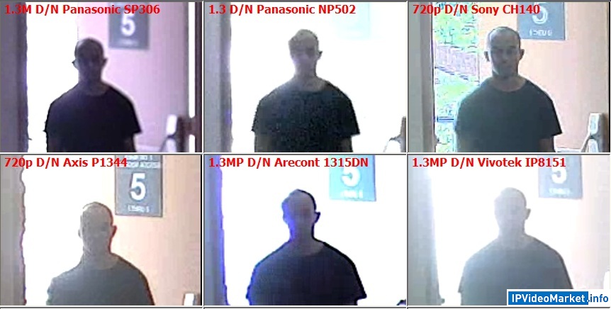

I would recomend a Sony Ipela with view-DR (Sonys own WDR) or a Panasonic with WDR. Not all cameras with WDR are equal though. Check out the following image as all of these cameras are marketed as WDR and as you can see some preform better then others.

That image is taken from an IP Video Market Shootout on WDR MP cameras.
I agree that WDR is needed here and that performance of WDR cameras can vary greatly.
That noted, at a 60 feet width FoV, this is going to be hard to get a lot of details, even with a multi-megapixel camera. Consider tightening the field of view if logistically possible.
