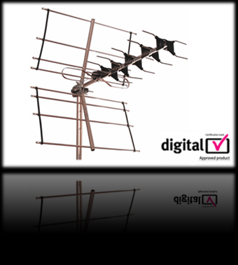

Antenna comes into Splitter box.....this is where your modulator should go, inline between antenna and splitter, make sure you buy a Modulator with Gain pot like Labgear.
The other thing is a loftbox, again there is a CCTV input on it but you still need to hook modulator into it and again turn the gain down on it as most are set to high causing lot problems

Yeah so the coax from the antenna goes into the modulator and feeds back into the splitter where the antenna was?
And do away with the splitter/boaster thats already there with the loft box in its place?
Yes
Scrap the splitter / booster thats there already and fit the loftbox in its place, rem they are F type plugs on loft box same as satelite connections not TV plugs thats probably already on there
They are a better and tider way of TV Dist and getting your CCTV inline

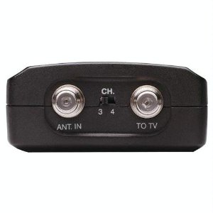

The standard for over-the-air signals is now digital (at least in the US?). However, I thought digital mods were expensive? Good thing is, most TVs that have a digital tuner, also receive analog.
Is your modulator digital or analog?
Analog:
Digital:
Typically your RF signal from the antenna would feed right through the modulator. No splitters required...
