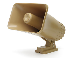

Soundy 1 Posted August 5, 2011 Most DVRs have relay outputs of some sort... one of those could easily be used to trigger a basic 12VDC siren. Share this post Link to post Share on other sites

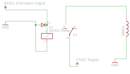

Birdman Adam 0 Posted August 5, 2011 (edited) For example, the Samsung I installed, it has 4 outputs. They put out 30VDC, with a maximum of 1.5A total. Get a nice big siren. So I would get a 30V normally open relay, hook it up to output 1. Then connect one side of the relay to a 12VDC source, and the other side to the positive connection of the siren. Negative connection of the siren goes to GND on the 12VDC source. IMPORTANT: Depending on your DVR, you may want to place a reverse-biased diode between the relay connections that the DVR will turn on. If your DVR uses transistors to switch these outputs, they may not like the high voltage spikes the coil in a relay puts out when it is switched off. I say that because I have fried some transistors before. That is a common practice when you are driving an inductive load from transistors. Now, I can open up my viewing software, connect from anywhere, and click on alarm output 1, and turn it ON. Freak out the loiterers, then shut it off. Maybe I will make a schematic to visualize this... EDIT: Edited August 5, 2011 by Guest Share this post Link to post Share on other sites

shockwave199 0 Posted August 5, 2011 For example, the Samsung I installed, it has 4 outputs. They put out 30VDC, with a maximum of 1.5A total. Get a nice big siren. So I would get a 30V normally open relay, hook it up to output 1. Then connect one side of the relay to a 12VDC source, and the other side to the positive connection of the siren. Negative connection of the siren goes to GND on the 12VDC source. IMPORTANT: Depending on your DVR, you may want to place a reverse-biased diode between the relay connections that the DVR will turn on. If your DVR uses transistors to switch these outputs, they may not like the high voltage spikes the coil in a relay puts out when it is switched off. I say that because I have fried some transistors before. That is a common practice when you are driving an inductive load from transistors. Now, I can open up my viewing software, connect from anywhere, and click on alarm output 1, and turn it ON. Freak out the loiterers, then shut it off. Maybe I will make a schematic to visualize this... EDIT: That is exactly what I would LOVE to have in line, but the eletronics and the hookup is beyond me. That diagram alone loses me. I hate being ignorant to something that's probably so simple. I gotta first check my manual and hopefully it'll have a schematic to at least tell me what voltage I'm dealing with. But after confirming the numbers, I'm still lost. I'll have to keep reading up on this. I really appreciate all the info guys. There is a dim light at the end of this tunnel now. Birdman- do you find a 'latency' in turning the siren on/off remotely? As much as I want to do this, I have neighbors all around that would probably strangle me if I lost control over turning a siren off, or if my three second hit turns out to be a thirty second hit! Dan Share this post Link to post Share on other sites
Birdman Adam 0 Posted August 5, 2011 Well, I have not actually implemented my schematic with the alarm outputs on my friend's DVR, but I would speculate that the lag between the button-press, and switching would be around 1-5 seconds. This includes network lag, computer lag, lag for the DVR to comprehend and turn on/off the output, etc, etc. So really, not a big deal. Basically, we need the model of your DVR, or a manual for your DVR, so that we can tell how to hook it up. as Soundy mentioned, each DVR may do switching a little different... I'm sure we'll be able to help you figure it out! BTW, here is an example of a relay you could use in my schematic: http://www.mouser.com/ProductDetail/Song-Chuan/833H-1C-C-24VDC/?qs=sGAEpiMZZMtSzCF3XBhmW4FnUX%252bQIJUKjw8ell6ZwZI%3d Datasheet: http://www.songchuanusa.com/system/pdfs/20/original/833h.pdf?1254413815 Scroll to the third page, look at 1C schematic. The two points between that coil is what you would connect to the DVR output, and GND. Now there is a switched point, as well as two other points the switch touches. The switched point (one that can flip up or down), would be connected to the positive terminal of the siren. Then, the NO (normally open) point, (the one the switch is not touching by default), would be connected to 12VDC. Then you just connect the negative terminal of the siren to GND, and you're good to go. Hey, its my 500'th post! Share this post Link to post Share on other sites

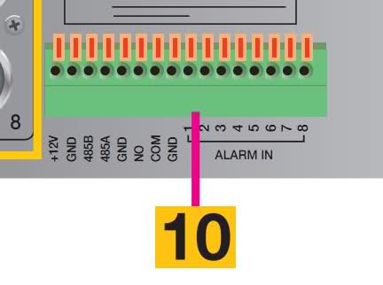

shockwave199 0 Posted August 5, 2011 Congrats on your 500th! Here's the manual- http://q-see.com/files/manuals/QS-Manual_web.pdf I have the 408. I hate combined product manuals, I really do. Such as it is... Page 8 for the specs of the block on my dvr Page 23 for the alarm settings in the dvr Dan Share this post Link to post Share on other sites
Birdman Adam 0 Posted August 5, 2011 Mmkay... The manual says yours has one alarm output, and 8 inputs. They have made this more way confusing than it needs to be... There is a NO, COM, and GND. Seems like maybe there is a small relay already inside. COM is the center of the relay (the part that flips), also called the pole. Then there is a NO contact that the pole, by default, does NOT touch. Now I don't know how big the relay is in there, so I would use it to drive a second relay we know can handle the load. So I would buy a 12VDC SPDT relay. Connect 12V terminal to COM terminal. Connect the coil connections of our second relay to NO and GND. Then connect a separate 12V supply (that can handle the siren, so probably 1A supply) to the center pole of our second relay. Connect the positive terminal of your siren to NO on our second relay, and connect the negative to the bigger 12V power supplies' GND. This is all a bit funkier than they had to make it... Before you do anything, take a digital multimeter, and set it to resistance measuring: -Measure between NO and COM with the alarm output OFF. It should read infinity, or at least a megaohm... -Measure between NO and COM with the alarm output ON. It should read less than 1 ohm. You may hear a small *click* when it turns on/off. Let me know what you find. Share this post Link to post Share on other sites

shockwave199 0 Posted August 8, 2011 According to the manual towards the end- ALARM I/O VOLTAGE 0-2V, low voltage, 5-30V high voltage In looking at my alarm settings in the dvr, I don't think the 408 supports manual triggering in this kind of setup. Darn. Dan Share this post Link to post Share on other sites

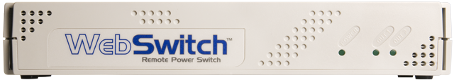

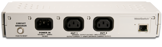

tomcctv 189 Posted August 8, 2011 Is there no easy solution to be able to turn on a siren remotely from the internet and then turn it off again? I remotely monitor my home overnight via an eight channel CCTV system and it's great. But I wish that if I spotted someone on my property at 3am, I could give a quick siren hit on & off to scare them off. I've seen some crumby home automation software and I've seen a power strip of sorts that you can control via remote commands, but it was pricey. And I don't want to call into a module to do it via a phone call. Anyone have any ideas? I can't believe there isn't some simple IP siren these days. Oh well. Any help would be great. Dan Hi shockwave. along with the DVR the remote software also needs to support voice. q.see pci cards have the option but not the standalone. but you do have a second option. you could use a pre recorded speech siren/ speaker. or record your own message. and run it along with a PIR sensor in the area you want to target. then on the q-see you can schedule the times you want the alarm to be active i.e 1am to 3am. optex beams do a speech. i have over 30 pre recordings if you want any. sample below. http://www.optex.co.uk/Site/downloads/3.mp3 Share this post Link to post Share on other sites

shockwave199 0 Posted August 10, 2011 Thanks for those suggestions Mike. Short of being easy with the dvr, I'll probably go with something like this- Either that or I'll just upgrade to a dvr that supports the function. I'm not much of a tinkerer. Plug & play all the way! Or, I might cheap out and go with something just as effective, only my remote switch would be a human- Dan Share this post Link to post Share on other sites
