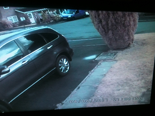

jim_mids 0 Posted August 6, 2011 Yeah , there's settings on the tv - quite detailed , but dont know of they are going to make any difference. Just out of interest , here's a screen shot - as you can see , some of the image is ok - but the tree and grass are a nice shade of pink! , also black tends to look pink! Share this post Link to post Share on other sites

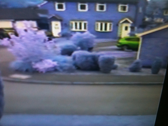

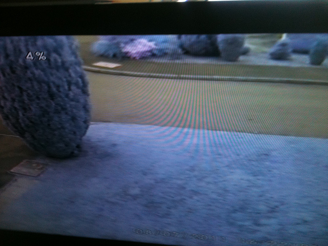

jim_mids 0 Posted August 7, 2011 Thanks for the reply .. here's what I have tried so far : Tried another TV for both live view and playback of recorded , same issues , colours all wrong. Swapped the scart adapter , currently the route is bnc to phono into scart adapter. Also tried phono straight into yellow video input - same results. Tried swapping cameras , same problem. Used a camera indoors under natural lights - my skin appeared blue , and blacks appeared pink! Interesting thing is , early morning the colours appear correct - after about 9am it all goes down hill again. Ive included a few more stills , just to give a better idea. As you can see form this one - the car appears green , its actually light blue! And the brickwork is blue! And in this one, my nice blue grass!. Any more ideas guys? Jim Share this post Link to post Share on other sites
shockwave199 0 Posted August 9, 2011 Have you tried tweaking any of the display settings in the dvr for each camera? There should be picture settings to adjust. Could be your hue is off and you need to drop the saturation a ton. Thing is though- blue skin and all is just pointing to REALLY poor cameras. I've had some q-see cmos cameras up and the landscape colors weren't accurate because there is no IR cutoff- which I believe is your problem coupled with just a horrid camera. But even still, my cameras showed accurate color for clothing and skin. You could identify what colors someone was wearing perfectly, or the colors of cars, but the leaves on the trees in the same shot were purple. Your colors are just whacked, totally. Try adjusting and if all else fails, return the package for something better. Good luck. Dan Share this post Link to post Share on other sites

^Gecko^ 0 Posted November 28, 2016 The screenshots definitely make it look like there is no IR filter at all. Nothing can be done about this. Share this post Link to post Share on other sites
