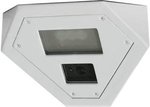

Numb-nuts 1 Posted August 7, 2011 Alternatively, I have a corner camera mounted to the left of my door in the porch aswell as the doorview camera. It takes a board camera and a 2 mm wide angle lens. Again, I spent the money on TVL rather than colour. This is an Eneo housing and board camera but it does require additional lighting support at night. There is a model of complete camera for corner mounting by Bosh in their extreme range which has IR support built in and also thie pictured model below This is a link to the google page Share this post Link to post Share on other sites

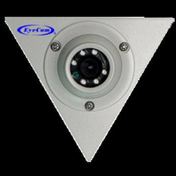

liveinxs 0 Posted August 17, 2011 just in case you haven't made a firm decision yet, you might want to check out this camera, is Vandal Proof, and could be installed to the side of a door, enabling you to capture a perps face...also this has the Monalisa chip you were looking for... i just ordered one today for my home, looking forward to checking it out... Share this post Link to post Share on other sites
