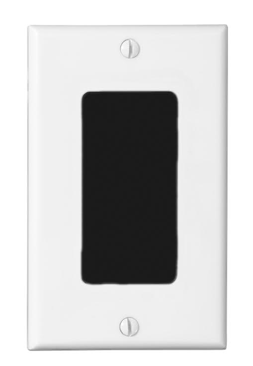

nDAlk90 0 Posted December 20, 2011 Your adding cameras inside the home? I think that a dome camera would not look so good in a home unless you want it to be visible. I think a camera like this would blend in much nicer to any home decor. The camera is behind the glass/plastic and the cover can be white, silver, etc. http://www.channelvision.com/index.php/NEW-Products/Single-Gang-Box-Hi-Resolution-Color-Camera-6204-212/flypage.tpl.html Share this post Link to post Share on other sites
liveinxs 0 Posted December 20, 2011 xellbuy said: Your adding cameras inside the home? I think that a dome camera would not look so good in a home unless you want it to be visible. I think a camera like this would blend in much nicer to any home decor. The camera is behind the glass/plastic and the cover can be white, silver, etc. http://www.channelvision.com/index.php/NEW-Products/Single-Gang-Box-Hi-Resolution-Color-Camera-6204-212/flypage.tpl.html i like this idea,,,pretty good place to place a camera, as it will be low enough to capture a face possibly, not the top of a hat... Share this post Link to post Share on other sites
rory 0 Posted December 20, 2011 xellbuy said: Your adding cameras inside the home? I think that a dome camera would not look so good in a home unless you want it to be visible. I think a camera like this would blend in much nicer to any home decor. The camera is behind the glass/plastic and the cover can be white, silver, etc. http://www.channelvision.com/index.php/NEW-Products/Single-Gang-Box-Hi-Resolution-Color-Camera-6204-212/flypage.tpl.html you can make your own for ALOT less. Share this post Link to post Share on other sites
