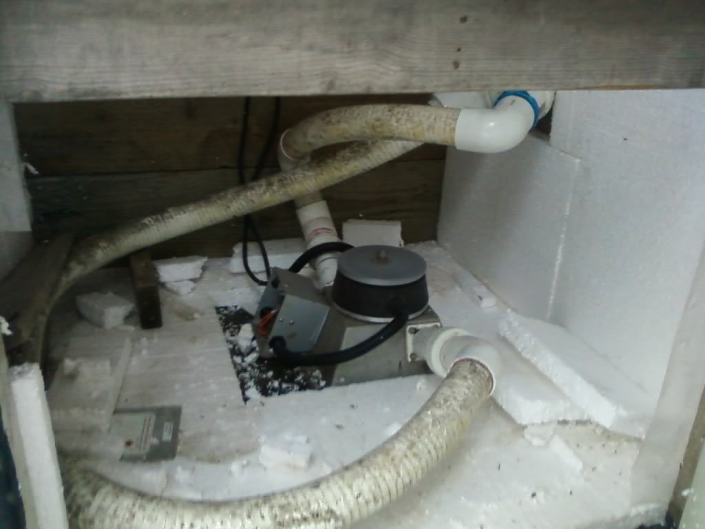

HiddenMountain 0 Posted August 20, 2011 Actually, we do have a couple of 100W floods in the front of the house, but we sure don't leave them on for too long! The gizmo is called a "Stream Engine", it's made by a company in Nova Scotia called Energy Systems & Design. It generates 30A @ 12V and we store the power in 8, 100 AH batteries. The excess power is sent into a "load dump", a basic heating element. We invert to 120V AC with a pure sine inverter, which runs the washing machine, power tools, fridge and all the other goodies. I have some pictures on my laptop hard drive (LT died a couple of weeks ago), but it'll take some doing to post them and after a long week on the road, I'm ready for bed.... I'll work on getting them up tomorrow. Share this post Link to post Share on other sites

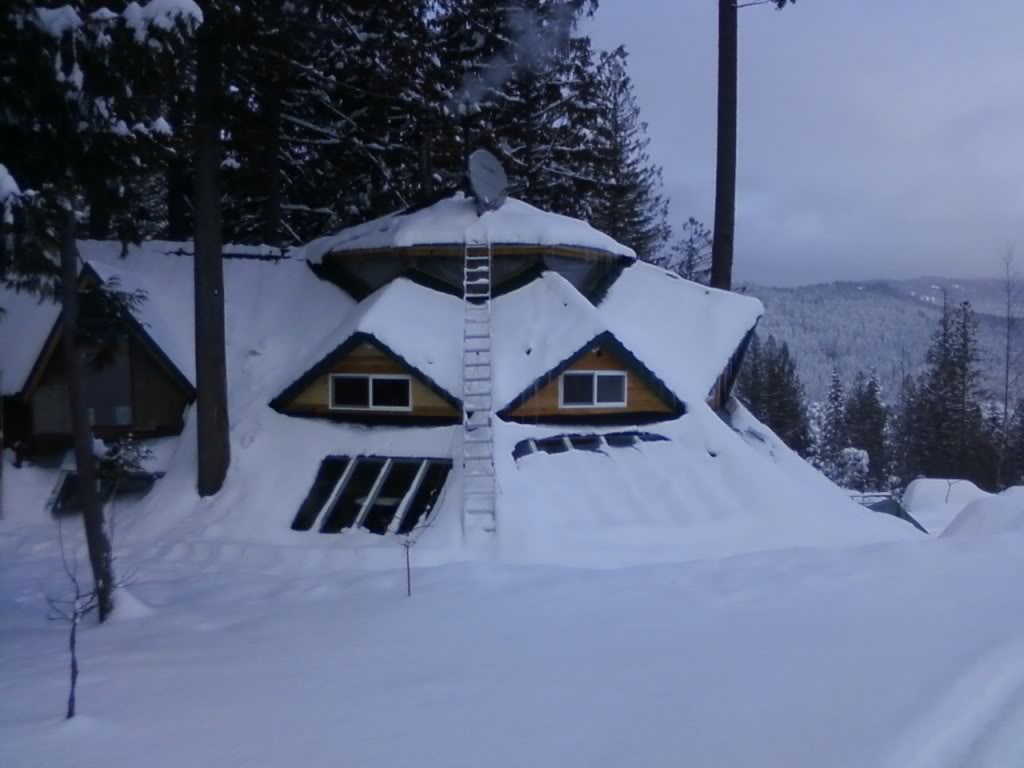

HiddenMountain 0 Posted August 22, 2011 That is so cool! Do you have any pictures/videos of your generator setup? How do you store your power when the stream output slows? Battery array of some sort? Also, when you are choosing your LED bulbs, the main things you need to compare is the lumen rating (light output), as well as the beam spread of the light. There are other things like color temperature. Warm colors like 2700K look better typically (because people are used to the warm color of incandescents). I bet plugging in a 100W incandescent flood would be a big no-no in your house! We call it "The Snow Cave" One Stream Engine chugging along nicely. It was 20 below Celcius the day I took the pic. Share this post Link to post Share on other sites
hardwired 0 Posted August 22, 2011 Forgive my ignorance (I live in an area where people panic below 0C), but how is your stream still running at -20C?...I guess it still stays running at some depth below the surface ice? Seems pretty neat, overall- I was wondering if the load dump could be (or is already) a separate element in your water heater, to be able to gain heat from that, instead of being wasted? Share this post Link to post Share on other sites
Birdman Adam 0 Posted August 22, 2011 From what I've read, water won't freeze if it is moving fast enough. So water rushing through those pipes should work well below 0! Share this post Link to post Share on other sites
HiddenMountain 0 Posted August 23, 2011 I guess it still stays running at some depth below the surface ice? I was wondering if the load dump could be (or is already) a separate element in your water heater, to be able to gain heat from that, instead of being wasted? Yep, the water never freezes under the ice... that's the trick. The only time we have serious freezing issues is on clear nights at -30 and below. We get what they call "frizzle ice", little slivers of ice floating in the water that clings to everything, especially our intake screen! That pic of the turbine was taken after one such incident. I spent the better part of 2 days fighting the freeze, eventually gave in and pulled the pipe and started the genny.... I hate that... Share this post Link to post Share on other sites
