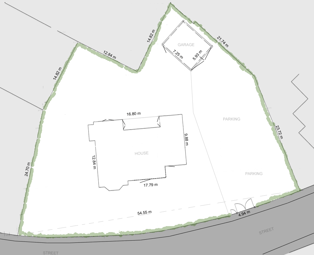

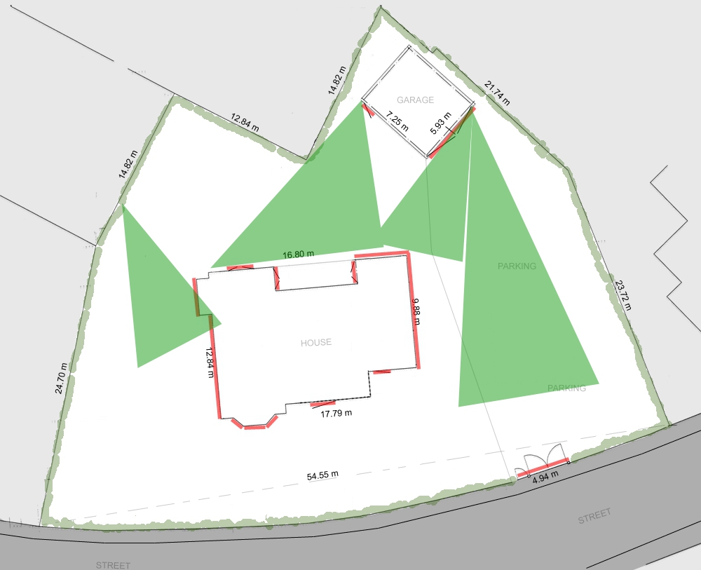

ljnl 0 Posted August 24, 2011 Hi, I'm trying to figure out the best way to setup cameras (and the needed wires) for home surveillance. This is a map of my house + surrounding area: (Red lines indicate the points of interest e.g. windows & entrances.) The house is surrounded by a hedge which is about 2.20m in height. The yard is as good as obstacle free (there are some small trees but nothing that can block the view of a camera). The house itself is about 9m in height. It's not possible to put cables under the parking area (it's sunken in cement, so I can't reach the ground underneath it). At the rear of the house (the 16.80m wall) there is a solid stone floor (patio), so it's not possible to let cables enter the house via that wall because they would have to go over the stone floor and be visible. Cameras: I'm going for CNB VBM-24VF cameras (with a wallmount) connected to a AVTech AVC796(B) 8 channel DVR. I don't know exactly how many cameras I'll need at this point. On the front of the house (bottom left corner of the picture) I'm planning to mount a AVTech AVN244 IP PTZ Speed dome on the second floor (to monitor the street). The AVN244 is only for 'looking around' not for recording. So the front of the house still needs to be covered by a camera connected to the DVR. Lights: There is a decent amount of light coming from the street, but on the rear of the house I think I need some additional lights. This can me IR or floodlights (no neighbors on that side). I have to test the VBM-24VFs to see how the perform with the current light. Cables: I've read about a lot of options to wire the cameras but I'm kinda lost. I do like the idea of 1 cable per camera (combining power + video). I guess the needed cable depends on the distance of the specific camera? I'm not sure if I want to place the DVR in the house or in the garage. But the DVR needs to be connected to the internet and there is currently no internet connection in the garage. Some other info: - The setup is not for identification, but just to see 'whats going on'. - I'd like to stay away from drilling holes (yes, that's right ) - I'm not a big fan of camera posts/masts - I have no experience in any of this so any help or advice is much appreciated - I already own the AVC796 and AVN244 so that's what I'll have to work with I'd like to see how you guys think about this project. Thanks in advance for any tips, info & help! All the best, LJ Share this post Link to post Share on other sites

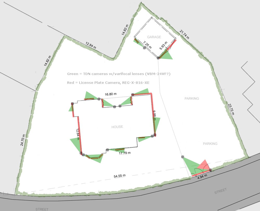

Birdman Adam 0 Posted August 24, 2011 Wow - that is probably the most awesome layout I've seen - the picture makes it very easy for me to think about this!! Here is my suggested layout. Its definitely not perfect, but just my first thoughts... My setup requires 13 CNB's and one license-plate camera. So it would require a 16-ch DVR. The whole thing is overkill, but you could 'trim' cameras/angles you don't want to get it down to 8. This setup would provide good identification at all the red-line areas, as well as license plates. Cables: cat5 w/baluns for sure. One pair for video, I use 2 pairs for power to minimize voltage drop. Extra pair for anything. PTZ camera should be powered by separate cable, 18/2. The video down one pair, data through one pair. What do you mean by wall-mount? Those pendant things? Honestly I don't think that would look good on your house. It would be more discreet if you could flush-mount the VBM-24VF's under eaves or something? If not that, then just put them right on the wall. (The camera inside can be swiveled, rotated, etc to still have a perfect picture while the camera case is sideways.) Share this post Link to post Share on other sites

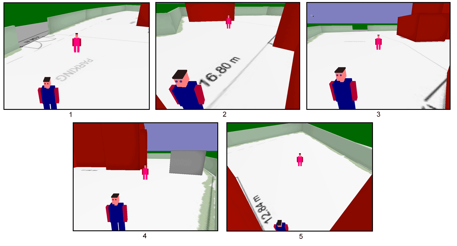

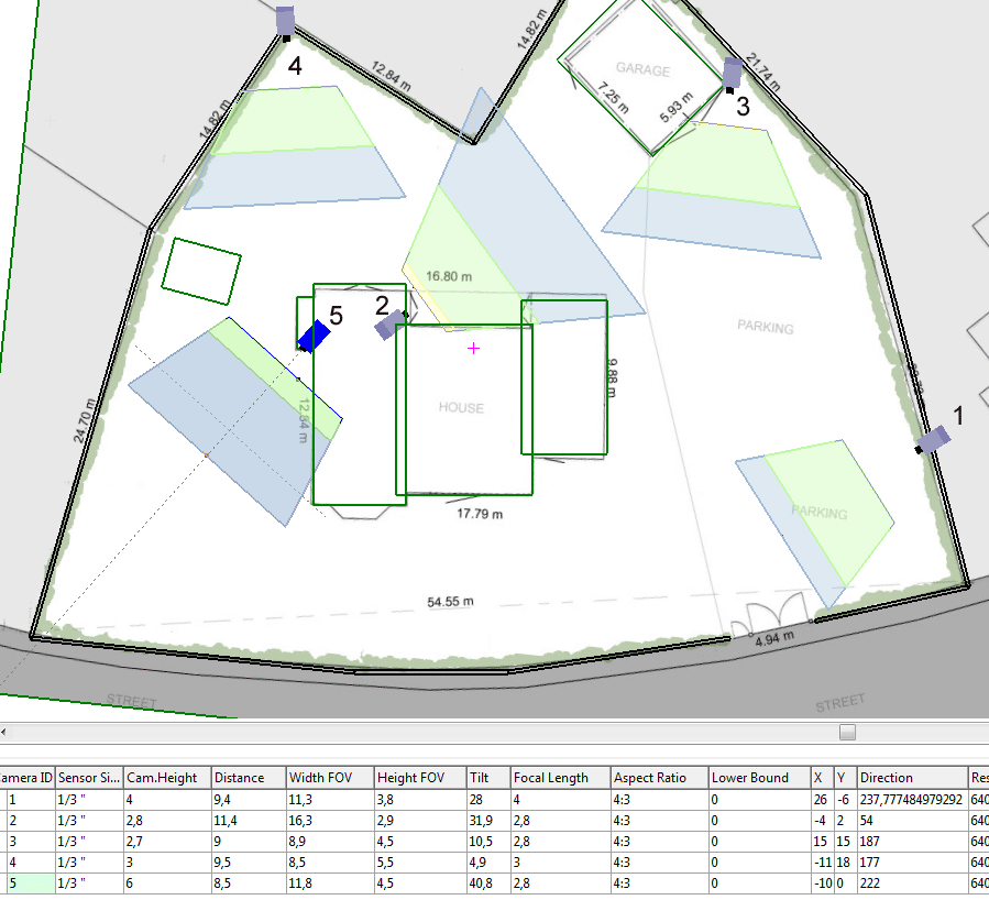

ljnl 0 Posted August 24, 2011 Birdman Adam said: the picture makes it very easy for me to think about this!! That was the idea Thanks for thinking with me on this! You setup is indeed 'all out' In the future I might get more cameras to get better identification, but for now I just need a solid 'overview' setup. I've played around in the CCTV Design Tool software. This gives some more insight on what I'm trying to accomplish: The camera setup: The camera views: I'm looking at 5 x CNB VBM-24VF (the PTZ IP cam is not in this layout). You have a good point on mounting the cameras sideways. It saves on costs and would look better indeed! Flush-mounting is not an option. Oh btw, a small change in layout: I forgot about a greenhouse located on the left of the house (the grey square on camera view #4). Share this post Link to post Share on other sites

Birdman Adam 0 Posted August 24, 2011 (edited) That is a very good point Chris! Cameras viewing the parking entrance, greenhouse, and garage red-line areas could be viewed by a box camera with varifocal lens. This may help you out with that: BBM-24F with this lens GL0550AV Then use an enclosure like this, with a bracket to mount it to the wall.. I think I'll update a picture in a sec... EDIT: 3 BBM-24F's in enclosures with 5~50mm lens have overviews on the garage, the parking entrance, and the greenhouse (did you need to watch this?). All entrances can be watched by VBM-24VF's, some will be set to their widest to catch 2 doors at once. This setup is a lot more "whats-up" oriented. I would mount all cameras to walls, and I think your going to need to drill *small* holes to get your cat5 into the attic, then down into a room with the DVR. Edited August 24, 2011 by Guest Share this post Link to post Share on other sites
ljnl 0 Posted August 24, 2011 That kind of bracket + enclosure is a no-go. It stands out to much on the house I kind of like the low profile of the CNB dome camera, especially with the new idea to mount them sideways. How about the idea of placing the DVR in the garage? In the current setup there are only 2 cameras on the house, and 3 outside. Only thing that needs to be done is put a internet cable to the garage from the house (Plus, I think I can manage to drill some holes in the garage wall ) Share this post Link to post Share on other sites

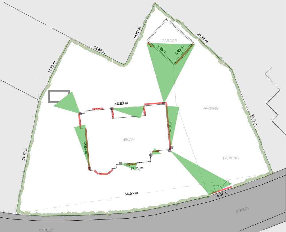

Birdman Adam 0 Posted August 24, 2011 I think that could work - but if you use domes you're limited to 10.5mm to watch the house from a rather far distance. If its not really for identification, this ought to be fine? Maybe some calculations are needed... Something like this?: Share this post Link to post Share on other sites
ljnl 0 Posted August 24, 2011 That looks good! I would need one more camera on the bottom left of the picture, to cover the front of the house. Birdman Adam said: if you use domes you're limited to 10.5mm That's 'zoomed in', right? Most of the cameras should be between 2,8mm and 4mm. I want the wide view so each camera covers as much ground as possible (look at the 'Views' image above). Share this post Link to post Share on other sites
Birdman Adam 0 Posted August 24, 2011 Yes, I believe the VBM-24VF's go from 2.8-10.5mm. Share this post Link to post Share on other sites
ljnl 0 Posted August 24, 2011 Correct, ok, I'll try that 'garage based' layout in the CCTV Design Tool! Share this post Link to post Share on other sites

tomcctv 190 Posted August 24, 2011 ljnl said: I was under the impression that the CNB VBM-24VF works very well in low light? they are good low light cameras. but not at 70-80 ft which is the least you are looking for. like your camera 2 in you photo will not see your garage at night. cam 4 will not see your house at night. the CNB VBM-24VF is good for close work. i know you say you dont need identification. but if something did happen you wish you did. Share this post Link to post Share on other sites
ljnl 0 Posted August 24, 2011 tomcctv said: like your camera 2 in you photo will not see your garage at night. The garage is about 55 ft from camera #2. I do think you are right though, I will need some lighting. But I'll have to see what cameras need lighting once they are up (#2 and #4 are probably the ones, yes). tomcctv said: i know you say you dont need identification. but if something did happen you wish you did. It's not like we have things of great value. Besides, the 'things' that do happen around here are all done by the same black clothed, cap wearing dude. In other words there is no way you can see their faces When we are not at home, they can try their luck, the house is rigged with a fine alarm system. The camera system is more for when we are at home, so we can check the property with one look on the iPad or iPhone. And if something is detected, say at night, I can respond to it. Share this post Link to post Share on other sites

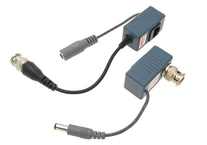

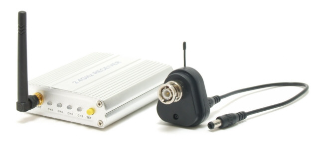

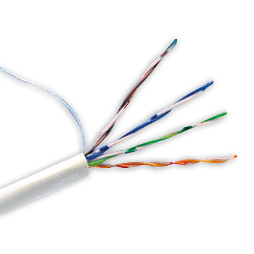

ljnl 0 Posted August 25, 2011 Ok, let's talk a bit about the cables. Birdman Adam said: Cables: cat5 w/baluns for sure. One pair for video, I use 2 pairs for power to minimize voltage drop. Extra pair for anything. PTZ camera should be powered by separate cable, 18/2. The video down one pair, data through one pair. I like to use 1 cable combined for video and power. And of course I like to keep the best quality. In the worst case scenario the longest cable will be around 80 meters (260 ft). What I'm thinking about: or Another possible option (for the most distant camera): wireless.. Small note: some cameras in my layout have a power source near them so this product (or something like it) could be used for the video feed: Has anyone had any good experience with a wireless connection? Share this post Link to post Share on other sites
tomcctv 190 Posted August 25, 2011 hi. i would use CAT5 and baluns not the lead kits you have listed. Share this post Link to post Share on other sites
Birdman Adam 0 Posted August 25, 2011 Yup - stay away from the wireless. It is typically more expensive than cables of any kind, and quality is usually lost in transmission with cheaper systems. cat5 with baluns is quite easy to do. If you can pull cables, strip wires, tighten screws, and remember colors, you are good to go! With coax, it seems to take more practice to get the connectors on properly. Plus coax is more expensive! So buy a 1000' roll of UTP cable and some baluns. Maybe buy the cable in like gray, so it doesn't stand out anywhere it is visible. You can make connections inside the enclosure at the top of the VCM-24VF. Then run them out one of the portholes and into the wall/ceiling/etc. One pair is used for video, then you have 3 other pairs for whatever you want! I use brown for video, orange (both wires) for positive, green (both wires) for negative in terms of power. When I did the system at the cabin I used the blue pair as a tamper loop that was connected to a zone on the alarm system. If anyone cut the cable, the alarm would go off! Share this post Link to post Share on other sites
Soundy 1 Posted August 25, 2011 ljnl said: Another possible option (for the most distant camera): wireless.. Small note: some cameras in my layout have a power source near them so this product (or something like it) could be used for the video feed: Has anyone had any good experience with a wireless connection? Hahahah, that's funny, just for the "distance" contradiction Wireless like this is functional to MAYBE 100' line-of-sight... less through walls, and with steadily dropping quality the further you go (at maximum range, you may have a picture, but it will be unwatchable). Share this post Link to post Share on other sites
ljnl 0 Posted August 26, 2011 Soundy said: Wireless like this is functional to MAYBE 100' line-of-sight... less through walls, and with steadily dropping quality the further you go (at maximum range, you may have a picture, but it will be unwatchable). I'll stay away from wireless tomcctv said: hi. i would use CAT5 and baluns not the lead kits you have listed. Birdman Adam said: One pair is used for video, then you have 3 other pairs for whatever you want! I use brown for video, orange (both wires) for positive, green (both wires) for negative in terms of power. How would I connect the power to the cat5 cable? (from the power adapter to the cable, and from the cable to the camera) EDIT: Ah, like this: Share this post Link to post Share on other sites
Soundy 1 Posted August 26, 2011 ljnl said: How would I connect the power to the cat5 cable? (from the power adapter to the cable, and from the cable to the camera) EDIT: Ah, like this: You can use the neat little screw connectors like in that video, if the camera is 12VDC... or you can use terminal strips, your favorite type of crimp connectors, or if you're really hardcore, twist, solder and heatshrink. Share this post Link to post Share on other sites
ljnl 0 Posted August 27, 2011 You mean soldering the camera power wires to the cat5 power wires? That sounds like the easiest option.. And I saves me buying screw connectors Share this post Link to post Share on other sites
