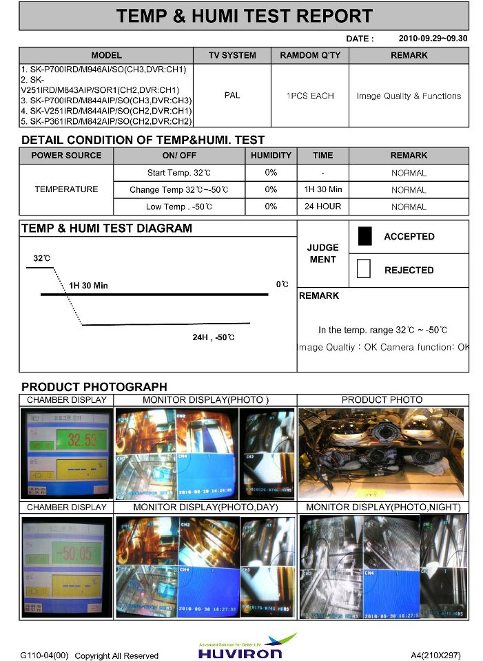

We did cold chamber test for the Russian market regulation.
All of our outdoor cameras were managed to run at -50 degrees celsius (-58F) without heaters
We still have almost none temperature related issues even in Russia.
With heater, it may help a little, but in most cases, heater is just a ceramic resistance which is not very effective at extremely cold weather.
