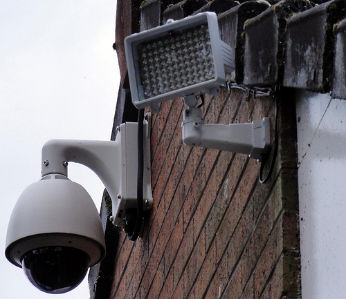

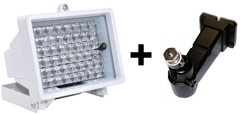

Numb-nuts 1 Posted August 29, 2011 I have had an IR floodlamp for some time, but not used it yet since it doesn't have the range of adjustment to suit my purpose. What I am referring to is that it can only be adjusted on it\s bracket vertically but it cannot pan around horizontally. I decided to modify it to my own range of motion adjustment and I am very pleased with the result. I used a silver bracket, rubbed it all ver with wire wool before spray painting it white to match the IR lamp. I tapped a 1/4" unc hole into the underside of the IR housing unfortunately the aluminum or aluminium (UK) was not strong enough so I installed a repair washers either side of the thread and placed a nut inside the housing to fix it rock solid. Then it was just a matter of fitting it to the bracket and installing. The result has been a tremedous improvement in range of adjustment. Of course, I realize it would have been less trouble to buy a IR light with a swivel bracket in the first place, but I am still very pleased with the result and enjoyed modifying it. And the result Share this post Link to post Share on other sites
