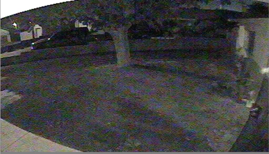

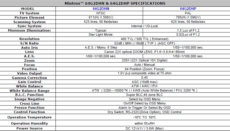

HTElectrical 0 Posted September 1, 2011 I installed a VCM-24VF recently, and the daytime pictures are ok, but at night it is terrible. Here is a screen shot of the CNB and the next is of a Mintron™ Model 64G2DHN pointing the opposite direction. Both have similar amounts of light. What am I doing wrong? I tried adjusting the different settings, but this is rediculous. Specs for Mintron Share this post Link to post Share on other sites

HTElectrical 0 Posted September 1, 2011 For a camera that is suppose to be so good the night time picture SUCKS. The MIntron looks great at night, even at lower light levels and is only in color, with very little noise. Rory, I will try your recommendations and see if I can get anything better out of it. Thanks. Share this post Link to post Share on other sites

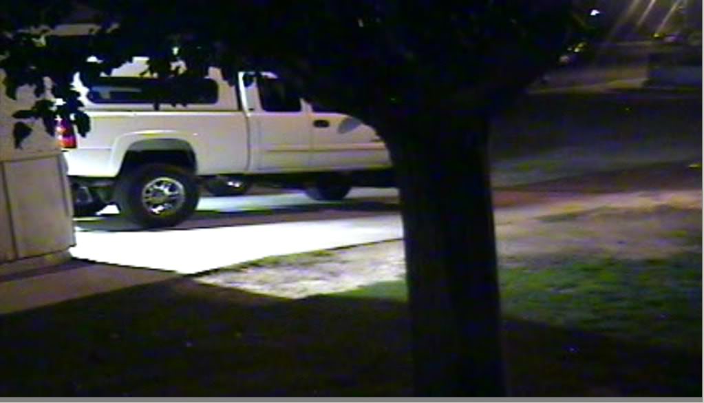

HTElectrical 0 Posted September 1, 2011 Not the best, but there is another camera in the left corner pointing to the street. Cutting down the tree didn't seem reasonable, even though I suggested it. Share this post Link to post Share on other sites

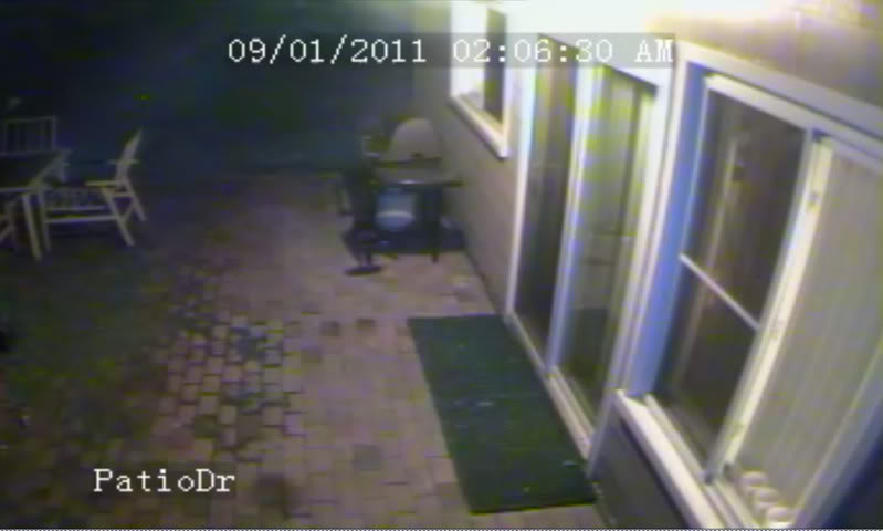

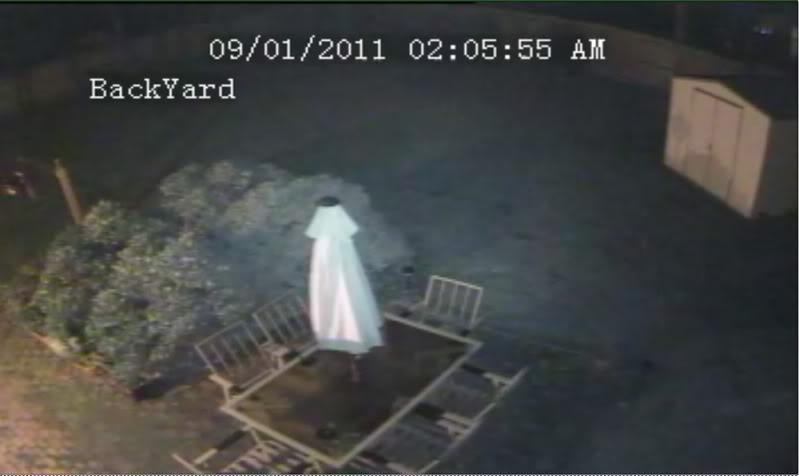

shockwave199 0 Posted September 1, 2011 But then for that to work it really needs to switch to BW, and many times it does not if there is even a single small light in the video. I know I'm talking about a completely different camera, but it does just that. The overhead light is enough to keep it in color, but then along the way it'll switch to BW anyway. Sometimes it takes hours though. The green on the brick is actually green moss. And with that light off, it's nice BW This one gets just enough of the same light to be in color too. These are not TDN's. No control over any settings. Point and shoot cams. I don't mind the color really, so long as it's not super noisy. HT- you don't happen to have saturation up a ton for the daytime shot do you? Dan Share this post Link to post Share on other sites
Soundy 1 Posted September 1, 2011 That first picture looks more like compression artifacts caused by the DVR trying to process and compress a B&W image as color. I bet if you dial down the saturation on that channel, it clears right up. Ditto if you lock the camera in day mode, I bet it's a lot cleaner. Share this post Link to post Share on other sites

SEANHAWG 1 Posted September 1, 2011 The first picture looks like it has alot more light than the second picture. I bet if you move the CNB in the same position as your other camera you would get good results. Your still gonna get noise if the area is real dark, no matter how good the camera is. Share this post Link to post Share on other sites
rory 0 Posted September 1, 2011 Hi. done alot of the CNBs and not had a night image like that. Thats common with the VBM and VCM 24VFs if it stays in color under low light. Happens alot. I Have some at one location, some nights they goto BW, but most nights they stay in color, but its too dark for its color and it gets noisy. Share this post Link to post Share on other sites
Birdman Adam 0 Posted September 1, 2011 Which one is the Minitron? The top one? I'd put the two next to each other so we can compare better. If the top image is the CNB, I think it may be defective or something, because I haven't seen one like that before. It is real grainy. Share this post Link to post Share on other sites
rory 0 Posted September 1, 2011 Which one is the Minitron? The top one? If the top image is the CNB, I think it may be defective or something, because I haven't seen one like that before. It is real grainy. Its the same with all the monalisas, its just how it is. I had 10 monalisa box cameras, same thing as 5 different sets of the domes over the past year. Color is noisy under low light, and they dont switch to BW if there is a light in the view - doesnt have to be enough light, just a light, even if the light is 100 feet away. Heck I got some noise in my video with a 500 watt dusk to dawn light, but thats the same with alot of the newer cameras, their gain is adjusted to high I guess. one thing to note, different codecs will show it up the noise more or less. But there is noise regardless of how it comes out after compression. turning the contrast down and brightness up on the DVR helps also. Share this post Link to post Share on other sites

rory 0 Posted September 1, 2011 Lets go back to the original images for this thread Actually there is not much light in the CNB image at all, but there is some right by the camera on the eave ... get that out of the video image and perhaps it will then switch to BW. Zoom it in a little to get past that. lots of light in mine, but most of it is far away from the camera Share this post Link to post Share on other sites

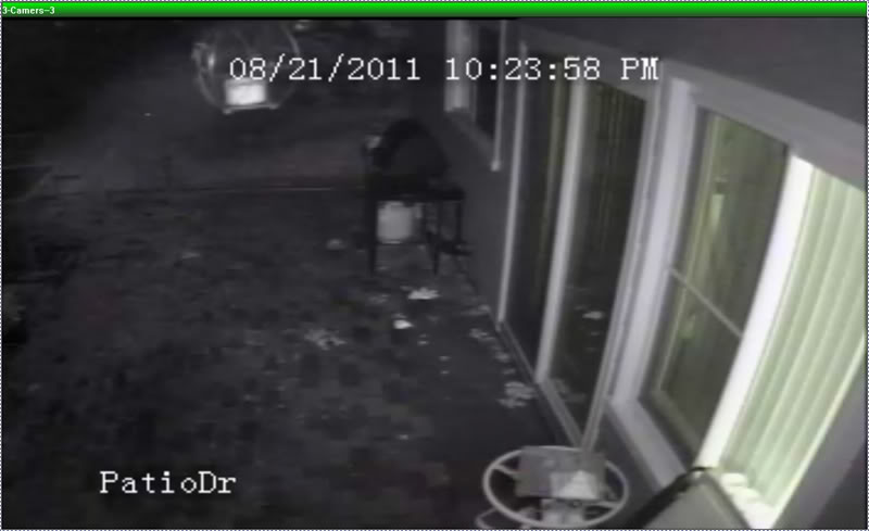

Go3Team 0 Posted September 2, 2011 I don't have any low light color images of my VCM-24VF, I have these that are at night, one with flood lighting, and the other with IR lighting. Mine seems to do ok in low light color scenarios. Edit: Oh, and default factory settings as well. Share this post Link to post Share on other sites
HTElectrical 0 Posted September 2, 2011 That first picture looks more like compression artifacts caused by the DVR trying to process and compress a B&W image as color. I bet if you dial down the saturation on that channel, it clears right up. Ditto if you lock the camera in day mode, I bet it's a lot cleaner. I am using a GV600 capture card, and viewing live video looks the same as the image I posted. I don't know what you mean by the DVR trying to process and compress a B&W image as color. The camera is obviously not switching to B&W mode. The card isn't trying to change it to color??????? Share this post Link to post Share on other sites

HTElectrical 0 Posted September 2, 2011 The first picture looks like it has alot more light than the second picture. I bet if you move the CNB in the same position as your other camera you would get good results. Your still gonna get noise if the area is real dark, no matter how good the camera is. If anything the first picture has less light than the second. Share this post Link to post Share on other sites
HTElectrical 0 Posted September 2, 2011 Lets go back to the original images for this thread Actually there is not much light in the CNB image at all, but there is some right by the camera on the eave ... get that out of the video image and perhaps it will then switch to BW. Zoom it in a little to get past that. I will try that. There is a light to the right of the camera (when facing it) on the same wall, a standard 3 sided porch light. I blocked off the pane on the left side of the light closest to the camera with similar reflective material as used in the rear of the light. I don't have any low light color images of my VCM-24VF, I have these that are at night, one with flood lighting, and the other with IR lighting. Mine seems to do ok in low light color scenarios. Edit: Oh, and default factory settings as well. How bright is your flood lighting? The second image isn't much use, since you are supplementing the light with IR. Share this post Link to post Share on other sites
