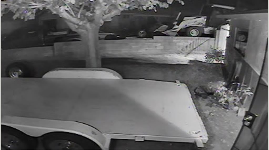

SEANHAWG 1 Posted September 2, 2011 Quote If anything the first picture has less light than the second. If thats true than I agree that the camera is kind of suckin but just like other posters have said, I havent seen a CNB with Monalisa perform that bad with that amount of light. Where are the light sources in the second picture? In the first picture you have a bright garage light on but I dont see any light sources in the 2nd pic other than the ones way across the street. All I know is that the claims of these cameras working in hardly no light at all are just false. Having a clear picture in starlight is also hogwash. Most any camera with such little lighting will have noise. The CNB's dont need much light but they still do need some. Share this post Link to post Share on other sites

HTElectrical 0 Posted September 9, 2011 No mater what I do I CAN NOT get that piece of SH!T to switch to black and white. I finally had to manually switch it and leave it there. How do I tell if this option is available? It is available on the menu, but where do I connect the external photocell? Share this post Link to post Share on other sites

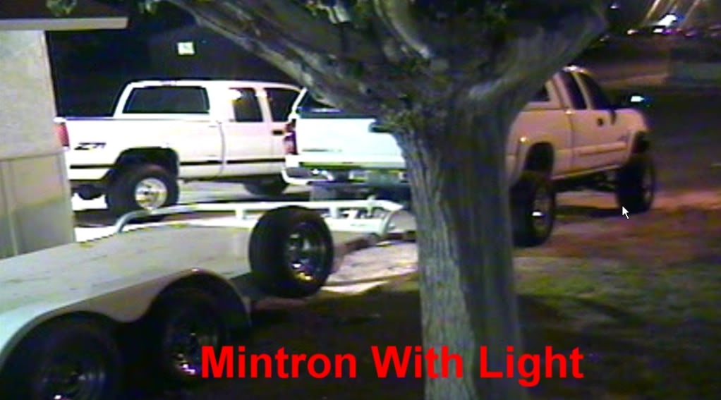

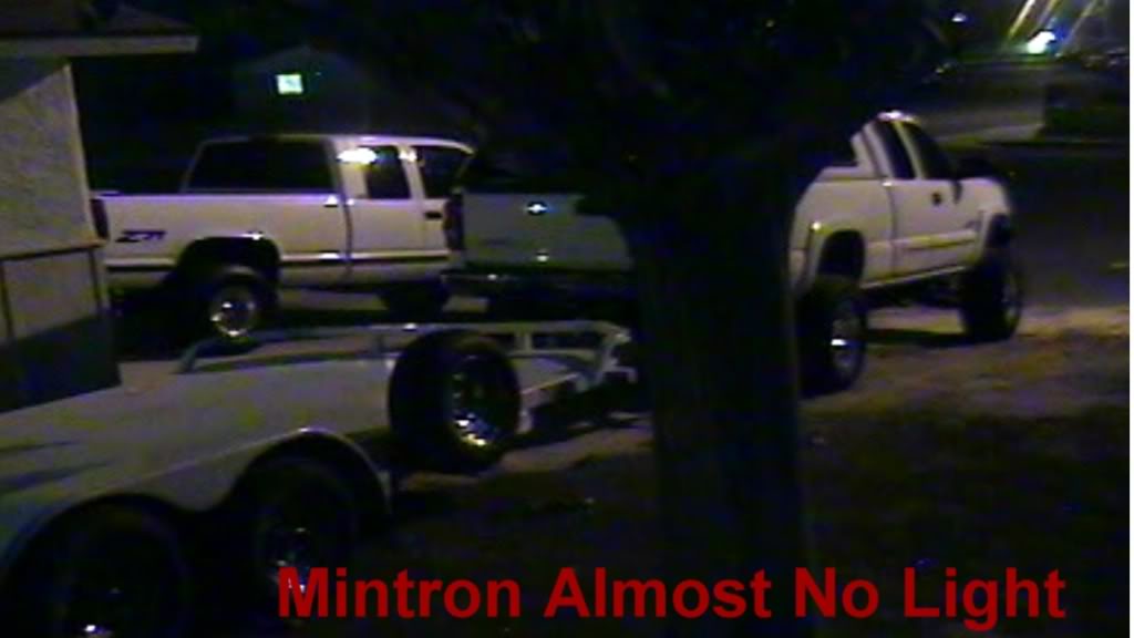

HTElectrical 0 Posted September 9, 2011 The Starlight mode on the Mintron Camera actually works very good, far superior to the CNB, and it stays in color and has a better color image than the CNB has in BW mode!!!!! Share this post Link to post Share on other sites
HTElectrical 0 Posted September 9, 2011 This is with the same lighting as the second pic of the CNB Share this post Link to post Share on other sites

Soundy 1 Posted September 9, 2011 HTElectrical said: This is with the same lighting as the second pic of the CNB Now how about with motion? A number of cameras have a "starlight" mode - usually it's achieved with super-slow shutter speeds that mean extreme motion blur. Share this post Link to post Share on other sites
