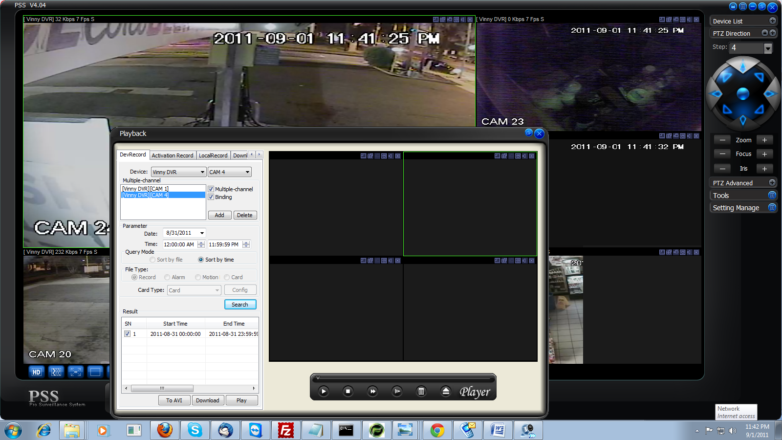

Mnaty 0 Posted September 1, 2011 Having playback issues on pss software. Every time I try to access video playback from the DVR directly on PSS software the control buttons, such as play, stop, fast-forward etc will disappear as soon as I hit play in the search menu to start the feed. Is this normal?...it appears the only way I can get normal control functions on playback from this software is to record locally onto the computer that is running the software. Is this the only way??? If this is the expected way for PSS to work, then can anyone recommend a different remote-client software that may have better management controls for playback. Share this post Link to post Share on other sites

Mnaty 0 Posted September 2, 2011 using the 32LE At start of playback the control bar is available: After searching for video footage the playback is still present: Once “play” of selected footage is pressed then control panel disappears: Thanks for the support note...this same error occurs on two separate installs on different computers. The software was downloaded from Dahua site directly. Share this post Link to post Share on other sites

Mnaty 0 Posted September 2, 2011 Also try running PSS with XP SP3 Compatibility. ok, running in compatibility mode with admin rights fixed the problem with playback controls, but still has other compatibility issues, such as lockup when trying to access device config from pss. I'm going to try some vista emulation and see what happens, then I compare to actual vista and xp installs and post results. At least now the problem is isolated to compatibility and I can move forward with appropriate fixes . Kind REgards Share this post Link to post Share on other sites
