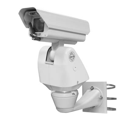

Then out of the corner of my eye, I saw one on top of one of the light posts, way up there, doing a PTZ maneuver in plain sight. This one was mounted on some kind of gimble pivot and could spin and tilt very fast.... It didn't look like the usual teardrop style but one of those big ol weather protected ones that are usually on a fixed mount.
My question for the gurus here is, what is the actual name of the beast and where can I get one?!
Ok it looks like this.....

This one looks descent, but it has a few things I'm not too sure about, like the PTZ is 24V but the cam is 12V... It doesn't say if it has a fan and/or heater, I'm assuming it does since it's 24V?

Hi. this is two products. the camera can be anything you like. which you attach to what is called a PAN / TILT head.
you would be better buying a good PTZ camera

We come across Pan/Tilt heads once in a blue moon but they are usually pretty beat up and i wouldnt even want to sell it to you to be honest because they are so beat up. We do not have any in right now unfortunately. We dont ever come across any big time zoom lenses though but every now and then you can find a big hawg on eBay. You would need a pretty darn big lens to zoom in on a mile away. Atleast 200mm or more, I would assume probably more than 200mm though. For those kind of optics, you are talking some big money. That Ultrak PTZ that we sold you is about the most typical zoom range that you would see on a PTZ, but you still wouldnt get good detail at a mile and plus that ultrak PTZ housing is made only for indoor use. My recommendation if you really want something like that would be to find a good box camera that you can attach a giant zoom lens to and put it on one of those Pan/Tilt heads that you showed pictured. I will have to say though, be prepared to get your wallet ready as I assume that its not gonna be cheap.

doesn't come with the camera as shown in the picture, you put any fixed camera you want on it.
only pans and tilts, get a ptz so you can zoom too.
we only use these things for thermal cameras now, and even then it's extremely rare.
The problem is, he wants to zoom in on a mile. Its hard to do that with a typical PTZ. Most PTZ's are at 122mm max from what I have seen.
Most of the big traffic PTZs I see around the GVRD are Pelco Esprit models:
These can hold a wide range of cameras - IP, megapixel, thermal, analog cams with National Enquirer lenses...
