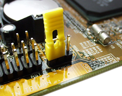

Well I Finally got some firmware that I thought was for my box however obvioulsy it was not. Needless to say It froze during writing and not the whole system is bricked and will not boot. Any Idea how I can possibly get this thing back or where I can get generic software that may work on it?
If you open it up, there may be a "reset" jumper that will clear all settings, that MIGHT get it back running (wouldn't hold my breath though). Would probably look something like this:

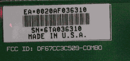

You could try looking for an "FCC ID" number silk-screen or stamped on the mainboard - if you can find that, you should be able to look up the manufacturer at the FCC's website (www.fcc.gov). It will probably look something like this (below the sticker):
Are there any other labels on the outside of the case at all?
Here is a pic of the inside and the only sticker what so ever on the entire thing.
No FCC tag no serial no nothing.
