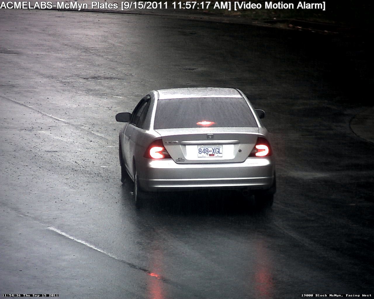

I have an IQ511 (1.3MP) set up to catch plates on my street... it's not the greatest, as the shutter slows right down at night, and the only suitable lens I had for it was a 7-70mm manual-iris beast, which is a standard-def lens so it's not as crisp as it could be. Still, in daylight, it works fairly well...
