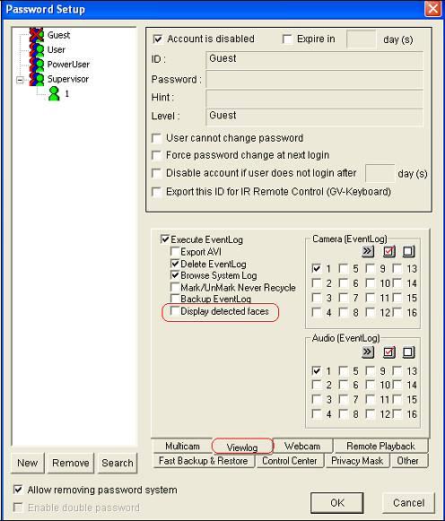

To Enable the Face Mask for an User Account:
1. On the GV-System, click the Configure button, select System Configure, select Password
Setup, and select Local Account Edit. This dialog box appears.
2. Select a Power User, User or Guest account and click the Viewlog tab at the bottom.
3. Clear the selection for Display detected faces to blur human faces when the user wa
recorded events in ViewLog.
4. Click OK.

Why would Geovision put such a restriction on the Supervisior account? Most of my customers want to be able to log in as a supervisor and have full control of the system. This includes being able to fast forward thru video files when necessary! I think they have enough sense to slow the playback to observe something of interest.
Hopefully this option GETS REMOVED in version 8.5.1!!!!!
