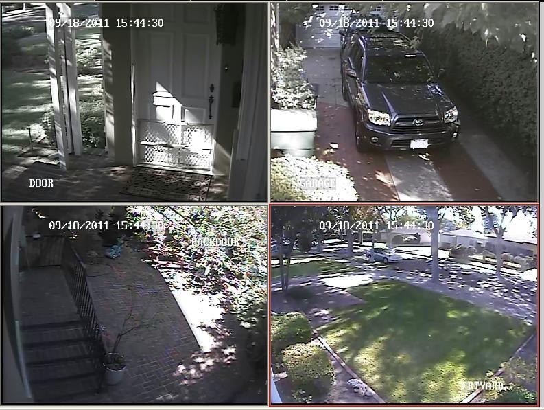

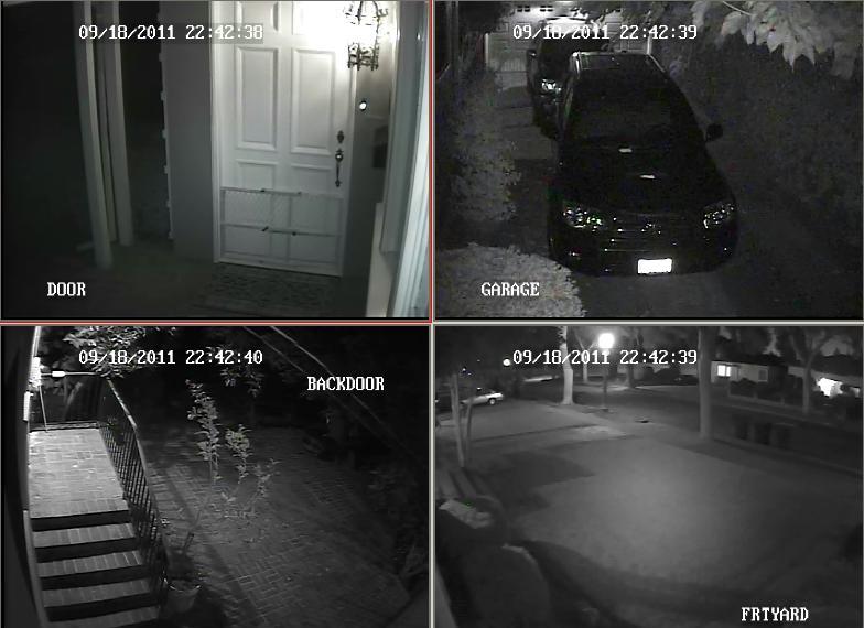

lowpro 0 Posted September 19, 2011 (edited) Hi Guys. First of all, let me say Thank You to all the regular members who contribute to this forum. You guys are awesome! I've learned a lot just by looking around. Thanks! I was hoping to get some feedback from you guys. I currently run a 4 camera Q-See DVR that I bought from Costco 2 years back. Since then I've updated the 4 cameras to CNB cameras. It has made a big difference but I'm sure there is still room for improvement. Front Door & Garage Cams are CNB 550TVL 24? IR LED (can't remember the model) Back Door is CNB WBL-20S 600TVL 12IR LED Monalisa Front Yard is CNB WCM-20VF 600TVL 18IR LED MonaLisa The Q-See dvr records at h.264 D1. It records 24/7 for around 11 days on it's 320gb harddrive. I access it on my iPhone and sometimes on my pc at work. My wife would love to access it at work but she uses a Mac and her cell phone doesn't get any reception inside while at work. So that's a little background on my setup. A few weeks ago we got word from a neighbor that some neighbors up the street had their gps stolen from their vehicle in the middle of the night. Sure enough, those guys had also walked through my block. I was happy to see that I had them on video but I was disappointed in the quality (big shocker, huh?). It just seems that as a result of the economy that we're in, some bad bad people just need to find a way to make a quick buck. Apparently they've been coming in to the nicer areas to see what they can get. Here are the videos. I quickly recorded these videos with my iphone off of the computer screen. I wanted to quickly email the links around to neighbors and never went back to do it export them again. I also gave the police a copy of the videos. Front Yard Cam Garage Cam And for giggles...stock q-see bullet before the change, 9 months ago. So now I think would be a good time for me to upgrade my dvr which I've been wanting to do for a while. The CFO (Wife) recently agreed for the upgrade. So i've been thinking of a 16 ch. Dahua Hybrid dvr (DVR1604HE-T-4H). I really want to try a megapixel camera! It also HAS TO BE mac compatible so that my wife would be able to log in from work. Must work on iphone also.I Camera wise - I would love to swap out the front yard camera for a megapixel camera. The night quality would have to be the same or better than what I already have. Vitek? Geovision? Bullet. I'd start with one and then purchase more. In short, when is the Dahua Hybrid DVR coming to the US? How much is it? How much longer do I have to wait? Thanks guys! I appreciate your help. Edited September 20, 2011 by Guest Share this post Link to post Share on other sites
Birdman Adam 0 Posted September 19, 2011 If you've got the money (don't think about comparing it to analog prices), you will love IP megapixel cameras. Others can suggest what to get for that... The wide shot is useless except for overview, the tighter shot on the car is fairly good. Certainly a better DVR would improve the situation some, but I would possibly play with the placement of your cameras - in particular really honing in on what you need to see. For example, if you need to see the face of someone at that far car in the wide shot, get a camera with a 5-50mm lens and zoom it in, and some tight IR so you can have a good shot. Share this post Link to post Share on other sites
lowpro 0 Posted September 19, 2011 Thanks for the reply, Birdman. Well I was thinking about the Dahua Hybrid because it would allow me to upgrade to current/future technology yet still use some of the cameras that I have. I would love to put into service some ip megapixel cameras. You get 4 IP channels with the Dahua. I don't think that I'd need more than that. Besides it'll start getting pretty expensive for home use. Since I currently have only 4 channels to play with, I felt that I needed to get a wider view with what I had to play with. That's another reason why I'm planning on a 16 channel. It'd be fun to have full coverage of the entire house since I'd have the channels available. I was thinking of using the megapixel cameras for the wider shots and the analog cameras for the zoomed in shots because the analog cameras would cheaper to acquire. The camera is set to 6mm on the driveway shot and 3.8 for the front yard shot. I'll post pics a little later of all 4 cameras together. Share this post Link to post Share on other sites
shockwave199 0 Posted September 19, 2011 I don't claim to know much- i'm just a diy'r too. But unless you want to upgrade to 16 channels, I'm not sold on the fact that your dvr is the weakest link from those vids. The first vid- your front yard shot; you have what's been touted as a very good camera but it's way too wide to give you anything meaningful at that car all the way out there. And at that camera position, you have a serious glare problem coming from the street light or lamp post. That's fighting your image quality big time right there. I would install two cameras- one tight to the car area out there and one getting that whole side by your cans, but from the opposite direction to avoid that light post. In the driveway shot, it's better and you could have a possible identity shot in a couple frames if needed. Not great, but there's something there. But here again, your IR's or something is very washed out and not providing useful illumination. I have a feeling you may have your brightness/contrast set up poorly for your night pictures. Tweak the picture settings and get a good picture for daytime sure, but make certain you get the best picture you can for nightime too- even more so. Have a friend go out there to be the bad guy and really fine tune your picture settings for night views. Doing a vid with a camera pointed at a monitor screen for demonstration doesn't help that much either. Point being- I'm not sold your dvr is the weakest link in your current setup. Better camera placement/zoom and better picture tweaking per channel in the dvr would certainly improve things, I believe. If it's a 16 channel upgrade- great. Get a good one. I don't mean to say an upgrade isn't worth it. But you'll still face these problems no matter what dvr you have in line- having spent possibly serious bucks. I'd tweak placement and or zoom settings and picture settings for each camera first and see if that doesn't help your dvr help YOU. Good luck. Dan Share this post Link to post Share on other sites

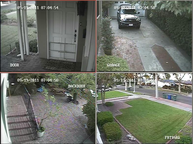

lowpro 0 Posted September 19, 2011 Thanks Dan. I really appreciate the feedback. Here are some pics from earlier today. This evening I went out to clean the lens on the front yard cam. Must have smeared some spider parts on it last night. 3:45pm 10:45pm I guess you could be right. From the times that I've played with the settings on the dvr for the cameras, it never really looked all that great to me. Either the day looked good and the night time image was crap or vice versa. So I just left them pretty much at default. I must say that that car that you see in the first video (with the 2 guys), is my neighbors car. I don't really care too much about that. If it looks great then great, if the camera doesn't pick it up, oh well. It's more for an overall shot. I can also kind of see who is coming up the street. Like I mentioned before, I currently only have 4 channels to play with, so I decided to go with the wider views. With 16 channels I plan on adding another camera at the oposite end of the house which would be facing north along the front yard. They'll form an X of sorts. I'll see about converting the vids. Share this post Link to post Share on other sites
shockwave199 0 Posted September 19, 2011 Oh- gotcha on the neighbors car. And yeah, it's a really good idea to keep the cameras clean. Rain is another big one. I always clean my camera glass after rain. Clean them all- even the day pic of the driveway looks cloudy. When you upgrade, I suggest you do better camera placements too. From your day pics, the doors need better coverage. A side note- it's a really good idea to not put cans out the night before. You saw those guys go in one right? Garbage cans are a magnet for criminal mischief too- even more so the plastic/bottle recycle cans. Put them out in the morning if possible- always a better idea. Best of luck upgrading! No harm in that, except maybe the bank account! But when I needed to spend more money on my system I always asked myself this question- can I afford not to? Share this post Link to post Share on other sites

rory 0 Posted September 21, 2011 Just upgraded a 4 Channel QSee (not sure of the model but it is tiny) to an 8 Channel VGA Dahua DVR (aka Qvis Zeus) and client is happy. Those QSee cameras are pretty lame though, I think they are getting like 10' of IR outside and its 1/4" BTW your images look okay, seen much much worse. Need to point them at the areas the people come into though, right now they are pointing at their backs with the garage and front door. If you want to leave the garage camera, just get an old or cheap IR camera and put that on the opposite side to give that side more light. Share this post Link to post Share on other sites
lowpro 0 Posted September 21, 2011 Just upgraded a 4 Channel QSee (not sure of the model but it is tiny) to an 8 Channel VGA Dahua DVR (aka Qvis Zeus) and client is happy. Those QSee cameras are pretty lame though, I think they are getting like 10' of IR outside and its 1/4" BTW your images look okay, seen much much worse. Need to point them at the areas the people come into though, right now they are pointing at their backs with the garage and front door. If you want to leave the garage camera, just get an old or cheap IR camera and put that on the opposite side to give that side more light. Yay, I was waiting for Rory to reply! " title="Applause" /> I'm sure I'd be more than happy to get a Apollo Pro dvr but I can't help but think that there is something better out there. In this case, megapixel cameras. So I was really holding out to find something good! Camera location is two fold. They currently live where they are because..1) was limited to only 4 cameras 2) I'm renting this house, didn't want to make anything too permanent. I guess I didn't want anything to be too big or flashy. I guess I'll have to look at a computer option...hmmm... Share this post Link to post Share on other sites
