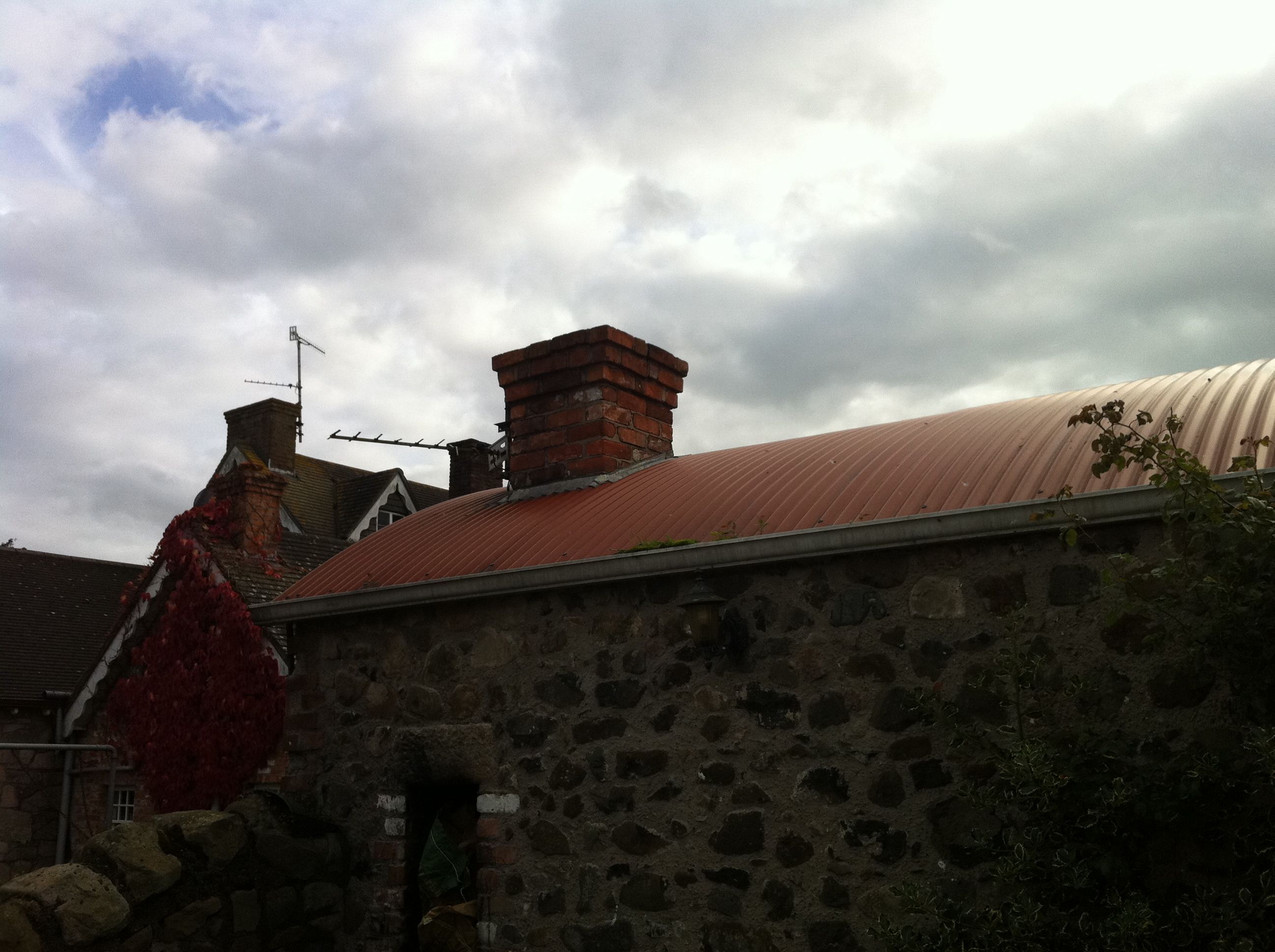

jdowning 0 Posted September 21, 2011 Hi all! Thanks for your replies! Sorry - I phrased it wrong, I didn't want a camera which I can zoom in remotely - just one that can 'zoom' in a lot! Sorry, I'm not good with the technical language. For example - I can't get a camera to a physical location close to this gate so I'm going to need to get a camera (I'd prefer to do a body+housing camera, not the built in ones) which can zoom right up this yard and get a face if possible. This is the picture of the chimney I'd mount the camera on (around 3 metres from ground). And around 20 metres up the yard, here is the gate: http://img847.imageshack.us/img847/7876/photo20092011164434.jpg Gate width is around 3 metres. Roughly - what type of lens would I need for this? Thanks so much for all your help, appreciate it. Share this post Link to post Share on other sites

bike_rider 0 Posted September 21, 2011 There are many cctv lens calculators on the web. You need to know the sensor size of the camera, the distance from the camera to the target and how wide of an area (field of view) you want to cover. One quick calculation says a 1/3" sensor, 3 meters off the ground, target distance of 20 meters, view area 4 meter = a lens focal length of 24mm. Share this post Link to post Share on other sites
jdowning 0 Posted September 21, 2011 Thats fine, get the Zoom lens dome and just set it fixed to your FOV. But don't you have to put an extra wire to control that through to whatever location? There are many cctv lens calculators on the web. You need to know the sensor size of the camera, the distance from the camera to the target and how wide of an area (field of view) you want to cover. One quick calculation says a 1/3" sensor, 3 meters off the ground, target distance of 20 meters, view area 4 meter = a lens focal length of 24mm. So would a 24mm lens roughly get a good picture of that gate without any bad image quality? Also - can a CAT5 cable powered via baluns provide power for a housing+body camera? Thanks all! Share this post Link to post Share on other sites

bike_rider 0 Posted September 21, 2011 If you plan to just monitor the gate, then you are looking for a lens that you set the zoom on once. This would not need to be a lens that would allow you to zoom in and out, if I understand your need correctly. 24mm will get you the right field of view. Good/bad camera is a whole other issue. Things to think about - how is the lighting at the gate? Does the sun back light the entrance significantly early or late in the day? Are you looking to see what is happening, read license plates and/or identify faces? Share this post Link to post Share on other sites
jdowning 0 Posted September 21, 2011 If you plan to just monitor the gate, then you are looking for a lens that you set the zoom on once. This would not need to be a lens that would allow you to zoom in and out, if I understand your need correctly. 24mm will get you the right field of view. Good/bad camera is a whole other issue. Things to think about - how is the lighting at the gate? Does the sun back light the entrance significantly early or late in the day? Are you looking to see what is happening, read license plates and/or identify faces? Hi all - yep! Just a one time setup and that should be it hopefully. It's the one main point of entry to my yard so I'll want to be able to identify faces. I plan to have 4-5 other cameras in the yard but would you recommend one for faces or one for wide angle/number plates? Lighting isn't a problem - I don't really want infrared. As from what I've seen, it just blurs out peoples faces. I can put in a few extra motion sensor lights in the yard. Do these type of cameras need a lot of light? Thanks for all your help guys - don't know what I'd do without you! Jack Share this post Link to post Share on other sites

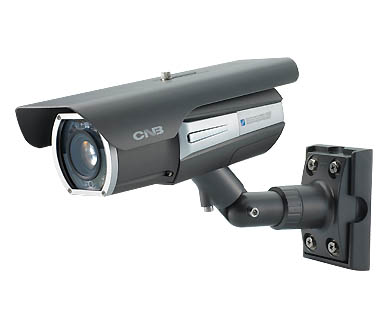

tomcctv 189 Posted September 21, 2011 this will do everything you need. even zoom in to gate as cars pass for a plate capture and then zoom back out again. the CNB full housing camera (on offer at the moment) http://www.videcon.co.uk/product_details.php?StockID=1290&l1=3&l2=41 Share this post Link to post Share on other sites
rory 0 Posted September 21, 2011 Forgot about CNB.. http://www.cnbusa.com/en/html/product/product.php?seqx_prod=1191 Share this post Link to post Share on other sites
jdowning 0 Posted September 21, 2011 Forgot about CNB..http://www.cnbusa.com/en/html/product/product.php?seqx_prod=1191 Thanks tom! Know where i can buy that? rory - know where I can get CNB in UK? i heard 'monolisa' chipsets are good. Share this post Link to post Share on other sites
tomcctv 189 Posted September 21, 2011 rory - know where I can get CNB in UK? i heard 'monolisa' chipsets are good hi. the VCM-24VF has never been sold in the uk. you can only order it direct. Share this post Link to post Share on other sites
