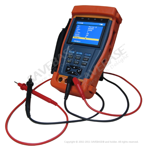

MIne is a very common one 3.5" screen Cat5 tester, multimeter, colour bar generator and PTZ analyzer, 12v DC supply and bump resistant jacket. It apparently also has audio tester but I've never used that. It all comes in a carry bag which is padded and all the leads are there too with charger.
Very useful for setting up on screen menu settings, varifocal lenses and camera positioning.
I just wish the screen was a little larger but overal, it has saved me heaps of time and is one tool I couldn't do without. I paid around £200. with fast delivery over ebay. Best £200 I ever spent.
There is a cheaper version without the multimeter and some other functions.

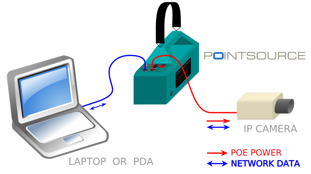

How do you guys use to position and focus IP cameras that don't have a local video ouput?
Netbook, WiFi router, Veracity PinPoint
I had already thought of using a wireless netbook but it's a bit difficult up a ladder isn't it? I;ll have to change my mobile phone then. I was looking at this item
No more so than a 10"-ish LCD monitor. Netbooks tend to be very light. You could possibly go with a tablet PC as well (keeping in mind that most cameras will require the use of Windows at some point).
  Quote
Same idea as the PinPoint, which inserts in a PoE line and "splits off" a port for the laptop... except this includes a battery PoE supply. Neat idea, but I don't really get the point, since you'll have to power the camera for regular operation anyway, at some point. Might be handy in rare circumstances where you'll need to set the camera up and connect it without power and not be able to return to it after it's powered...
WiFi is really the most convenient if you're doing multiple cameras - just a basic, cheap N router, plug on of the LAN ports into your camera network, disable its DHCP server if necessary... move around freely to all the cameras whether they're PoE or direct powered. If you have a camera that doesn't require ActiveX or a Windows-based utility, you COULD even set it up from a smart phone or non-PC tablet (iPad, Android, etc.)
