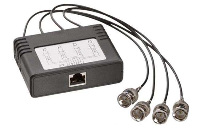

Soundy 1 Posted September 24, 2011 (edited) Can I buy 2 x these: Can I put one of these in the garage - plug baluns into the coaxial inputs on these and have 2 x CAT5e going to the office where the DVR will be located. Can I put one of these where near the car park is - plug baluns into the coaxial inputs and have 2 x CAT5e going to the office where the DVR is located. I want to power everything by CAT5e aswell so I would have a power box in each of these locations. You've nailed it! At the DVR end, I will have 4 CAT5 cables which are carrying 4 video signals each. How do I plug these into the DVR? Do I need some type of 'receiver' or can I just strip the wire back and use the pair which the certain video signal is on. Baluns are "tranceivers", which means they can both transmit and receive: you can use four of those same units above at the DVR end - you just need short coax "jumpers" to connect the baluns to the DVR... or use something like this: http://gemelec.com/index.php?page=shop.product_details&flypage=shop.flypage&product_id=243&category_id=41&manufacturer_id=0&option=com_virtuemart&Itemid=1 Edited September 24, 2011 by Guest Share this post Link to post Share on other sites
jdowning 0 Posted September 24, 2011 Can I buy 2 x these: Can I put one of these in the garage - plug baluns into the coaxial inputs on these and have 2 x CAT5e going to the office where the DVR will be located. Can I put one of these where near the car park is - plug baluns into the coaxial inputs and have 2 x CAT5e going to the office where the DVR is located. I want to power everything by CAT5e aswell so I would have a power box in each of these locations. You've nailed it! At the DVR end, I will have 4 CAT5 cables which are carrying 4 video signals each. How do I plug these into the DVR? Do I need some type of 'receiver' or can I just strip the wire back and use the pair which the certain video signal is on. Baluns are "tranceivers", which means they can both transmit and receive: you can use four of those same units above at the DVR end - you just need short coax "jumpers" to connect the baluns to the DVR... or use something like this: http://gemelec.com/index.php?page=shop.product_details&flypage=shop.flypage&product_id=243&category_id=41&manufacturer_id=0&option=com_virtuemart&Itemid=1 This is great! Thanks so much for your help. So you're saying I don't need a special receiver at the DVR end and I can just plug the individual CAT5 pairs into a balun and straight into a DVR? Thanks so much for your help Share this post Link to post Share on other sites
Soundy 1 Posted September 24, 2011 So you're saying I don't need a special receiver at the DVR end and I can just plug the individual CAT5 pairs into a balun and straight into a DVR? That is correct. Passive baluns work the same on both ends of the wire. Share this post Link to post Share on other sites

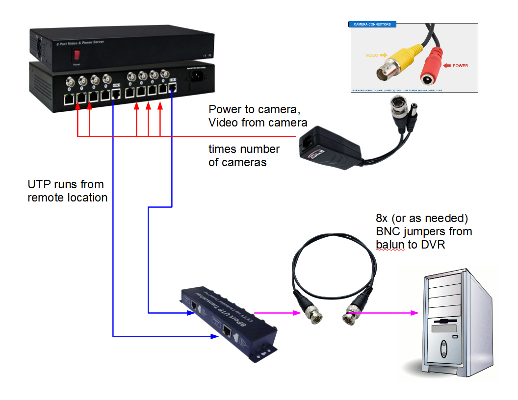

jdowning 0 Posted September 28, 2011 Thanks so much Soundy - I can't seem to find any of them video servers in the UK so I'll probably need to use a separate power box + transceiver. By the way - for housed cameras with a body inside them... can I power them by CAT5? How does the power work for these? Do I need 2 separate power cables? For example - this camera: http://www.onlinesecurityproducts.co.uk/genie-body-cameras/genie-cctv-gsdnr-5358dv-daynight-camera-with-sdnr-.html With this housing: http://www.xenexsecurity.co.uk/product/id/177203 Share this post Link to post Share on other sites
Soundy 1 Posted September 28, 2011 With that, you could either split the pairs to the camera and heater connections, or jumper them (say, connect incoming wires into the heater terminals, then short wires from there to the camera). According to the specs, the heater only draws a max of 600mA, and the camera, 260mA @ 12V, so you're well under 1A there - as long as the runs aren't too long, you should be fine. I'd probably use three pairs for power and split one of them off to the camera and two to the heater. The VPS units shown use the orange pair for video (assume T568B - green pair for T568A), with green/white, blue, and blue/white for power ground, and green, brown/white and brown for +12V... so the brown pair could go to +12 on the heater, blue pair to ground on the heater, green to +12V on the camera, and green/white to power ground on the camera. For example, that is... Share this post Link to post Share on other sites
