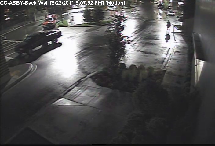

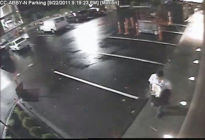

These are VCM-24VFs outside in direct weather (mounted to a brick wall face) with only the parking lot lighting:

Thanks for the pics and samples btw.
