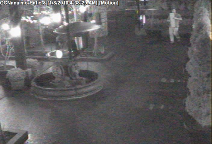

Here are a couple shots from one of my jobs. Lights visible on the patio are 60W bulbs in hurricane shells:

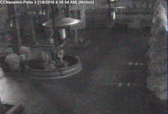

In this one, the patio lights are off - there's a little filtered light coming through the dining room blinds to the right, and from a street light a couple hundred feet away to the left:
