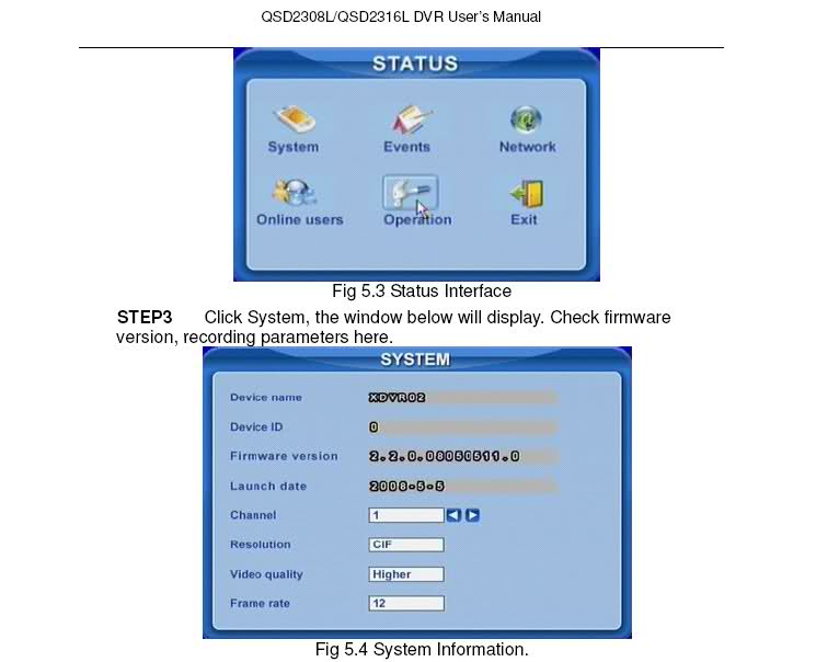

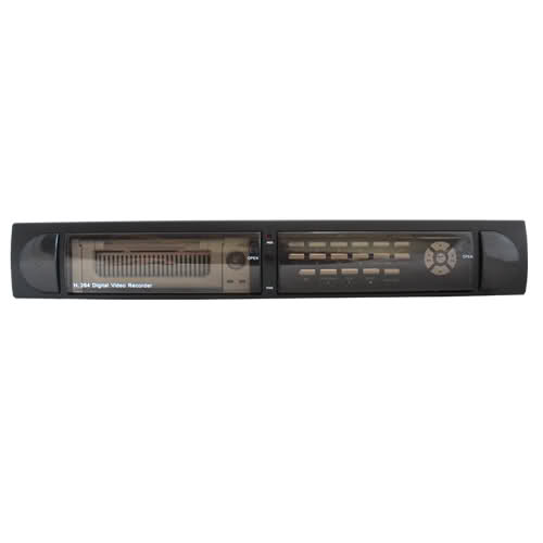

CCT3V 0 Posted October 6, 2011 I purchased a Standalone 16 Channel DVR Unit for Home use and was trying to do a Firmware Update and since the Unit isn't actually branded with a Label on the front i.e. (Q-See, Nightowl etc.) I checked the System Information and it states the following: Device Type: DVR16B-57AG Software Version: V2.3-V100806-REV4 One the actual shipping Box it says the unit is a Model DVR6016 but when I did a Google Search for Device Type "DVR16B-57AG" it links to a Q-See Page so now the question is good or bad Idea to try flashing that Firmware on this Unit? Here is what the Unit looks like: My Current Firmware Screenshot Q-See Firmware Screenshot Thank you for any assistance Share this post Link to post Share on other sites

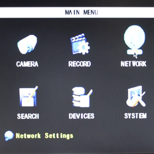

cableguy187 0 Posted December 13, 2011 I successfully updated my firmware following the posts above. The only thing I can not get working is the email portion... Has anyone got the email .jpg to work on this unit? Share this post Link to post Share on other sites
joseph.chen0312 0 Posted December 13, 2011 I successfully updated my firmware following the posts above. The only thing I can not get working is the email portion... Has anyone got the email .jpg to work on this unit? in main manue you have default the even and fill-in your account to trigger. Share this post Link to post Share on other sites
cableguy187 0 Posted December 13, 2011 I successfully updated my firmware following the posts above. The only thing I can not get working is the email portion... Has anyone got the email .jpg to work on this unit? in main manue you have default the even and fill-in your account to trigger. Yeah, I filled out the email section.. The DVR will not send email? Strange thing, i woke up to a video loss email at 3:30am. I swapped a camera to another channel at about 9:30pm last night. The email seems to be broken.. Share this post Link to post Share on other sites
tomcctv 190 Posted December 13, 2011 hi did your system send email before the firmware ??? Share this post Link to post Share on other sites
rory 0 Posted December 13, 2011 Are you using your ISP's SMTP server? Alot of ISPs block port 25 and then you would need to put their server in the settings. Share this post Link to post Share on other sites
cableguy187 0 Posted December 14, 2011 hi did your system send email before the firmware ??? No, not at all.. After the firmware update, I received a couple of video loss emails but no motion snapshots. Share this post Link to post Share on other sites
cableguy187 0 Posted December 14, 2011 Are you using your ISP's SMTP server?Alot of ISPs block port 25 and then you would need to put their server in the settings. I run my own mail server- static IP and port 25 is not blocked.. I have tried my ISP email and my own hosted email- same result, no emails being sent. Share this post Link to post Share on other sites
cableguy187 0 Posted December 14, 2011 Ok, made some progress... I was using my ISP's email server in the DVR.. I switched to my own hosted server and started to get some emails thru. I found that you need to enable the 'schedule' in recording type to get the motion alarm to send an email. Share this post Link to post Share on other sites
