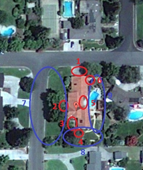

I took an aerial and marked areas in red that I would want close up cameras and those in blue to give a wide angle shot to see what is going on. I have a need for 9 cameras at this point so I am guessing a 16 camera DVR just to cover future additions. Looks like I'll look for a Dahua made DVR though I have no idea on specific model.
No idea on cameras at this point though it would be nice to have location 7 covered with a high resolution camera that could be used to get some details out further away.
1 = driveway (cars kept in garage)
2 = front door
3 = side courtyard
4 = side gate
5 = back covered patio
6 = side gate
7 = front yard and street
8 = side yard
9 = back yard

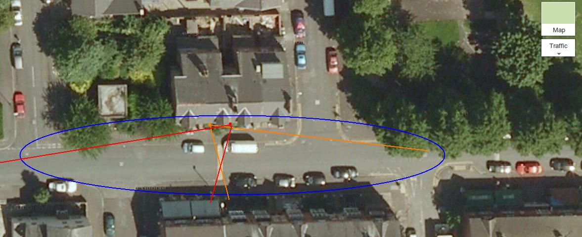

unless you can find a camera with a 180* lens you are going to struggle to cover each blue area with one cam.
i had the same problem with the road at the front of my house. the blue circle is what i want to cover but i have to use two cameras. one camera is orange, one is red. they overlap slightly to stop blind spots.
