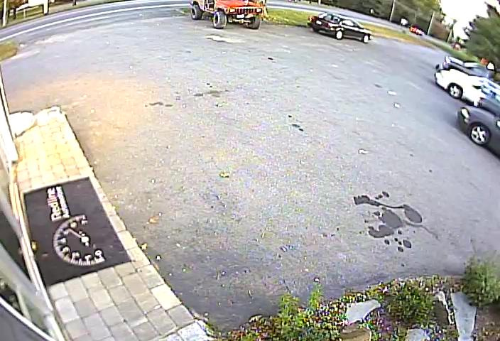

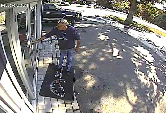

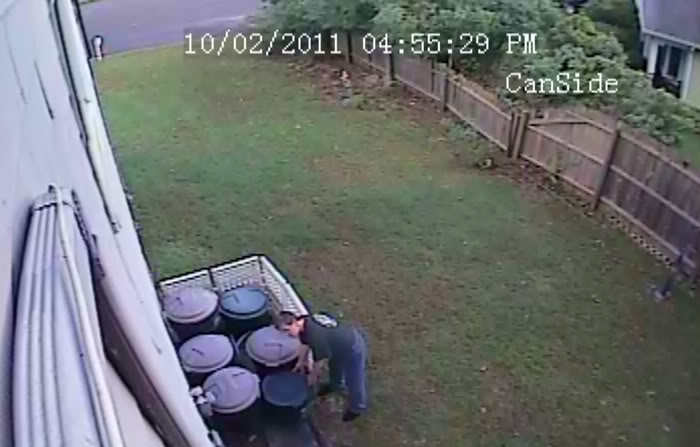

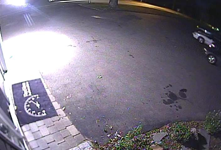

Tom12345 0 Posted October 11, 2011 i use these cam all the time...you gotta play with the settings or something...i have installed about 25 of them...and the dvr line and smart viewer software rocks. it is easy for the customer to use and figure out. plus to recorded h.264 quality is top notch for analogue. they even work with net i veier software which helps you to integrate analogue and ip... Share this post Link to post Share on other sites

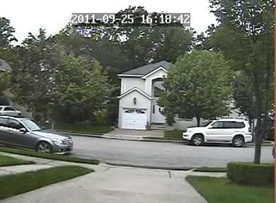

nDAlk90 0 Posted October 11, 2011 The pictures you provided show a lot of blur. This camera seems like a poor choice for a camera as I have seen cheaper cams perform better. i use these cam all the time...you gotta play with the settings or something... Share this post Link to post Share on other sites
Tom12345 0 Posted October 11, 2011 The pictures you provided show a lot of blur. This camera seems like a poor choice for a camera as I have seen cheaper cams perform better. i use these cam all the time...you gotta play with the settings or something... blah blah blah....put up some pics then of your cheap cameras better pics Share this post Link to post Share on other sites

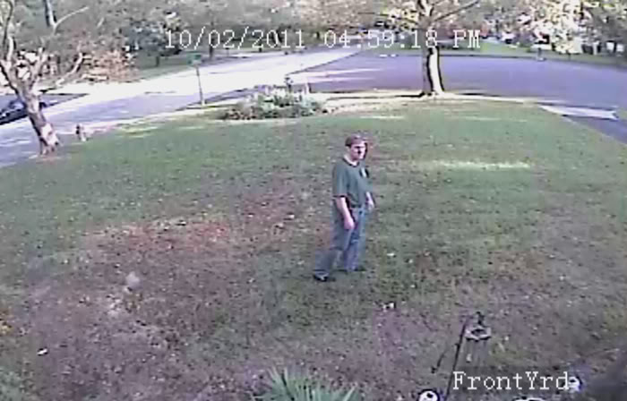

nDAlk90 0 Posted October 11, 2011 blah blah blah....put up some pics then of your cheap cameras better pics Here is one from a CIF dvr. Share this post Link to post Share on other sites
shockwave199 0 Posted October 11, 2011 What dimentions is that picture? Share this post Link to post Share on other sites
nDAlk90 0 Posted October 11, 2011 (edited) It was cropped from a 4 camera view which is why its so small. What dimentions is that picture? Edited October 11, 2011 by Guest Share this post Link to post Share on other sites
ak357 0 Posted October 11, 2011 What dimensions is that picture? Place mouse on pix, right button click----properties Share this post Link to post Share on other sites
ak357 0 Posted October 11, 2011 It was cropped from a 4 camera view which is why its so small. It is not "so small" its about right size for CIF single cam view Share this post Link to post Share on other sites
shockwave199 0 Posted October 11, 2011 It was cropped from a 4 camera view which is why its so small. Can you not take a single snapshot of one camera channel? Share this post Link to post Share on other sites
vmgtlexi 0 Posted October 11, 2011 i use these cam all the time...you gotta play with the settings or something. Tom - With any amount of contrast or dynamic colors/lights, mine look worse than yours; and yours don't look all that great (just sayin'); they look "acceptable", but certainly not "premium-priced-Samsung". Also, their tech support has fallen off a cliff for my concerns. I am not going to pursue any factory adjustments anyway, unless of course something else goes wrong under warranty. But, I am also not buying another Samsung, and I do have 1 more camera that needs replacing. Share this post Link to post Share on other sites
shockwave199 0 Posted October 11, 2011 (edited) I'm just curious because a smaller picture seems to help out the sharpness of a shot. I scale my shots down from something like 1120x..., which is what the default size is in my remote software, to 700x when I take a snapshot from video. If it's gonna look better at 400x, well heck- I'll post even smaller shots. Edited October 11, 2011 by Guest Share this post Link to post Share on other sites
Tom12345 0 Posted October 11, 2011 i use these cam all the time...you gotta play with the settings or something. Tom - With any amount of contrast or dynamic colors/lights, mine look worse than yours; and yours don't look all that great (just sayin'); they look "acceptable", but certainly not "premium-priced-Samsung". Also, their tech support has fallen off a cliff for my concerns. I am not going to pursue any factory adjustments anyway, unless of course something else goes wrong under warranty. But, I am also not buying another Samsung, and I do have 1 more camera that needs replacing. what are you comparing your images to refrence good or bad (show an image you like). daytime shots with high contrast scenes and lots of uneven lighting makes anything look crappy. you can't have a camera that has perfect pictures in all conditions. it usually ends up getting set up for a particular circumstance. the samsungs seem to have been best all around (balancing good scenes and bad)... i just put some cnb's in and in high contrast they look the same(acceptable but not super)...mabye try to put the cam in black and white mode and see if the dynamic range evens out if thats what your going for. i am stuck thinking this h.264 codec and compression makes any of these cameras look poor. mabye its the bit rate....but plug the cam directly into a crt screen and they look awesome... I'll post some pics in a few days of a 3mp samsung i am installing...we'll see how that does.. Share this post Link to post Share on other sites
Tom12345 0 Posted October 11, 2011 i use these cam all the time...you gotta play with the settings or something. Tom - With any amount of contrast or dynamic colors/lights, mine look worse than yours; and yours don't look all that great (just sayin'); they look "acceptable", but certainly not "premium-priced-Samsung". Also, their tech support has fallen off a cliff for my concerns. I am not going to pursue any factory adjustments anyway, unless of course something else goes wrong under warranty. But, I am also not buying another Samsung, and I do have 1 more camera that needs replacing. i will mention with those sco's at full wide focal length they have an issue with blur on the outer edges of the frame...i'm still looking for a great bullet for my low budget installs, but am going purely megapixel nowadays anyhow...f...k it. they wanna play, they gotta pay. (CSI show enchance here we come)))) lol Share this post Link to post Share on other sites

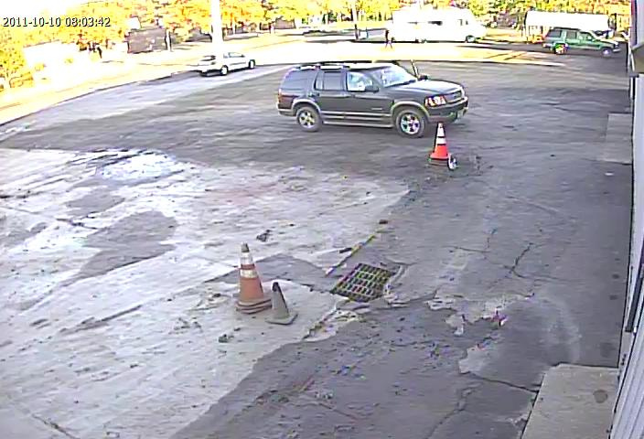

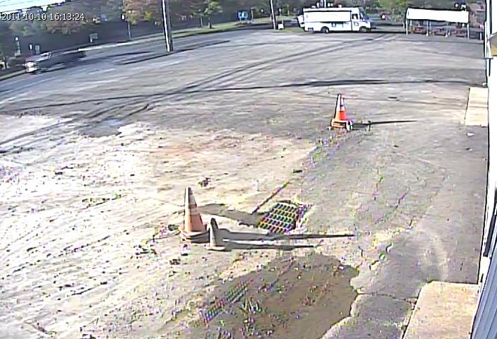

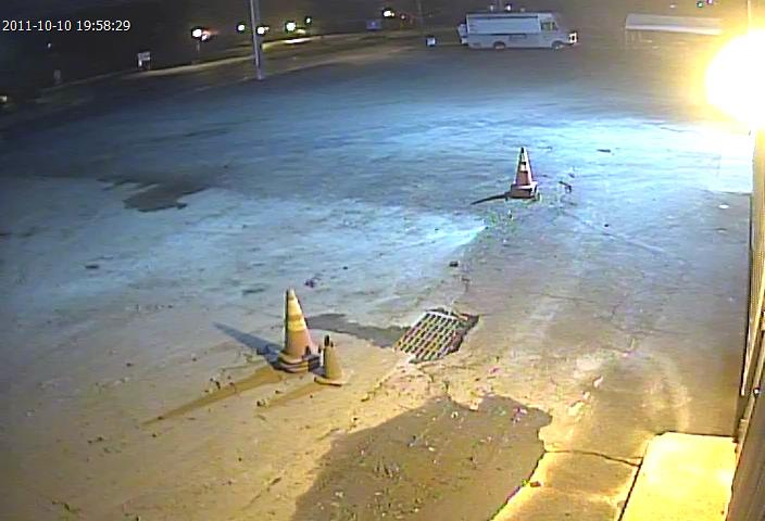

Tom12345 0 Posted October 11, 2011 [attachment=2]menew.png[/attachment][attachment=0]ktceg.png[/attachment] [attachment=1]Old Extreme CCTV EX-82 PITCH DARK WIDE 1.png[/attachment] the 8:39 time image of the ktc looks good, but again it's all about even lighting. rory do you have a d1 capture of them...kinda small. obviously the ex 82 looks great...it better for the dough they want for it Share this post Link to post Share on other sites
rory 0 Posted October 11, 2011 i'll check, meanwhile click on the image to make it larger. these were all captured over the network, so there is some loss of quality. Share this post Link to post Share on other sites
