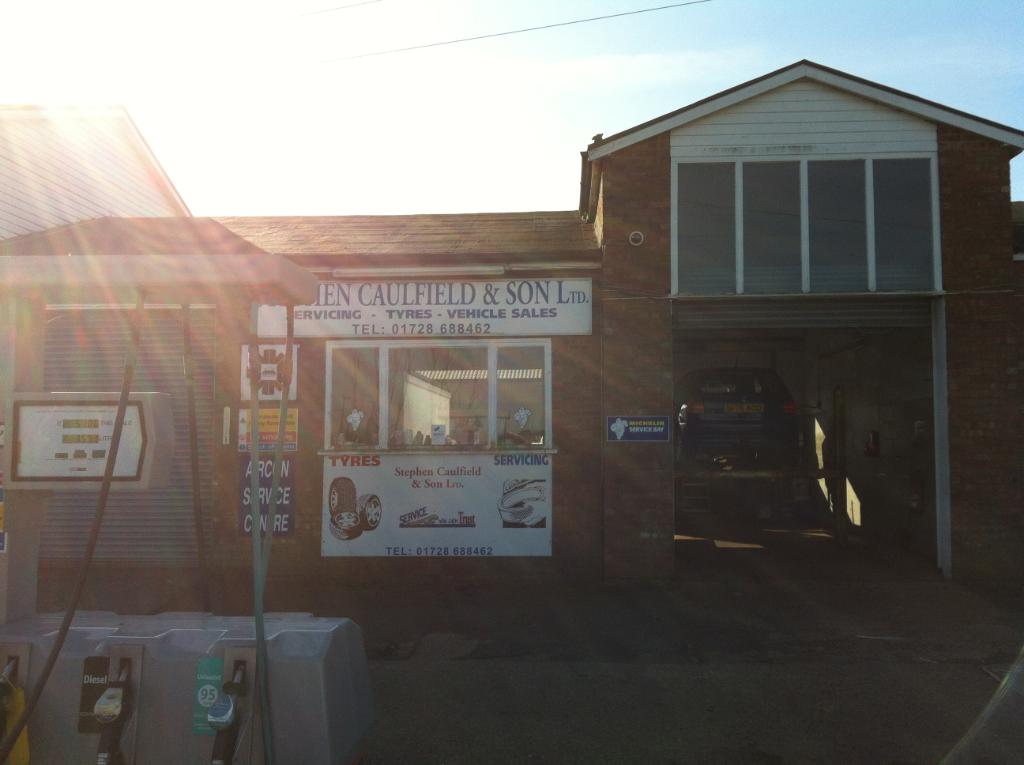

Sorry for the long delay in getting back to you. I was at the garage this morning and saw the camera doing what they had been complaining about. What it appears to be is the reflection coming from a car when parked at the pump. The sun rises behind the building and goes from one side to the other side always behind the camera, so I do not know how I can resolve this? it appears no matter where i put the camera the sun will always be behind it and will at points in the day, reflect of cars.
Would putting in a different camera help? One that is not a dome?
Here are some pictures of the garage etc to see if this helps you get a better picture of my problems.

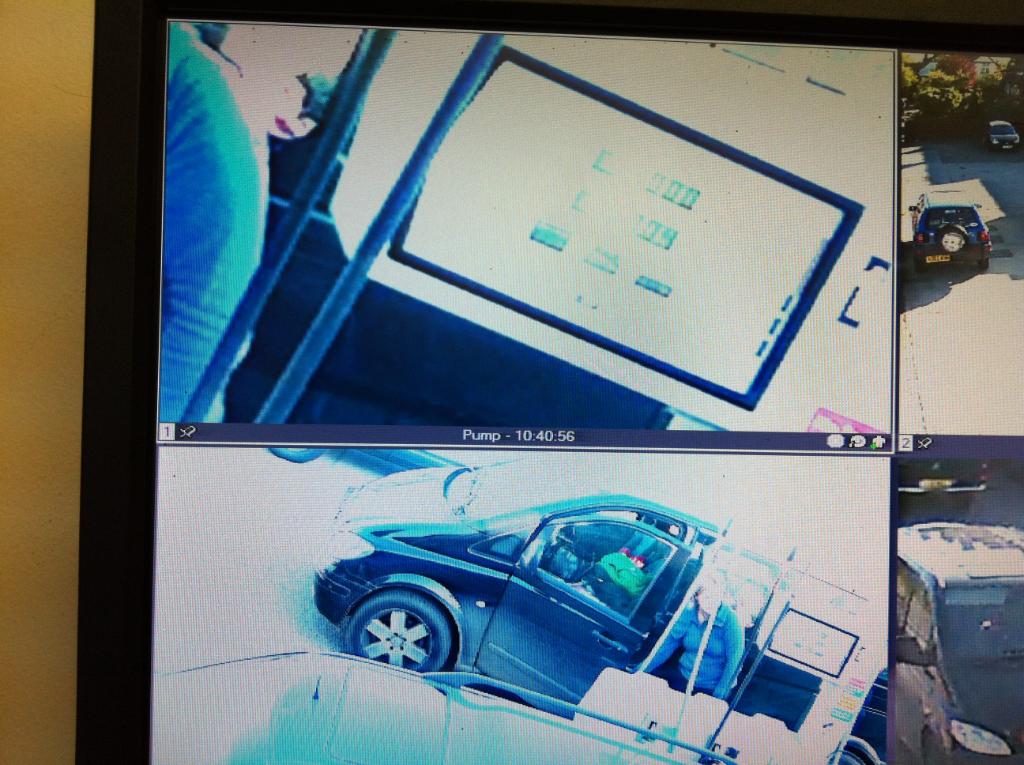

This is a screen shot of the monitor, you can see the top left portion is white, due to the people carrier parked the other side of the pump.

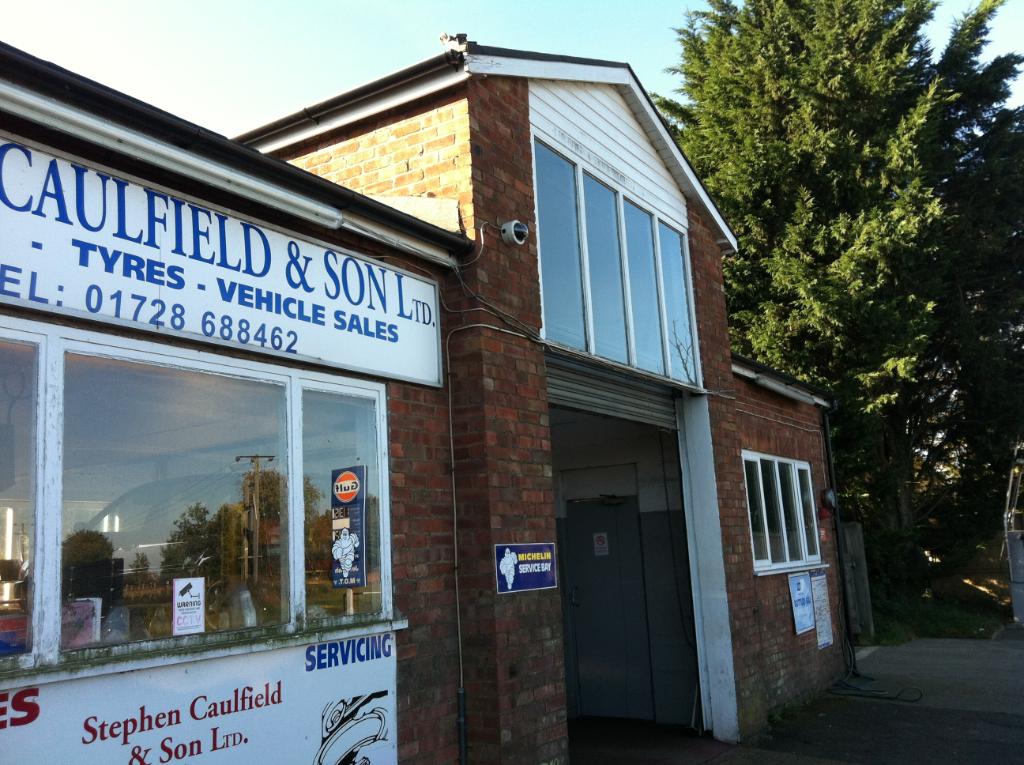

This is where teh camera is currently positioned.
Here you can see where the sun is and through the day it will go from left to right of that pic

Ach, now the first two pics are loading... okay, when you say the sun goes left to right of the pic... do you mean second pic, or third pic?
From the first pic, it looks like the problem is just the sun reflecting on the glass on the front of the pump... unfortunately there's not a lot you can do about that. Dome vs. other type of camera has nothing to do with that. Moving the camera higher or lower to get a different angle would be the best bet.

ok, pic 3, the one looking direct at the Garage, the sun rises from the left and sets in the right. The sun does not go directly onto the camera or the pumps, the problem is with it reflecting off a car when it stops to fill up.
Got it. Yeah, aside from maybe adding a polarizing filter to the lens (which would cause all kinds of other issues, even IF you could find one that fits it), there's not much you can do about reflections off cars. Of course, as the height of the sun changes through the seasons, the angle of car glass that causes a reflection will change too. Only other thing would be to put a huge three-story-tall wall up behind the building to block the sun...
