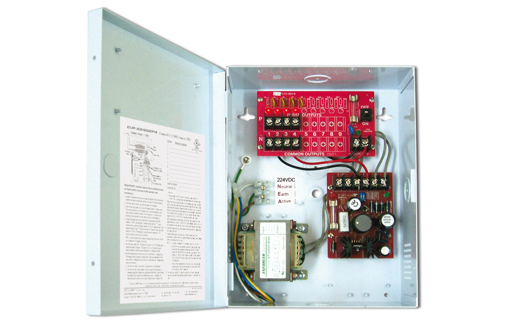

not sure of the model. its a 13.8V battery backed up 3AMP psu in a case that goes on the wall like an alarm base station. it has battery and output fuses that light up a 'fault' led when blown
Similar to this?
If you look up the current ratings on each of your cameras and sensors, then add them up, that will tell you the maximum current requirement... I'd guess it comes in well under 3A, which means you should be fine running everything off the one power can. Just make sure each device has its own fused output.

a bit similar yes.baisically (sorry i forgot to mention) i am not sure if the output is 1A or 3A. it says one thing on the pcb and another on the sticker inside :/

It's not CRITICAL for each device to have its own fuse... the fuses are mainly there to protect the wiring itself.
From what I can find on those shock sensors (if they're the ones I think they are), they draw about 120mW, which would translate into 10mA at 12VDC... at that rate, you could (theoretically) run 100 of them off a single 1A fuse.

ahh right okay, in that case i'll just add the camera and if the PSU can't handle it, i'll add another one and see how it goes. thanks!
