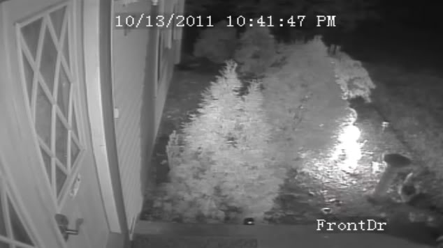

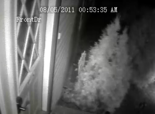

shockwave199 0 Posted October 14, 2011 Here's some pics from my install for an example. Putting aside picture quality, the fov between each camera is what to look at. Each camera is in the same spot, the older ones that I swapped out being the 1/4". 1/4" 3.6mm 1/3" 4mm 1/4" 3.6mm 1/3" 4mm Hope this helps to get a visual sense of things. Dan Share this post Link to post Share on other sites
