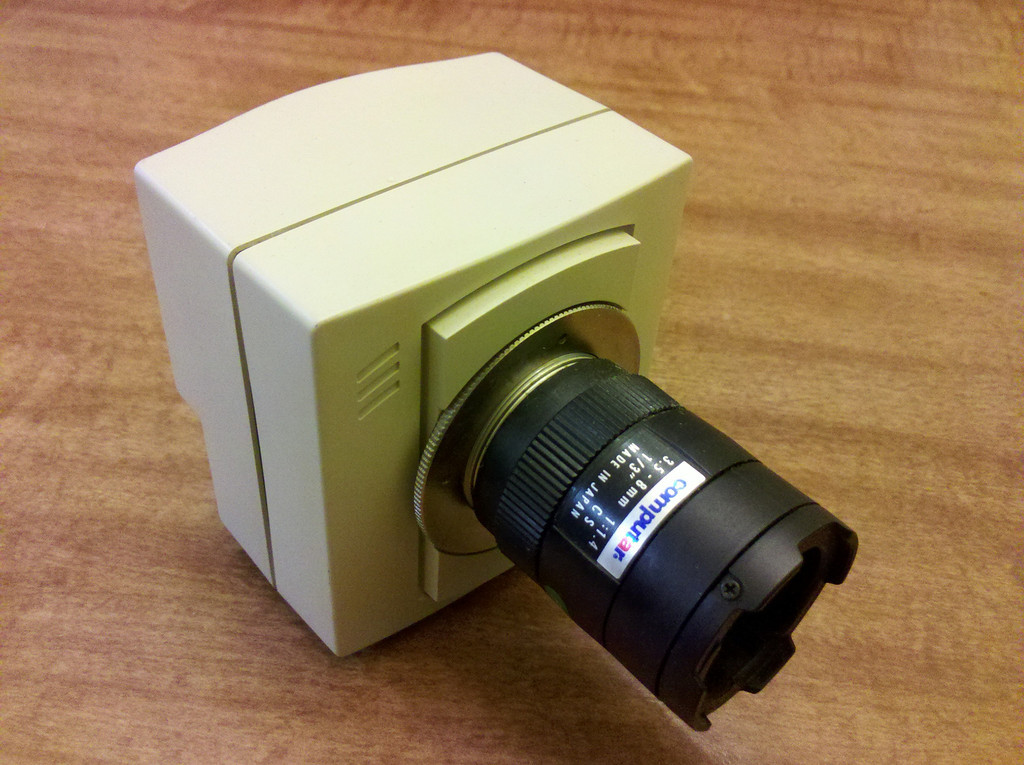

Rally_Rebel 0 Posted October 18, 2011 Hopefully to stir up some responses I'll post up some pics of the cameras I have, maybe that'll get some "Those're really OLD!" commentary or similar LOL! Guess I'll juice 'em up and see how they fare in outdoor and night use, maybe I can just get some auto-iris lenses (Computar manuals on now) and use. Share this post Link to post Share on other sites

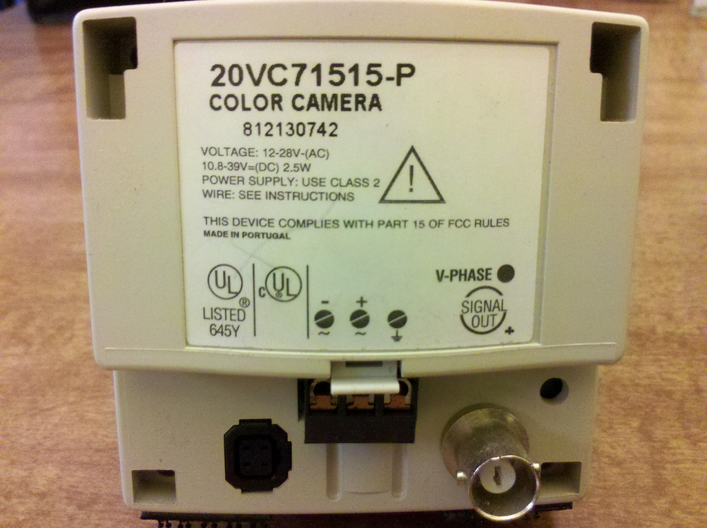

Rally_Rebel 0 Posted October 21, 2011 So here's one for you mystery lovers... Name that camera! Here are a couple pics of the cams I have in case anyone can identify them, don't worry as I already expect an overwhelming response of "That's crap!" from y'all, lol. Tried to take a pic this evening of where the initial installation will view but my phone camera wasn't up to task so I'll take the DSLR out next time. Neighbor across street has a utility pole dusk-to-dawn area light and I'm curious if that will affect any of my setup. Thanks! Share this post Link to post Share on other sites

HTElectrical 0 Posted October 24, 2011 That is an old Pelco camera. Share this post Link to post Share on other sites
Rally_Rebel 0 Posted October 24, 2011 That is an old Pelco camera. But is it good for the setup outlined in the OP? I've got no problem with older model equipment as long as it's good older model equipment. Share this post Link to post Share on other sites
hardwired 0 Posted October 24, 2011 That is an old Pelco camera. But is it good for the setup outlined in the OP? I've got no problem with older model equipment as long as it's good older model equipment. It's likely going to be pretty limited for your outdoor application, it appears to be color only, not D/N with a IR cutfilter, so it most likely will not see your IR illuminator, as well as not having an auto-iris lens currently (it has the connector for it, though). Those Pelco cube cameras were usually OEM'ed by Sanyo or Ikegami, as I recall. Not bad cameras, but probably not well suited for your application (you might keep them for inside views, though). Share this post Link to post Share on other sites
