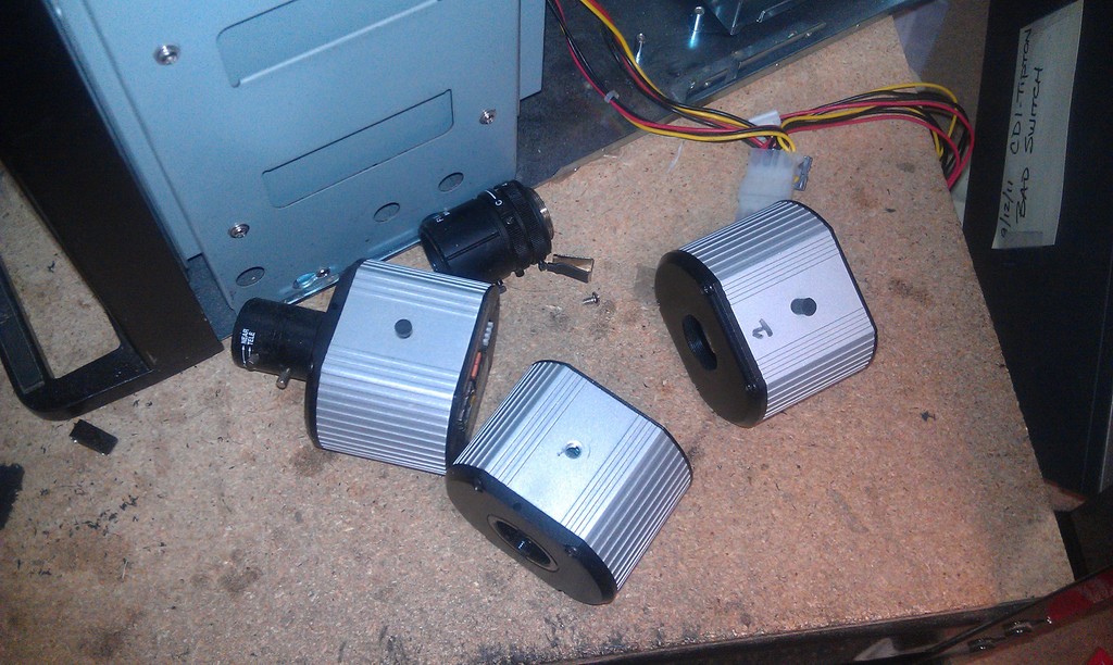

hardwired 0 Posted November 21, 2011 Paperweights under my desk. Share this post Link to post Share on other sites
