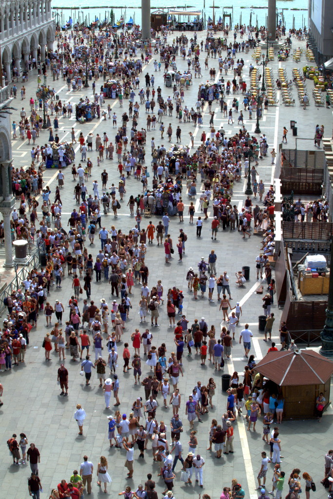

ak357 0 Posted October 30, 2011 Small summer home. Need a camera to watch the 20x75 driveway narrow and long shot sample ( like your driveway ) was reduce for forum make sure watch in full resolution camera was flip 90 degree then flip by software to get 9x16 instead 16x9 Share this post Link to post Share on other sites
