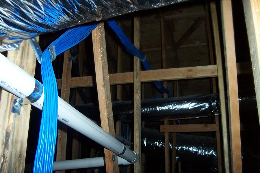

C7 in CA 0 Posted August 13, 2005 I guess CCTV is a little different then data networks. Mostly because there is usually a lot more cables for data. But I always run from the server room out. I pull the longest drops first. As I'm pulling the first drops I setup my Cablejoes where needed along the way. Then on the way back I install my Jhooks and remove the cables from the cablejoes and into the Jhooks. The trick is to mapout your pathways carefully so you can keep the bulk of your cables bundled. Then just branch off from the large bundles when close to the actual location of the drop. I rough-in all the cables first then set my guys loose on terminating the outlets while I work on the server room. ____________________________________________ Share this post Link to post Share on other sites
DataAve 0 Posted August 15, 2005 Haven't seen wood frame in ages. Share this post Link to post Share on other sites
C7 in CA 0 Posted August 16, 2005 Yeah, not many steel mills around here. But lots of trees. That was a great attic to work in. 12 feet at the peak and no tighter then about 3 feet at the low spot of the gable. Too bad the wood was so green. The glistening specs is sap. Share this post Link to post Share on other sites
rory 0 Posted August 16, 2005 thats a huge attic man . .. we used to work in attics down here where either the ac insulation took up the full 2 feet of attic space ... night mare and plenty of scratching. .... or there were nails everywhere, non covered electrical boxes etc ... i got 2 holes in my head from the alarm days, jumping into an attic where nails were sticking out right there, in fact, my bold spot is from one of those scars!! and thats foe real ... now, i stay out of attics ... cant take loosing any moe hair dude ... Share this post Link to post Share on other sites
