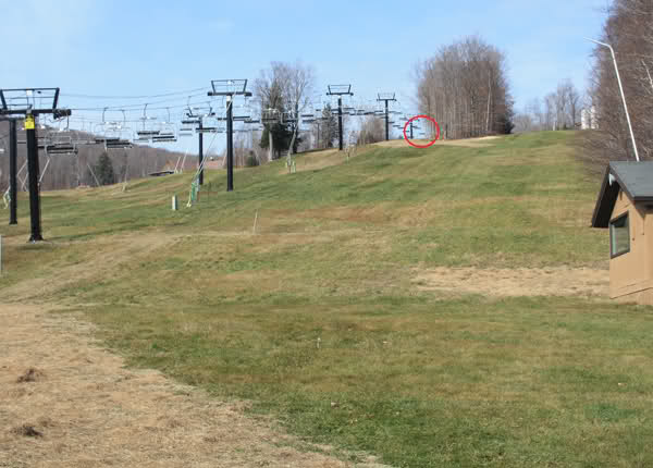

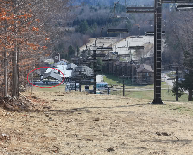

gymnast46 0 Posted November 14, 2011 Had a thought in the middle of the night. There's no reason the camera couldn't be positioned inside the base lodge looking up the hill. That would solve the problems of power supply and cold temperatures. I believe there is a WiFi signal there as well. Here's a shot of the lodge (circled) and the view from below (start of course is out of sight behind circle}. Would I need a zoom on the camera? Assuming I can get a WiFi signal to the start shack how do I get the video stream? Is it web based? And lastly what affordable recommendations do you have? I greatly appreciate your help on this! Share this post Link to post Share on other sites
