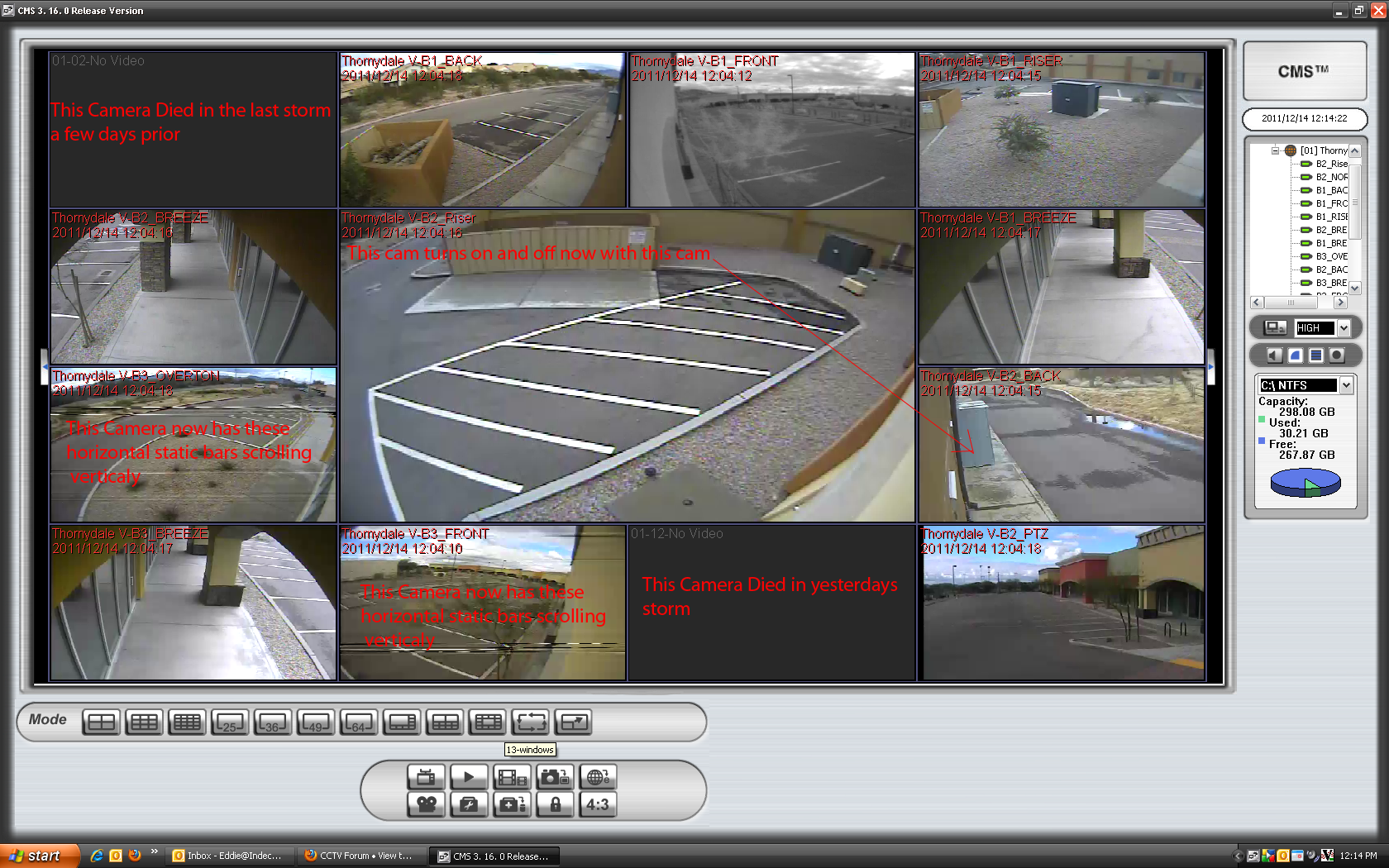

eztech 0 Posted December 14, 2011 (edited) Then I am at a loss. We install these CNB cams ( CNB-BBM-24F and CNB-V2815NVR) all the time. We use these power supplies all the time. Anyone have a clue what might be happening here? This always happens surrounding inclement weather, yet none of the equipment is getting wet, no lens fogging, nothing. If anyone here has any solutions or avenues to search please let me know at your discretion, Thanks Here is an image of the issues I'm having Here is the Layout of the Installation www.indecomaz.com/Files/CCTVPlan2.pdf Edited December 14, 2011 by Guest Share this post Link to post Share on other sites
Soundy 1 Posted December 14, 2011 Are these cameras only dying temporarily, or permanently? Have any of them gone back to CNB to see if they can determine what is actually failing in them? Is it possible power is getting fed into the video output? How are they wired - are you using coax, or UTP+baluns? If the latter, are you terminating in keystones? I've seen a particular keystone design that allowed wire ends to touch and fried a couple cameras when they got full PoE power fed into the NIC. Share this post Link to post Share on other sites
eztech 0 Posted December 14, 2011 They were cabled with coaxial originally, we took a shot in the dark and re cabled to cat5e with baluns about 2 months ago. the Baluns use one pair connected to terminals on the baluns. The system generally has no video distortion and no ground loops. It varies, the 2 with no video in the pic are probably permanently damaged. Some will go on and off for a day and then be fine. Sometimes a month goes by without any issues. Share this post Link to post Share on other sites

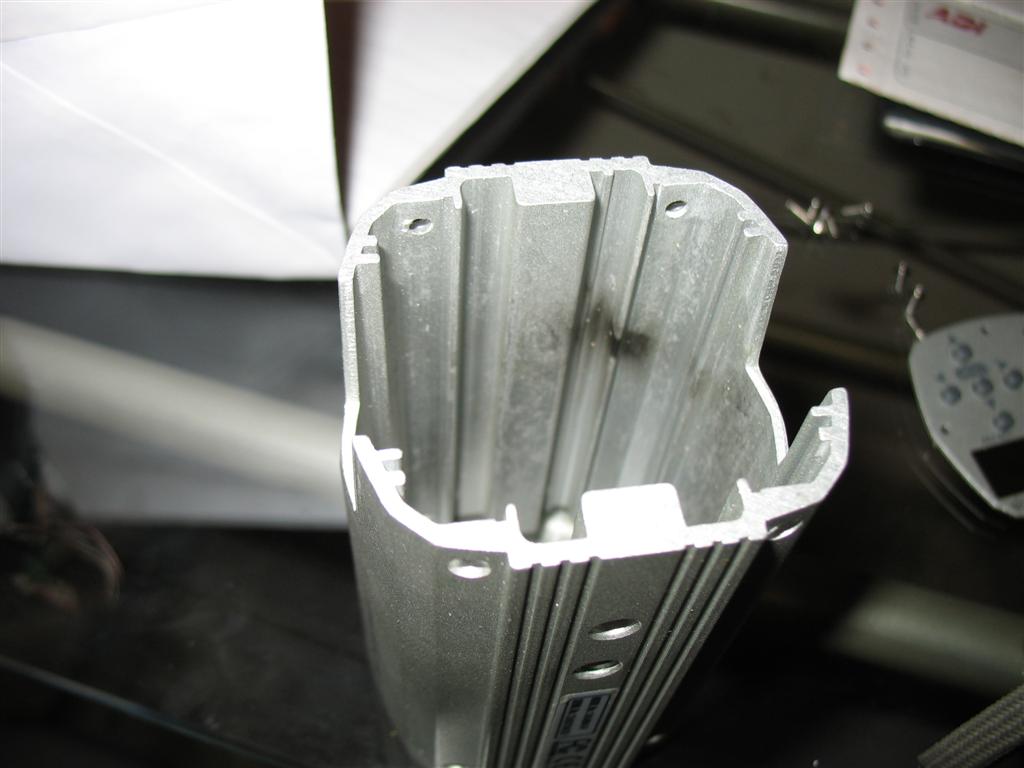

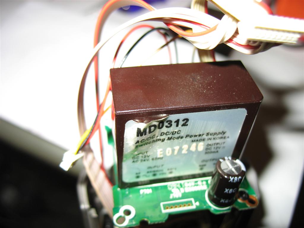

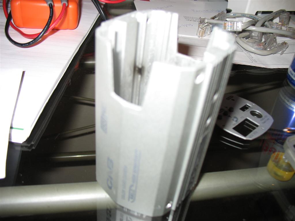

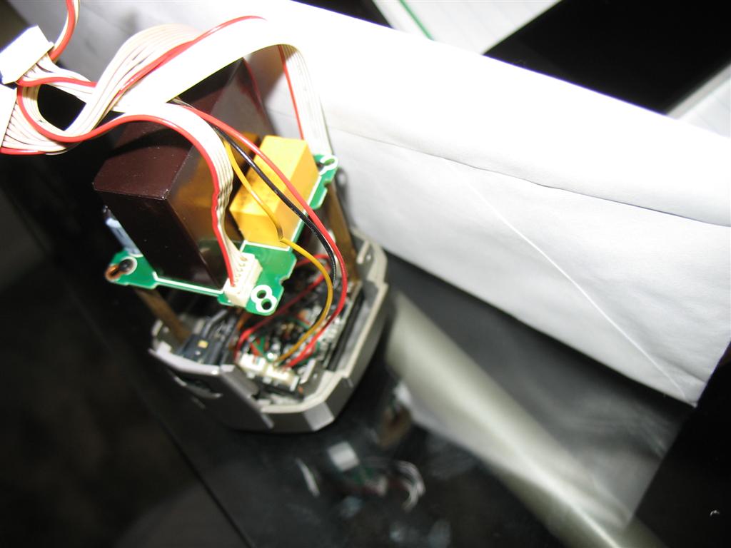

eztech 0 Posted December 15, 2011 ok, so I disassembled the box cam that recently failed and was surprised to find this. The yellow wire was pinched between the power board and the housing Notice the melted bulge in the power supply Here is a pic of the housing where the conductor eventually meted through its sheathing Here is another pic of the housing to see the manufacturer name l Share this post Link to post Share on other sites

Soundy 1 Posted December 15, 2011 ok, so I disassembled the box cam that recently failed and was surprised to find this. The yellow wire was pinched between the power board and the housing Wow. I think I'd be sending that back to CNB and *insisting* on a replacement. Share this post Link to post Share on other sites
