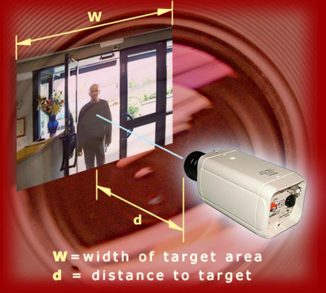

I get the feeling this whole project was dumped on you and to replace everything with IP cameras is going to be quite expensive. While IP megapixel cameras produce a great sharp image, so too can high resolution analogue cameras with the correct lens fitted.
What are the cameras you have already? Some cameras, even cheap ones have interchangeable lenses, some are fixed lens.
Choosing an appropriate lens will help achieve a correct depth-of-view and an appropriate image focussed correctly.
Imagine the view is flat on screen, from which point to which point do you want to view? If you just want to capture people's image as they pass through a doorway, the scene width would be the width of the door at a fixed distance. To now assign a distance from the camera, you need the horizontal distance to the doorway and then the height of the camera. Using the pythagorus law, you can calculate the actual distance to the door from the camera.
In reality, in your situation you can probably use a tape measure depending on the size of the DIY shop.
Now check the camera's spec sheet and find out it's lens size (mm) and it's CCD sensor size ¼", or ⅓" or ½" and the lens type if specified.
So now we have
The lens type, )could be C, CS or '12mm thread' board lens Thread as opposed to focal length.
the camera's lens size (mm)
a ⅓" sensor in the camera (Typically)
the scene width (in m or feet)
the distance from camera to the field of view (doorway) (in m or feet)
With this info, we can save some time using this online lens calculator
for an example, you have a camera situation thus;
⅓" sensor in the camera (assumed)
A horizontal distance of 15 ft to the doorway
a camera mounting height of 12 ft
Pythagorus:
225+144=369 , √369=19.2 ft actual distance to doorway
and the doorway is 4 ft wide (assumed)
putting all this data into the lens calculator wee see we need a 23.04 lens
in reality no such lens exists so we need to get one as close as possible to that figure
so changing the scene width to say 3.5 ft and calculating we see that the lens required changes to 26.33
and again no such lens exists but a 25mm lens is quite common so we can play a bit with the scene width to get as close to an available lens making sure we are still within an acceptable width.
I hope this is helpful
OR, save yourself a ton of math and just use a varifocal lens, and adjust it to get the view you need. Comiscar/Pentax have a 5-50mm C/CS-mount that lists for <$100.
Edit: BTW, that's a neat lens calculator... this one will also let you enter the camera height and do the angle calculation for you: http://cctvlenscalculator.com/
