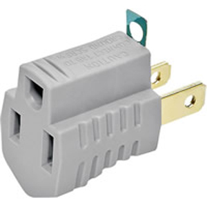

Sounds like a ground-loop issue somewhere, but narrowing it down could be tricky with so many variables. You could try isolating the power grounds on each device using a ground-lift plug:
Will do and thanks for the quick reply. Wikipedia says something about these plugs being dangerous though so I'm assuming that these are just for testing and not a permanent solution.
Keep in mind that ANYONE can write or edit a Wikipedia article, so take that accuracy for what it's worth... these CAN be dangerous if used improperly, in certain situations where a ground is REQUIRED for safety. In this case, it's not. We used to use them regularly in the studio for lifting grounds on guitar amps when they caused interference issues... and sometimes actually to IMPROVE safety (ever seen a spark jump from a mic to a musician's lip because a leaky circuit is trying to find a ground through him via his amp's ground?)
You can alternately snip the ground plug off your various equipment's power cords, but that's kind of a more permanent thing... these will allow you to test the theory first.
