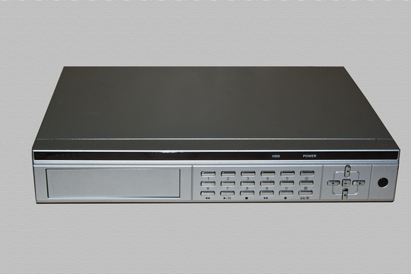

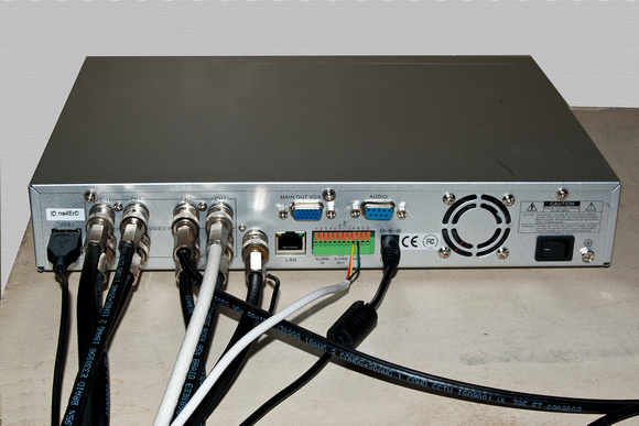

Here are a couple shots I took of my DVR its a "no name" made in China. I think I've learned my lesson about buying imports, if you want service or tech support... BUY LOCAL!
BTW I unpluged the LAN cable when I took the photos, I had it connected while trying to connect to my computer. No, really!
I see the problem: the power switch is turned off! 172367_1.png
Anyway... you're trying to connect on port 8080... however, many routers use 8080 for their default remote-admin port, which could explain why you're kicking straight into the router's config page. You may need to either select another port for the DVR, or see if you can find a remote-admin setting and either disable it, or change its port.
