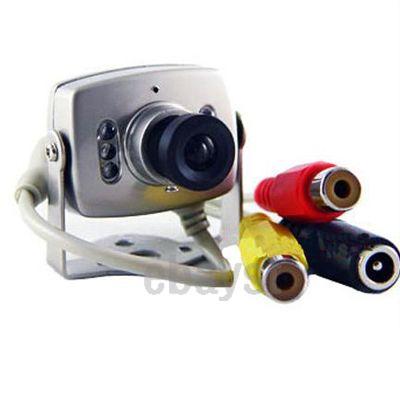

Numb-nuts 1 Posted November 27, 2011 (edited) Analogue cameras do, most IP cameras don't but some have a BNC outlet so that the camera can be aimed and focused with traditional CCTV test screens. Thank heavens for that. If the camera has a RJ45 inlet (usually at the rear but not always) it is almost certainly a IP camera. Sometimes but not so often the video inlet will be a screw terminal Vid+ and Vid- but I have never seen this on a Body camera yet, it's usually PTZ and fixed dome cameras that sometimes have that and some board cameras. I have seen some cheap cameras with a RCA inlet (usually colour coded yellow) for video instead of BNC. I am curious why do you ask? Edited November 28, 2011 by Guest Share this post Link to post Share on other sites

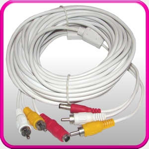

Numb-nuts 1 Posted November 28, 2011 Simply ask the retailer if you need to order BNC connectors for those cameras. I doubt they'de sell you something you really don't need. Besides, Box or Body cameras rarely have RCA socket it's nearly always BNC. If you are using pre made cables they often have a RCA plug so then you may need BNC adaptor. I didn't mean to create uncertainty in anyone's mind but wanted to make the point as we aren't being specific. Share this post Link to post Share on other sites
SectorSecurity 0 Posted November 28, 2011 No need to worry the runs I am covering are far to great to be covered with premade cables, will be using cat5 utp Share this post Link to post Share on other sites
