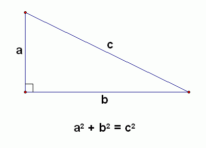

Numb-nuts 1 Posted November 30, 2011 (edited) Those are quite a wide range of dimentions. You can use this lens calculator to work out the lens you want. Don't forget to adjust for actual distance to target by using pythagorus' theorem for right angle triangles. i.e. a² +b²= c² But I'm sure most of you knew that, I just mention it so nobody is embarrassed to ask. This is only really important when specifying a fixed lens, but with a varifocal lens, it doesn't matter quite so much. You will want an f stop of 1.3 or greater, to get a good depth-of-field and it should be IR correcting Auto Iris. I'm sure I'll take some stick for stating pythagorus' theorem for right angle triangles, but there you go... Edited December 1, 2011 by Guest Share this post Link to post Share on other sites

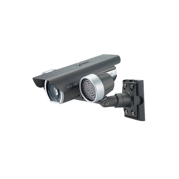

tomcctv 190 Posted December 1, 2011 woltert1 said: I am looking at the CNB MIR1000 or the Vitek VT-IR2 hi. by the time you have bought your IR illuminators then camera then lens and housing you are over the cost of the CNB XHN. full control and setup from your dvr. Share this post Link to post Share on other sites

tomcctv 190 Posted December 2, 2011 woltert1 said: The reason that I am looking at separate IR is because it will give me the ability to put it in the best location hi the CNB is separate IR. you can mount the IR were ever you want. but for 250m you will need IR behind the camera and ir at your target end Share this post Link to post Share on other sites

tomcctv 190 Posted December 4, 2011 woltert1 said: Thanks for the responses so far, but ,y main point is getting lost.I need suggestions for a quality box camera lens set up. which is what the CNB is it has a box camera and 27x lens (you can buy without the housing if you dont need it) woltert1 said: as long as the picture will give me a high quality picture. what is your budget ?? Share this post Link to post Share on other sites
