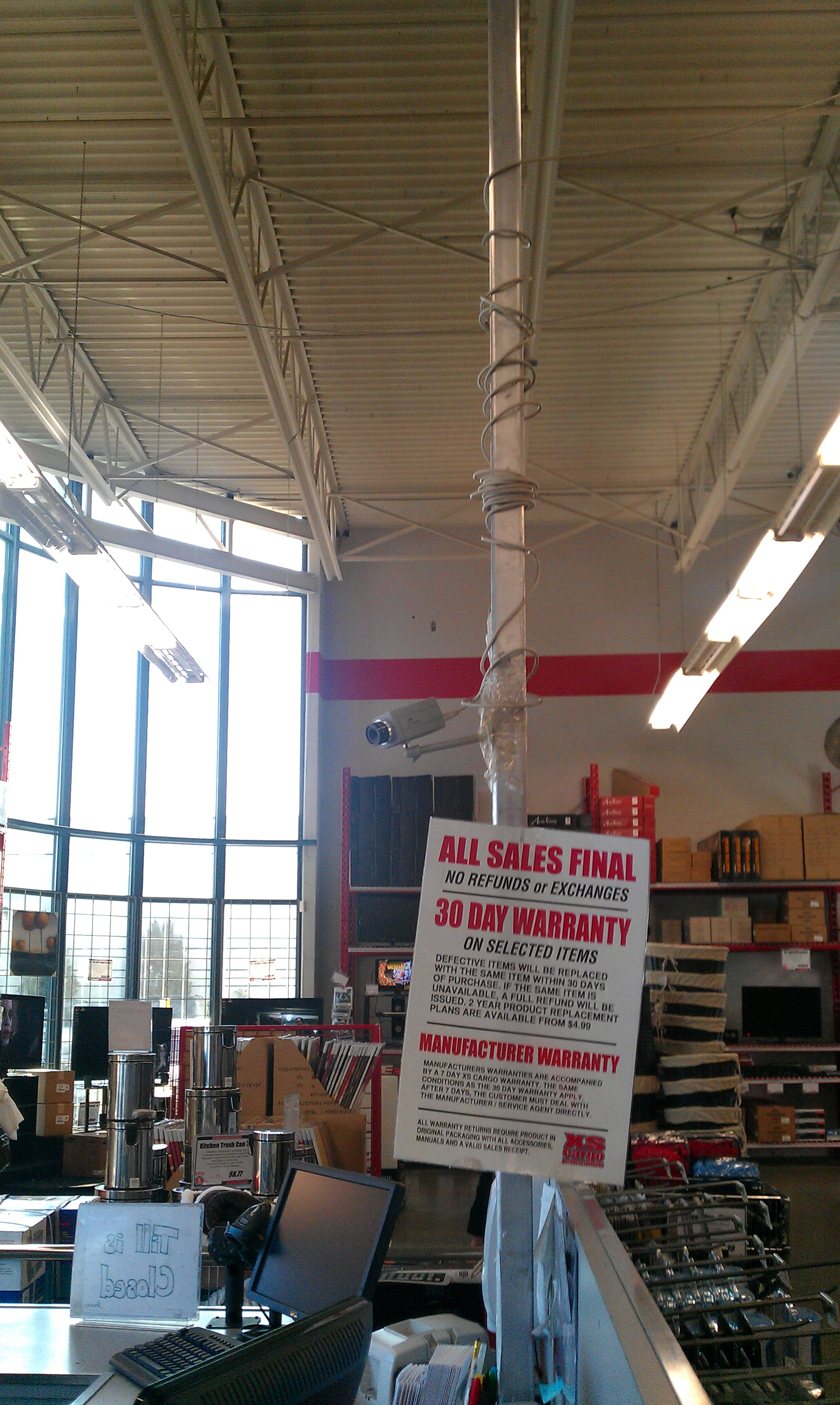

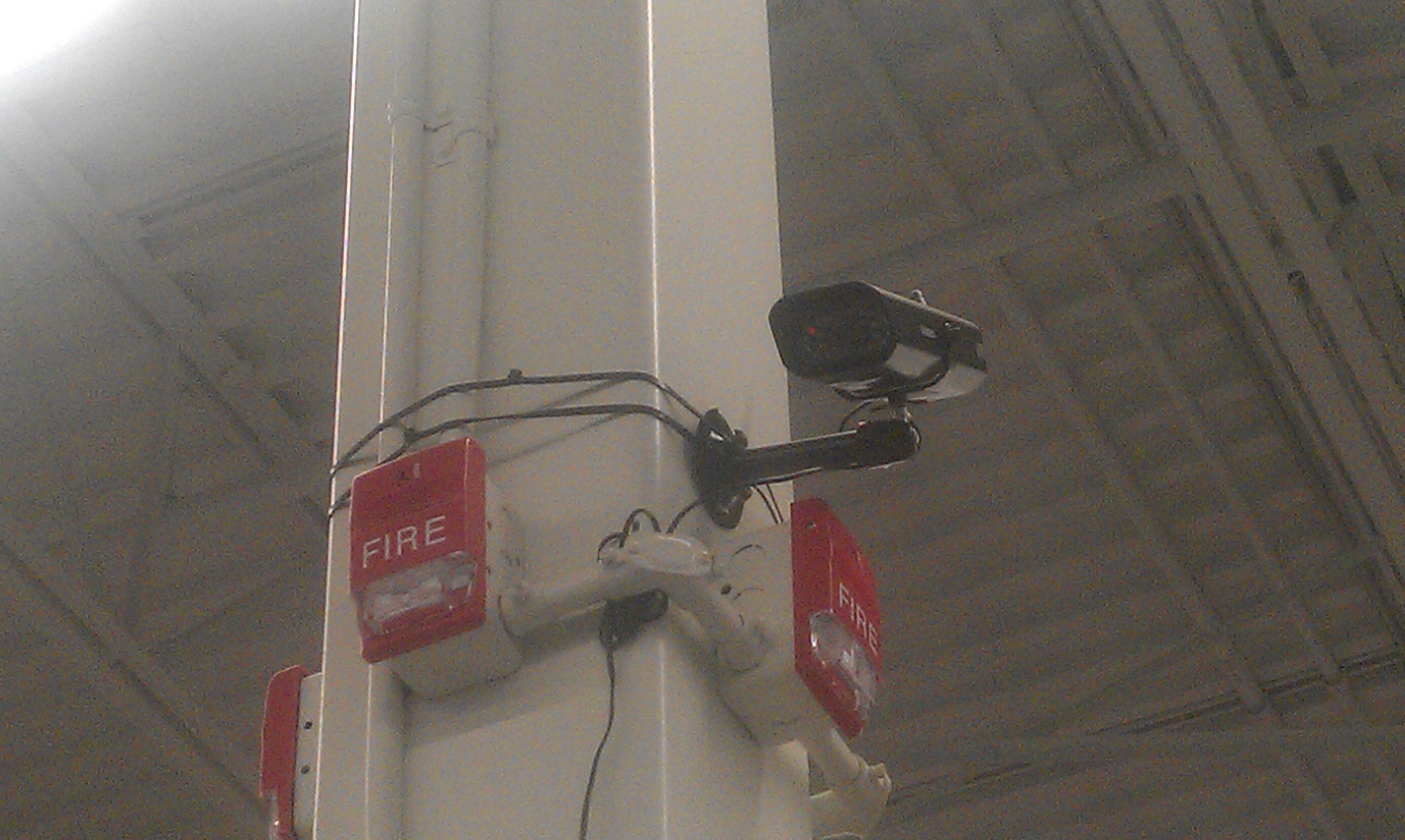

Soundy 1 Posted December 5, 2011 Seen at a Wal-Mart... overlooking the electronics department, no less: Clerk wondered what I was taking a picture of... my co-worker and I told him what we do and that we were getting a chuckle over the install. Clerk said he'd done it because his manager wanted cameras put up with one of the box systems they were selling. D-oh! (BTW, the power wire drops down to a wall wart plugged into a handy outlet... about 6' off the floor... not terribly secure.) Spotted this one at a liquidation store: Share this post Link to post Share on other sites
Numb-nuts 1 Posted December 6, 2011 That puts a new spin on the term "twisted pair" What a nice welcoming sign too. Share this post Link to post Share on other sites
Ken Layton 0 Posted December 6, 2011 Twisted pair? Looks more like a May pole. Share this post Link to post Share on other sites

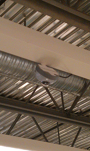

jeromephone 6 Posted December 14, 2011 The Walmart guys must not know what a beam clamp is. Share this post Link to post Share on other sites

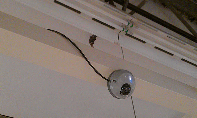

Soundy 1 Posted January 3, 2012 Saw this gem at Ikea today, of all places... Share this post Link to post Share on other sites
Sawbones 0 Posted January 3, 2012 Saw this gem at Ikea today, of all places... Is that an Axis camera with double-sided tape on the bottom? I'm not sure what they were trying to do there. Share this post Link to post Share on other sites
Soundy 1 Posted January 3, 2012 That's exactly what it is... and it looks like most of the cameras around the place are mounted that way... lot of them have wires dangling down from where it runs along the tops of the ceiling beams, too. Scary. It's clear what they were TRYING to do: this one is at the top of an escalators, and if it was in place, would be looking right down the escalator. As it is now, it's looking at the floor at the top of the escalator *facepalm* Share this post Link to post Share on other sites
Sawbones 0 Posted January 3, 2012 That's exactly what it is... and it looks like most of the cameras around the place are mounted that way... lot of them have wires dangling down from where it runs along the tops of the ceiling beams, too. Scary. It's clear what they were TRYING to do: this one is at the top of an escalators, and if it was in place, would be looking right down the escalator. As it is now, it's looking at the floor at the top of the escalator *facepalm* *shakes head* Wow. I'm just a rookie... but even I know that screws > tape. Share this post Link to post Share on other sites

dustmop 0 Posted January 4, 2012 If the metal beam was too difficult to drill into, I would have found a way to put a plate up with LARGE hose clamps to mount it on. That's just my take. Also, they DO make tape more than strong enough to hold those cameras up. 3M VHB tape. It costs a fortune, and is what they use to make window curtain walls on building facades. Also, no safety chain/cable? WTF... Share this post Link to post Share on other sites
Sawbones 0 Posted January 4, 2012 If the metal beam was too difficult to drill into, I would have found a way to put a plate up with LARGE hose clamps to mount it on. That's just my take. Also, they DO make tape more than strong enough to hold those cameras up. 3M VHB tape. It costs a fortune, and is what they use to make window curtain walls on building facades. Also, no safety chain/cable? WTF... If push came to shove, and the camera had a metal body, could you just use one of those neodymium magnets to stick it to that metal beam? On second thought, bad idea... those magnets are very strong... it might screw up something inside the camera. And they do have a safety chain... it's called that Cat5 cable Share this post Link to post Share on other sites

fa chris 0 Posted January 4, 2012 If the metal beam was too difficult to drill into, I would have found a way to put a plate up with LARGE hose clamps to mount it on. That's just my take. Also, they DO make tape more than strong enough to hold those cameras up. 3M VHB tape. It costs a fortune, and is what they use to make window curtain walls on building facades. Also, no safety chain/cable? WTF... I would've used a pendent mount and taken it from the structure above. Plenty of places to clamp it too. Share this post Link to post Share on other sites

jeromephone 6 Posted January 5, 2012 Beam clamps anyone? clamp a piece of plywood and screw the camera down. Might look like crap but will not fall off when the oil in the paint eats up the glue in the double sided tape. Share this post Link to post Share on other sites
