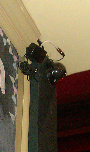

Securame 0 Posted March 14, 2012 Here is a "fun" one. I get a customer who purchased everything to do the installation himself complaining that the stands I have given him are crap; that they do not fit ok, that he can not move the camera sideways, bla bla... That it is a pain in the ass to orient the camera. He says that for mounting it he needs to make extra holes because the ones the stand has do not fit ok. Without knowing what he was doing I say ok, go ahead and make it as long as it is on the stand, not on the camera. When I went to see the install, this is what I found... :facepalm: Share this post Link to post Share on other sites
jtetterton 0 Posted March 14, 2012 It took me a minute but I figured that one out.. lmao.. How did you explain to him what he did wrong there? LMAO Share this post Link to post Share on other sites
Soundy 1 Posted March 14, 2012 You can't explain anything to these people... Share this post Link to post Share on other sites
Securame 0 Posted March 14, 2012 I should have asked him if he saw any difference between the way the stand was portrayed on our catalog, and the way he had mounted it. I think I just wouldn't have said anything... if it wasn't that he had told me earlier those stands were junk because they were not fiting ok, because the cameras could not be moved to the sides easily, and so on... so I had to. Share this post Link to post Share on other sites

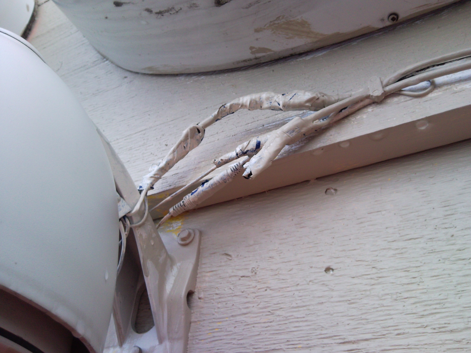

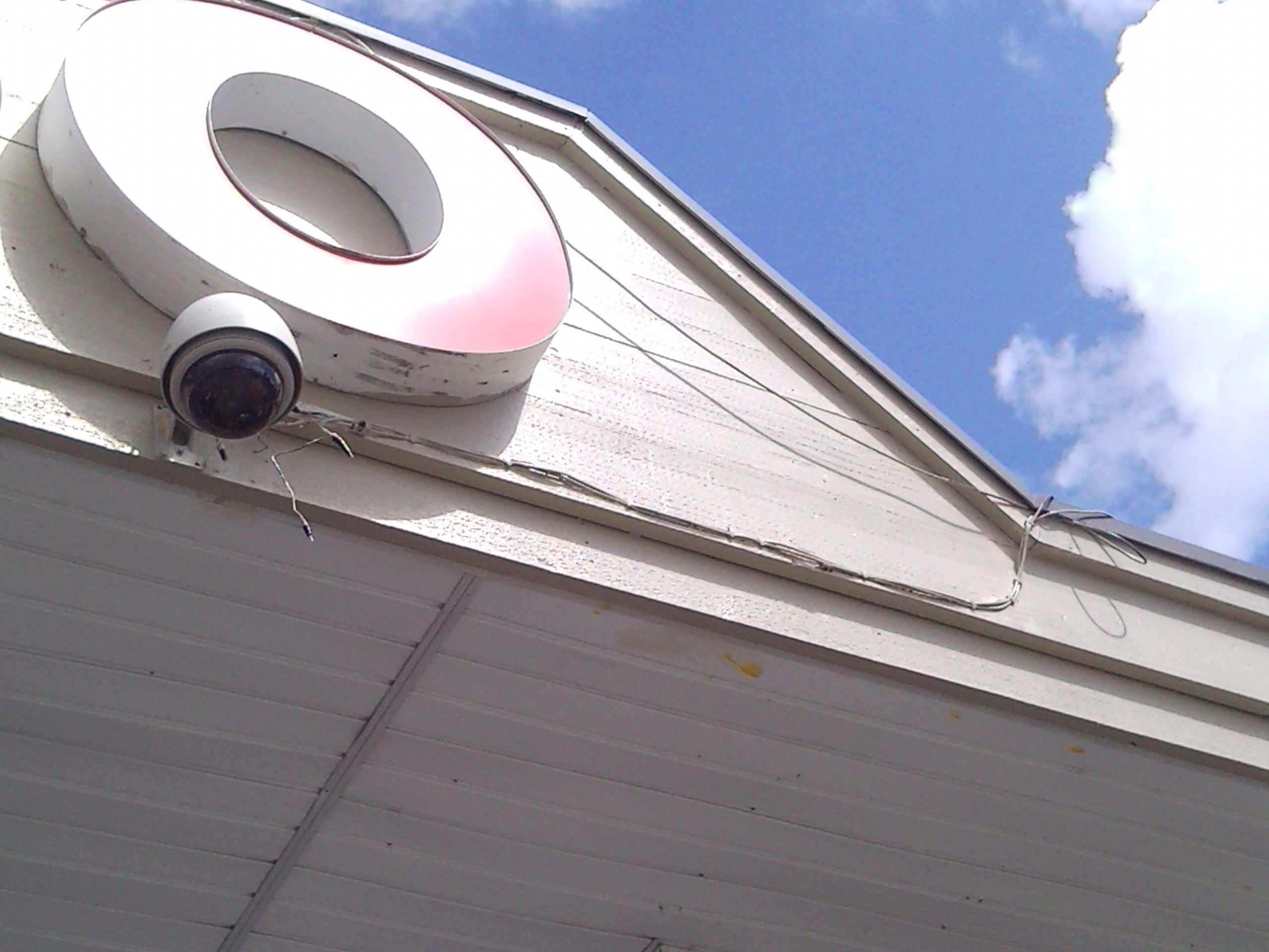

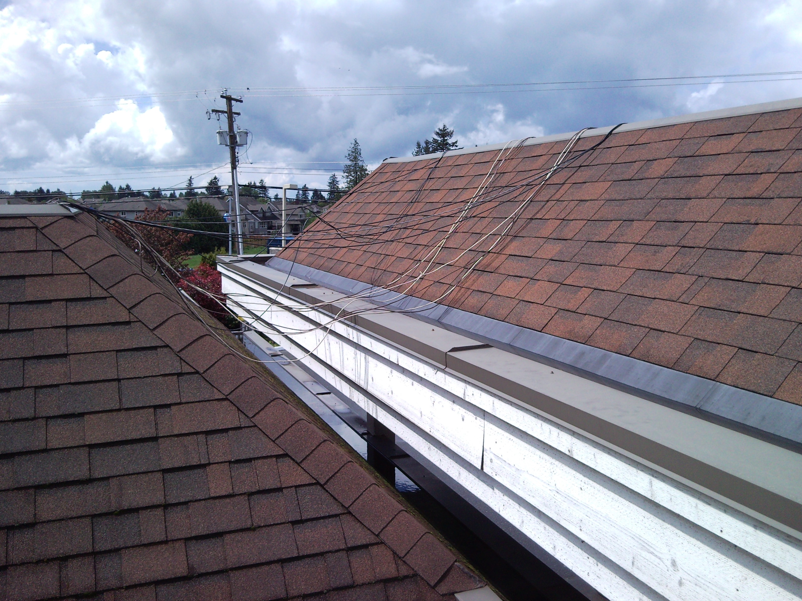

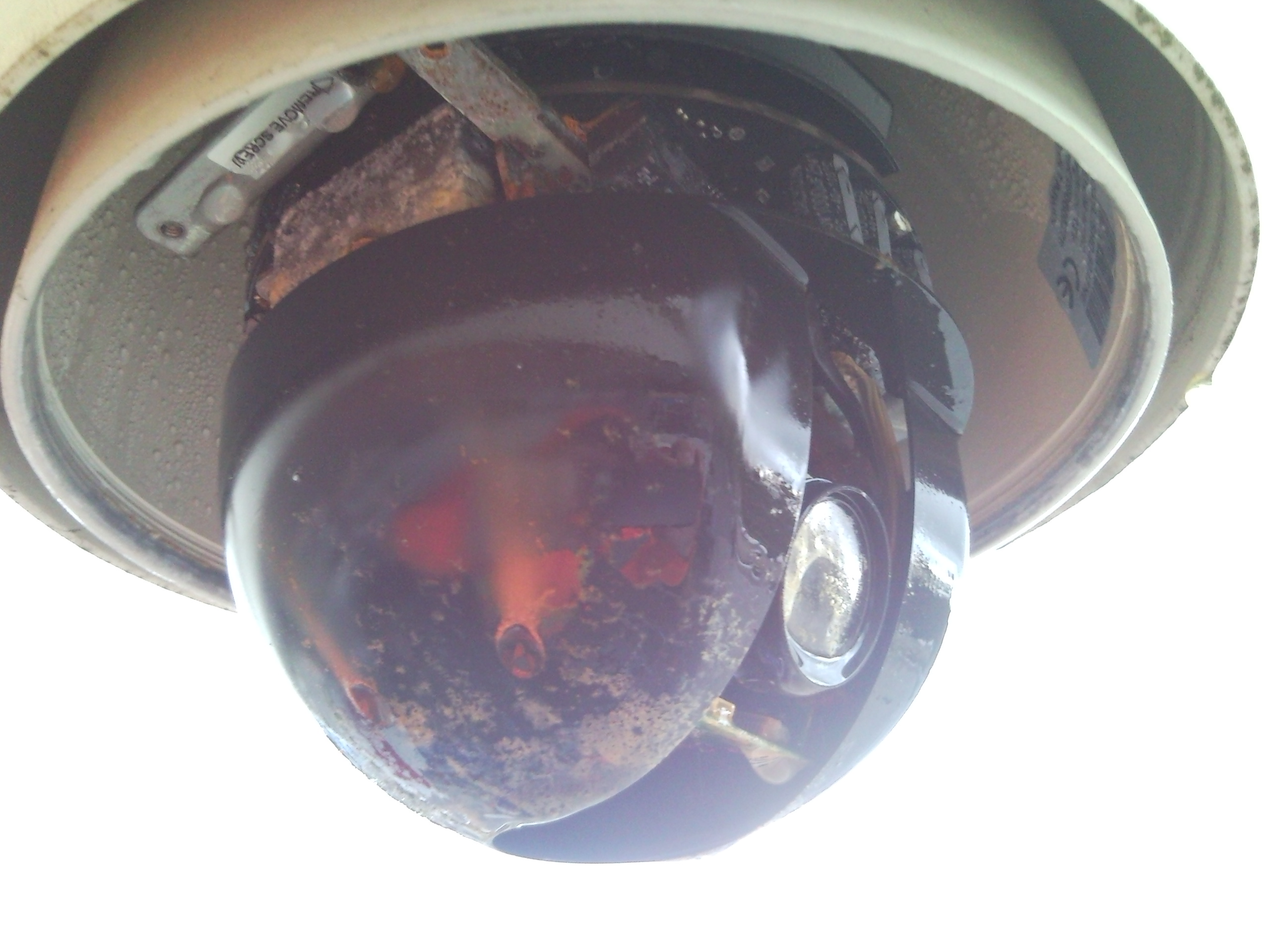

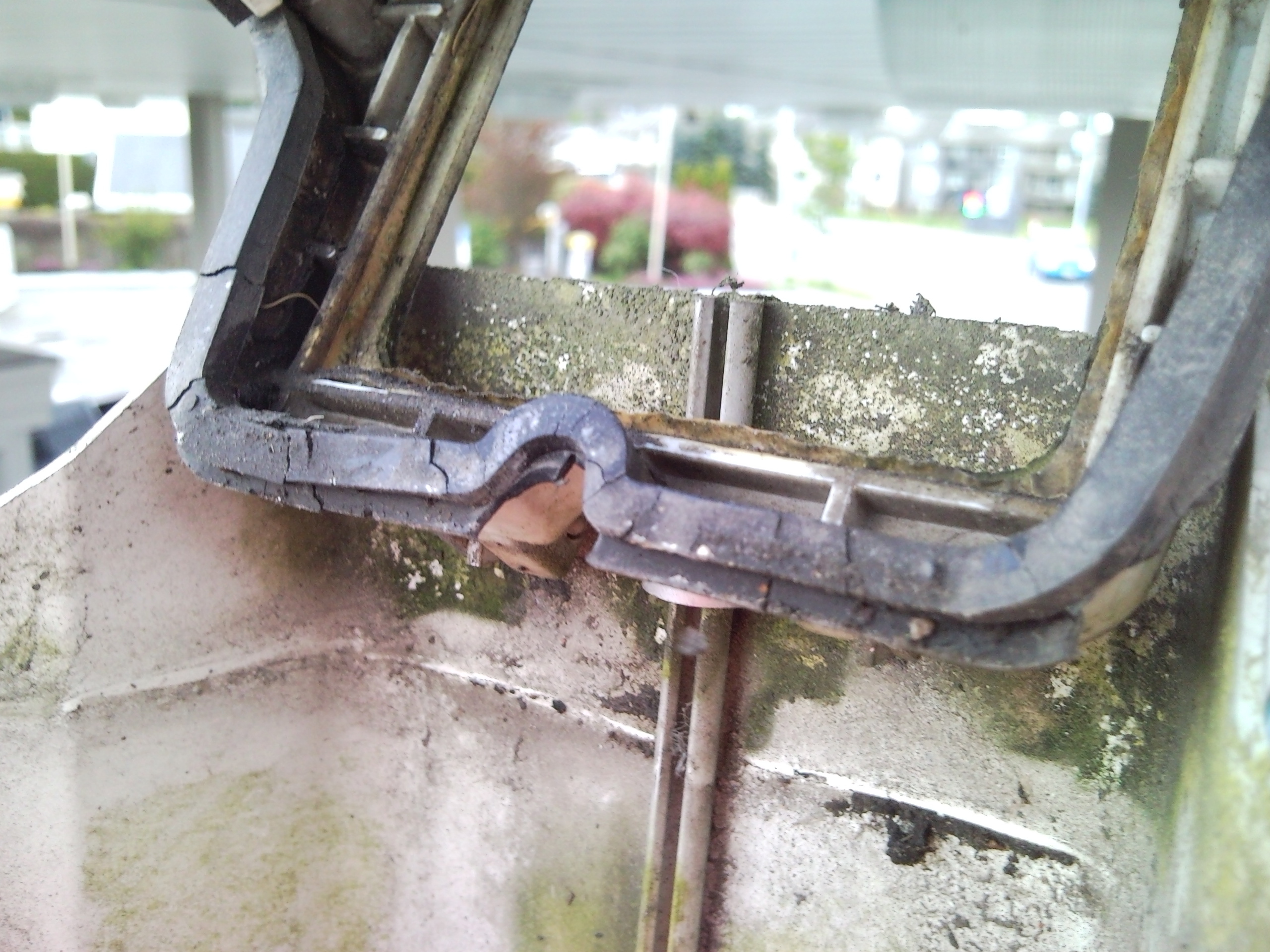

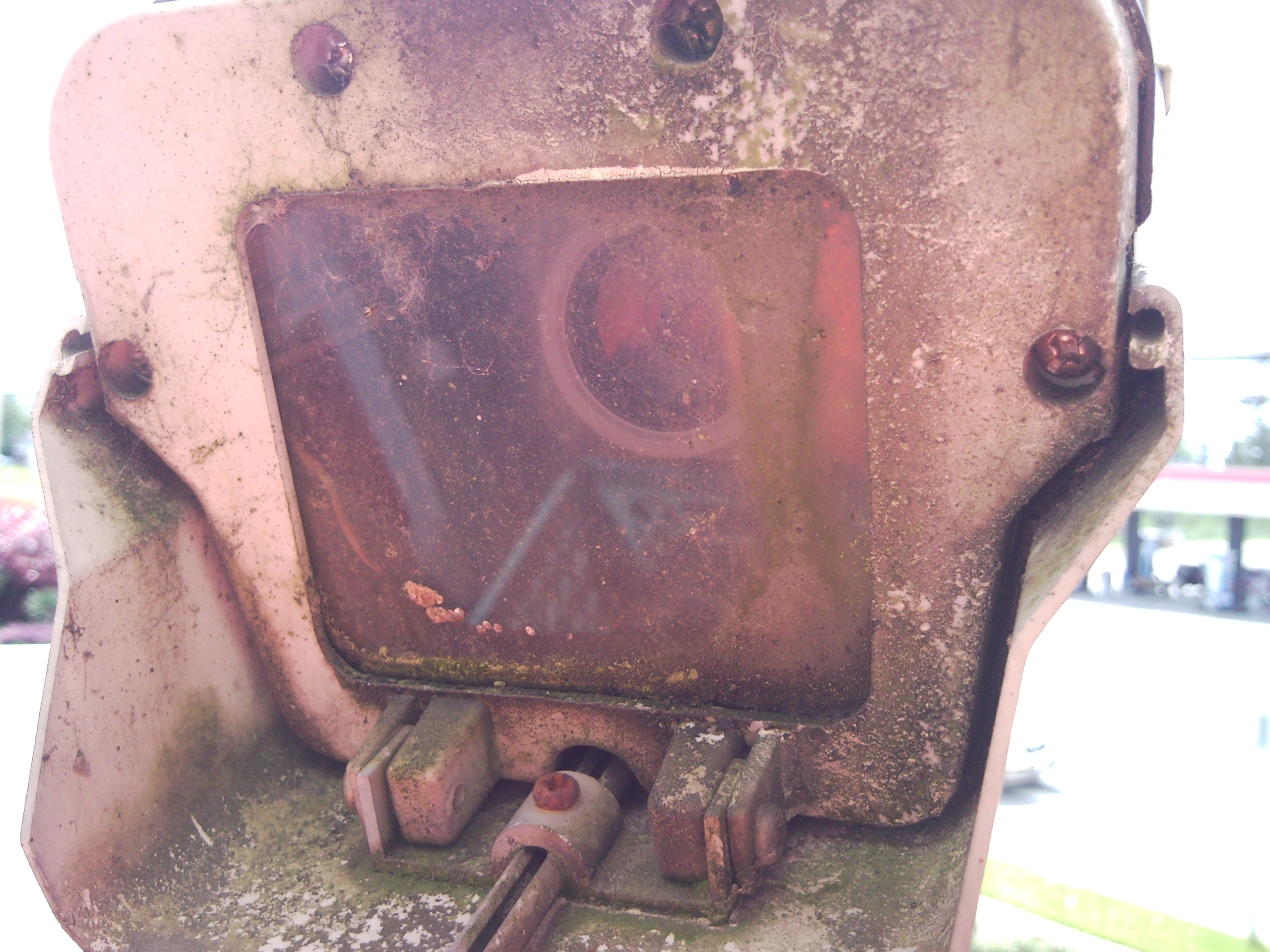

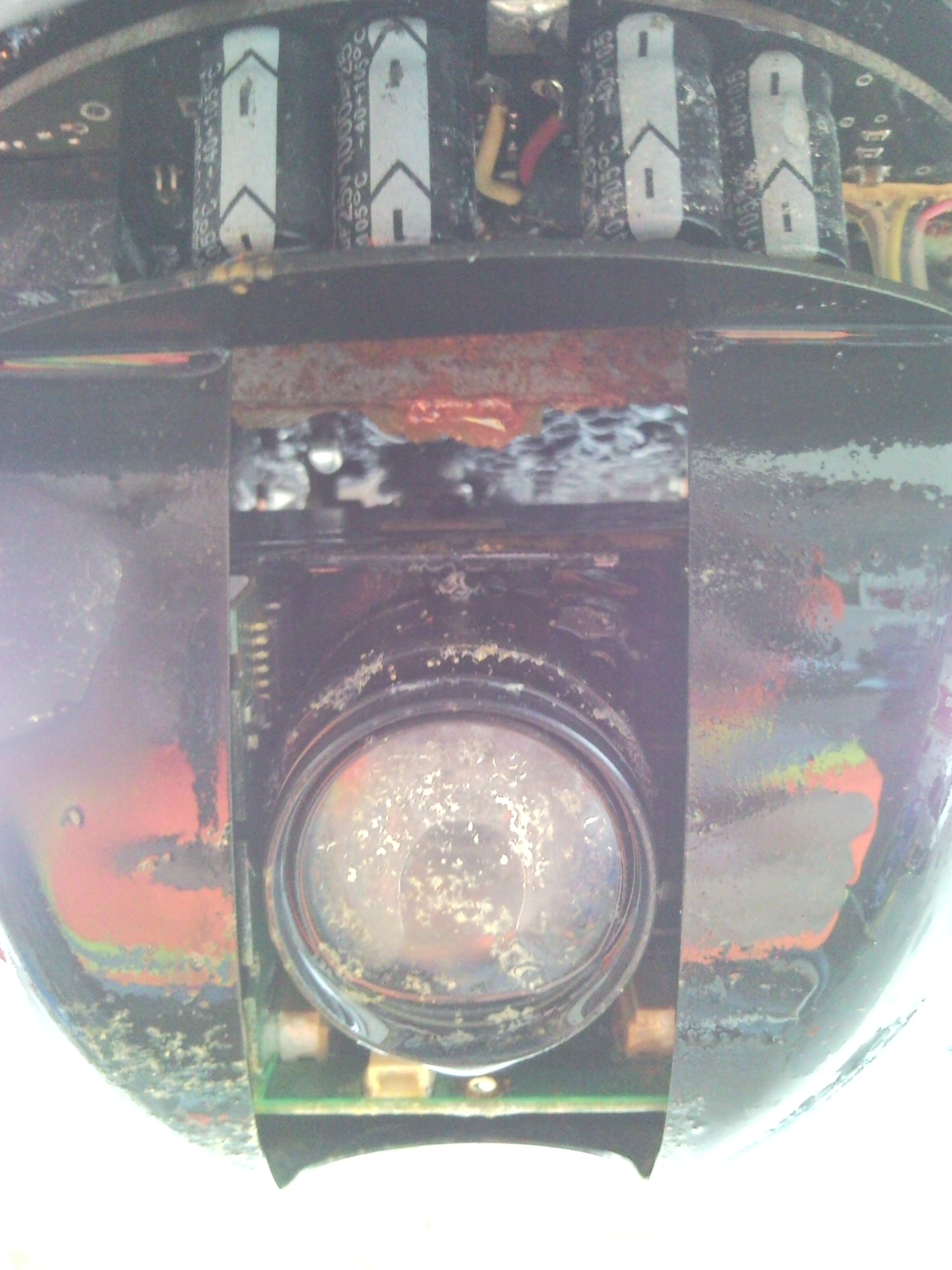

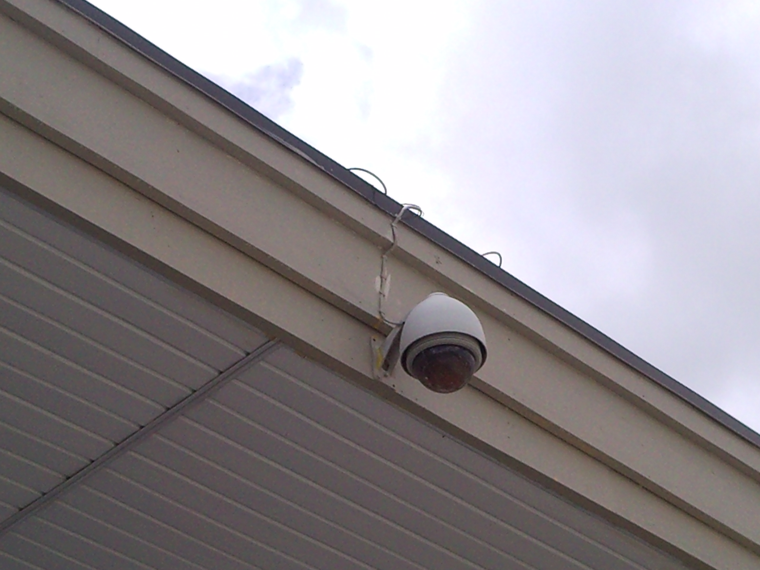

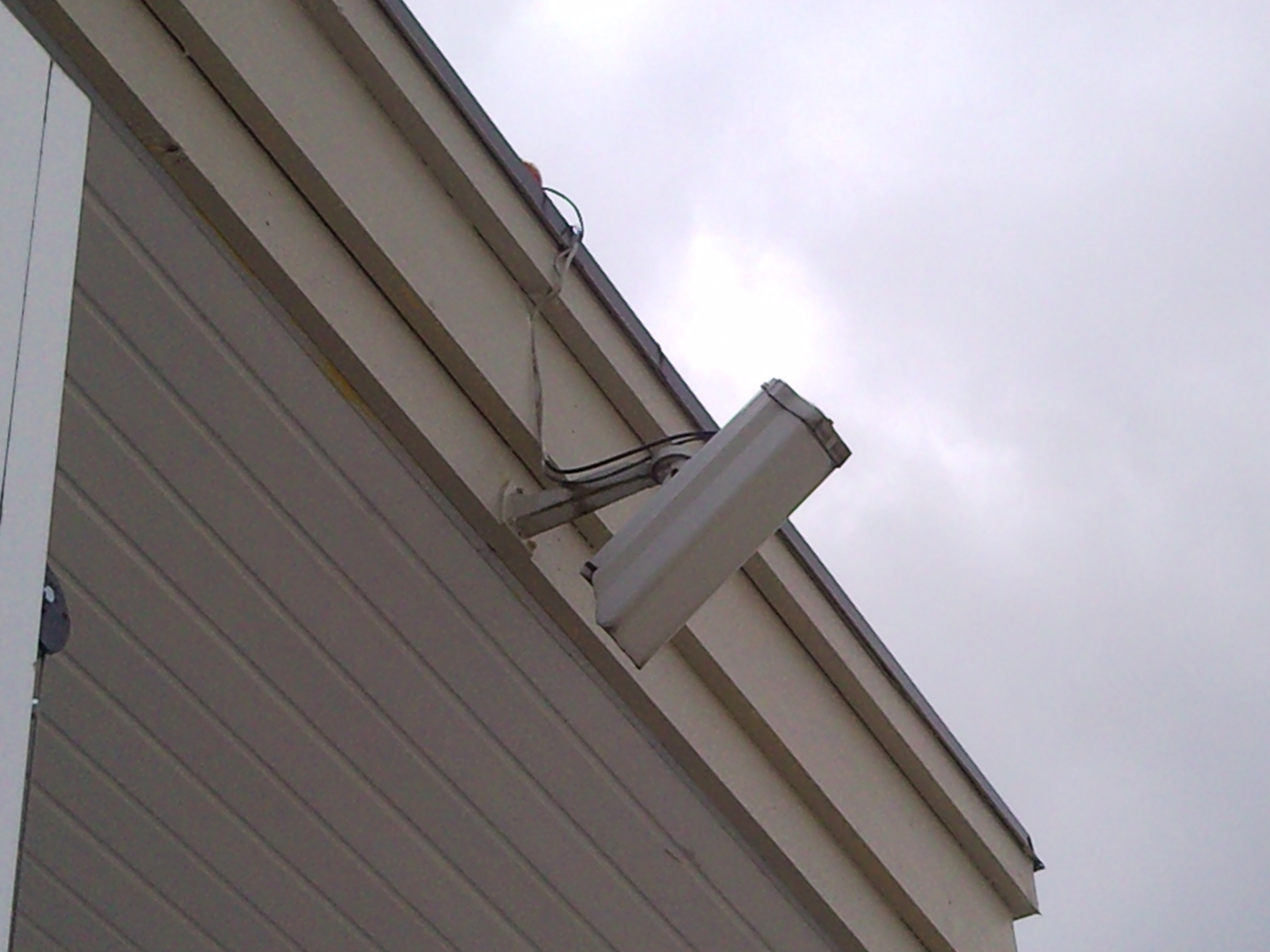

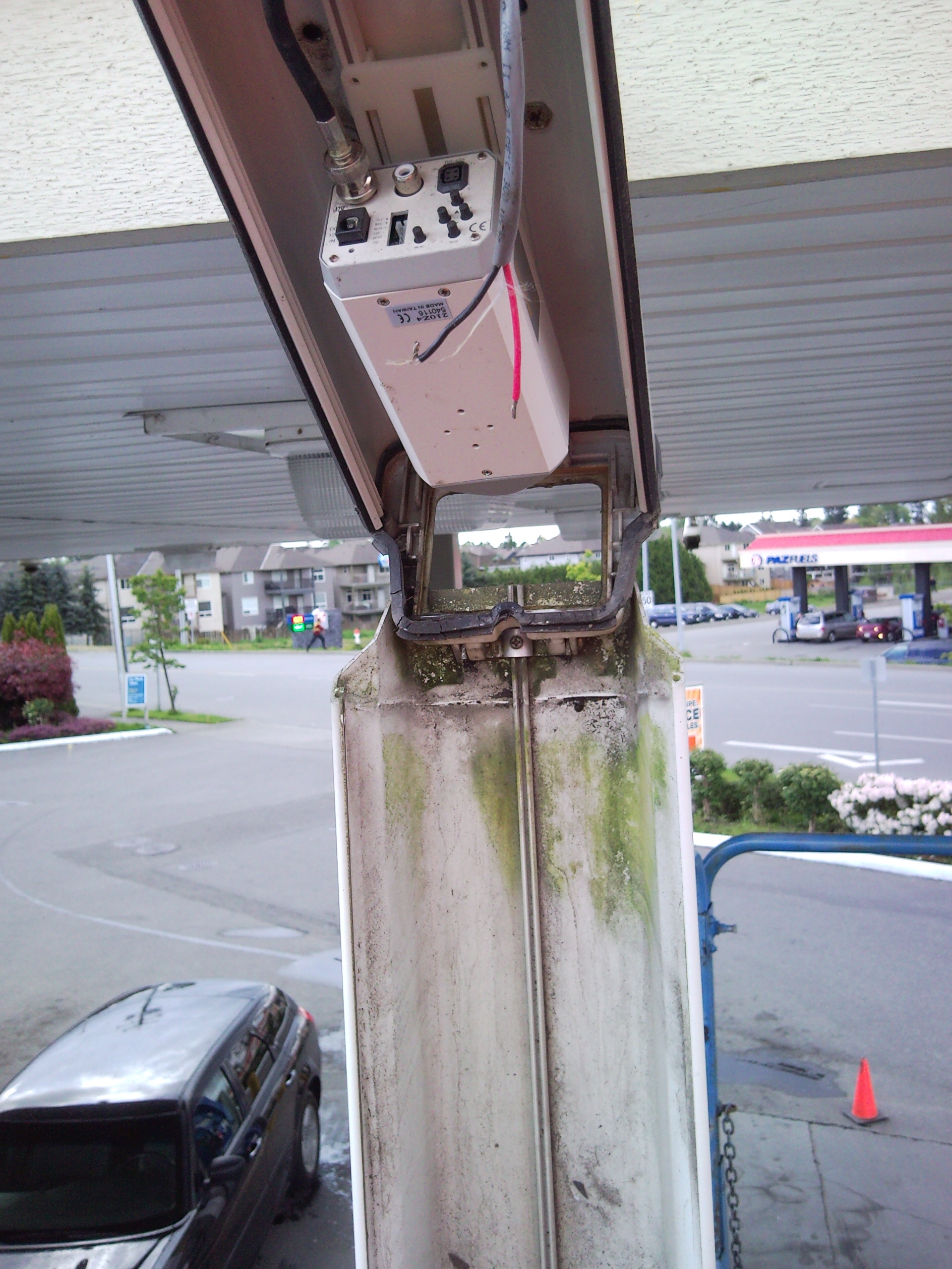

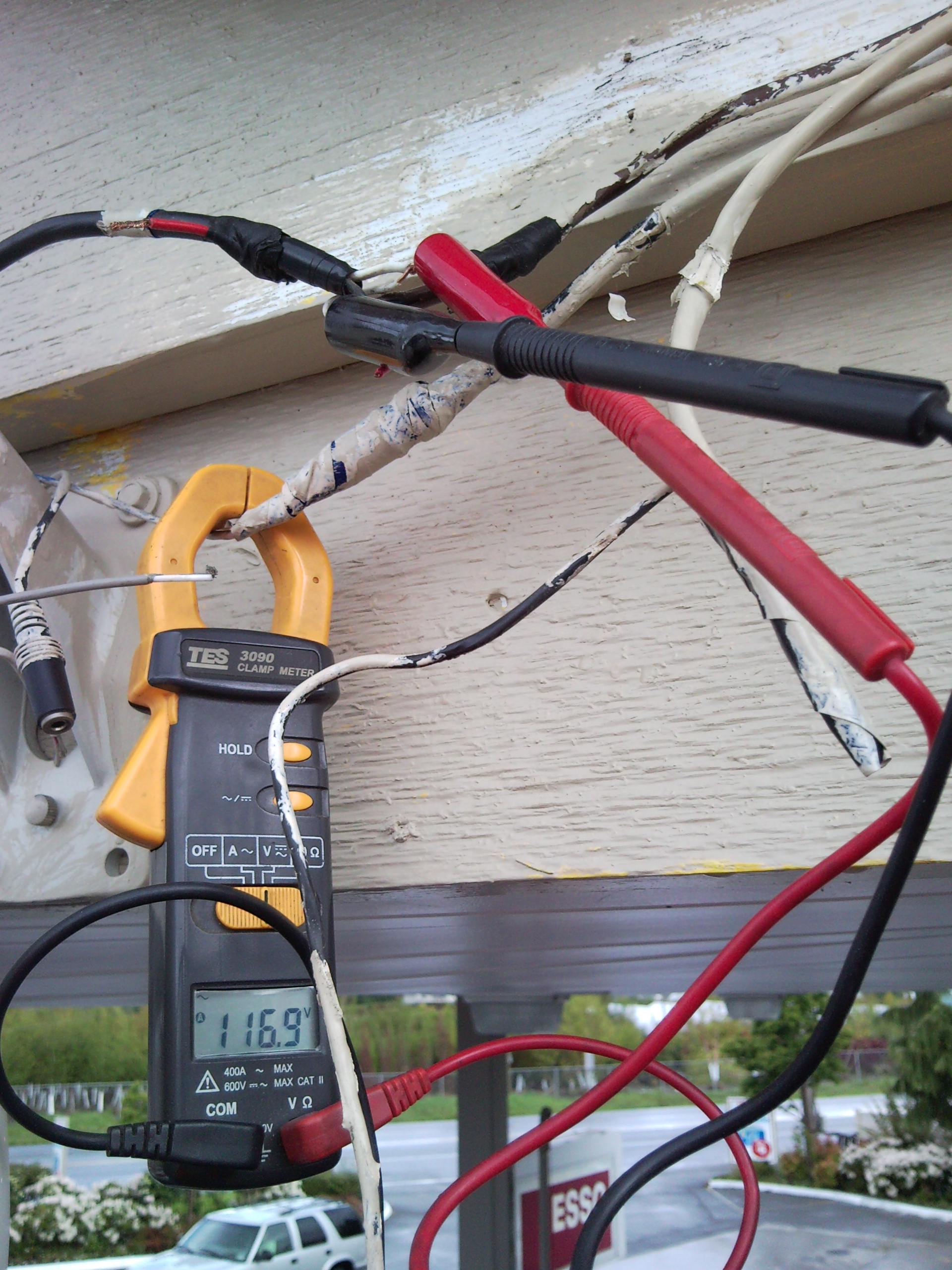

Soundy 1 Posted March 14, 2012 Alright, went back into the archives... sure I've posted these before, but I dunno where... Got called in to a gas station to assess their setup and install some new cameras. First thing we found were two PTZs and one fixed cam on each side of the pump canopy: Wiring was hideous: First PTZ I checked out was filled with water: The next one wasn't, but didn't appear to be working. Started unwrapping connections to figure out which was power... found this splice between what looked like a power tool cord coming out of the camera, and some solid 18/2 bell wire coming over the edge of the roof. Checked for 12VDC... nothing. Checked for 24VAC... uh... WAT??? :double-facepalm: This is the other end of that bell wire, in the C-store ceiling: And this is a splice in the bell wire, running through a gutter: Found more fun stuff on the roof: Share this post Link to post Share on other sites

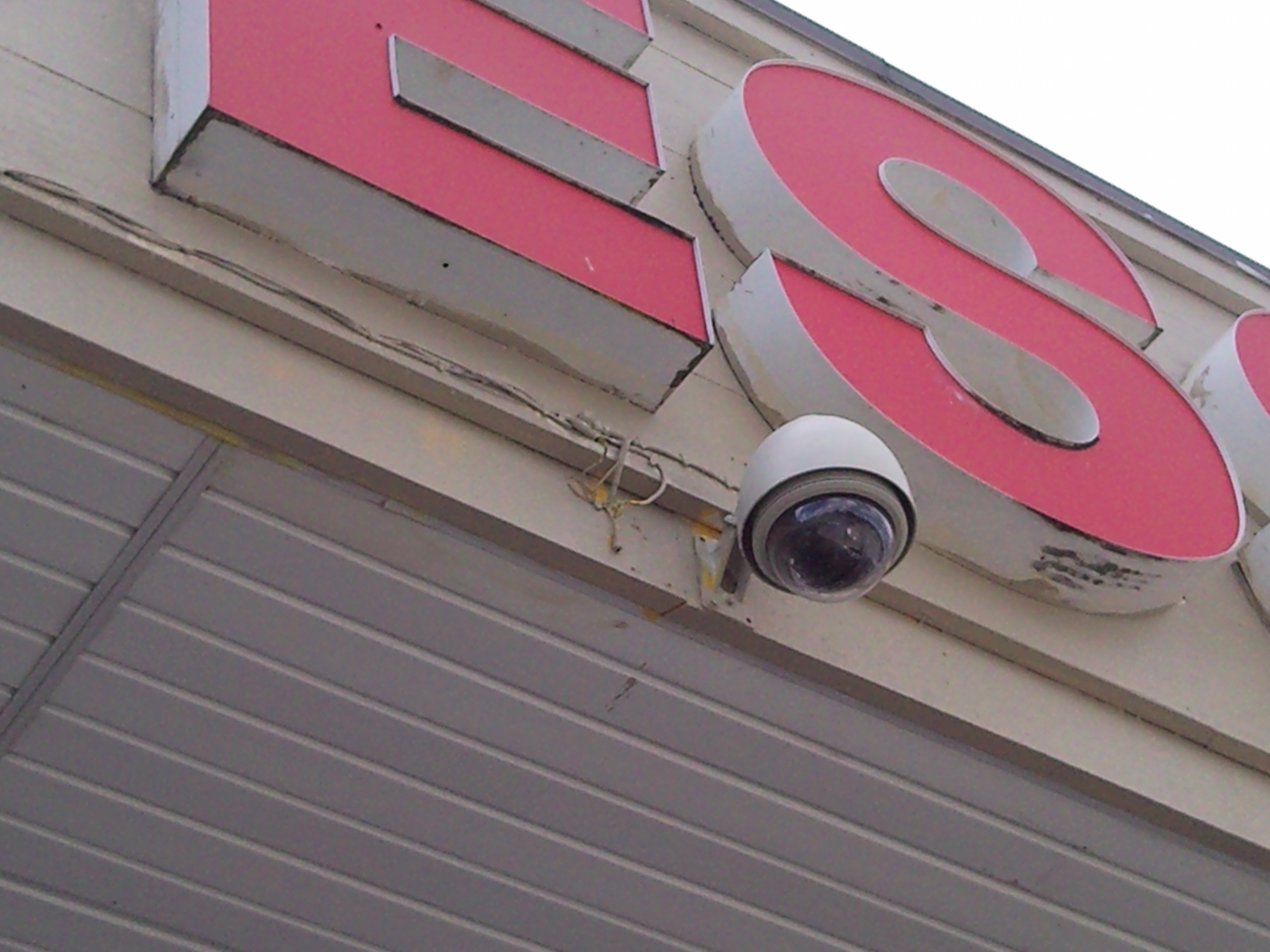

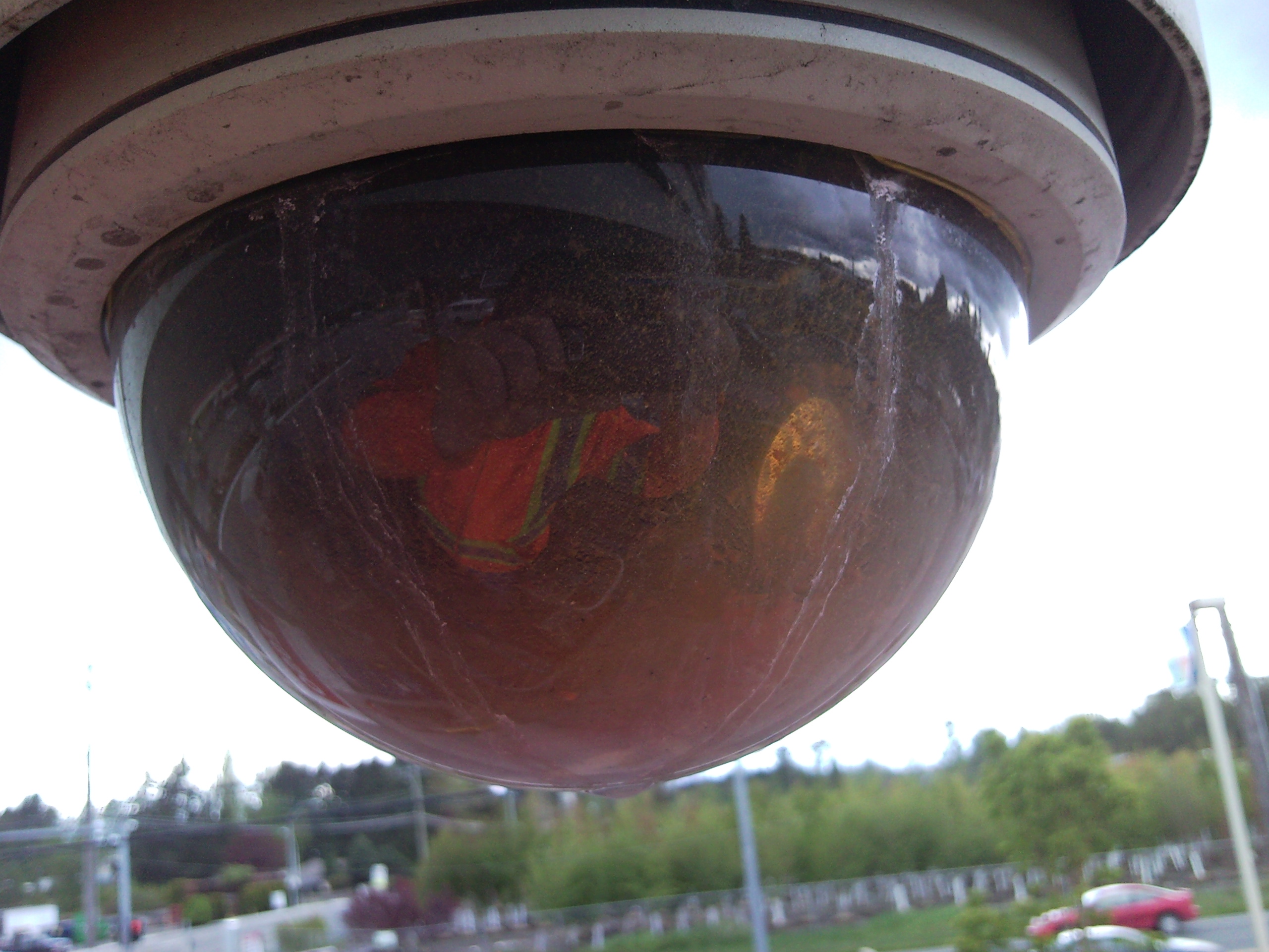

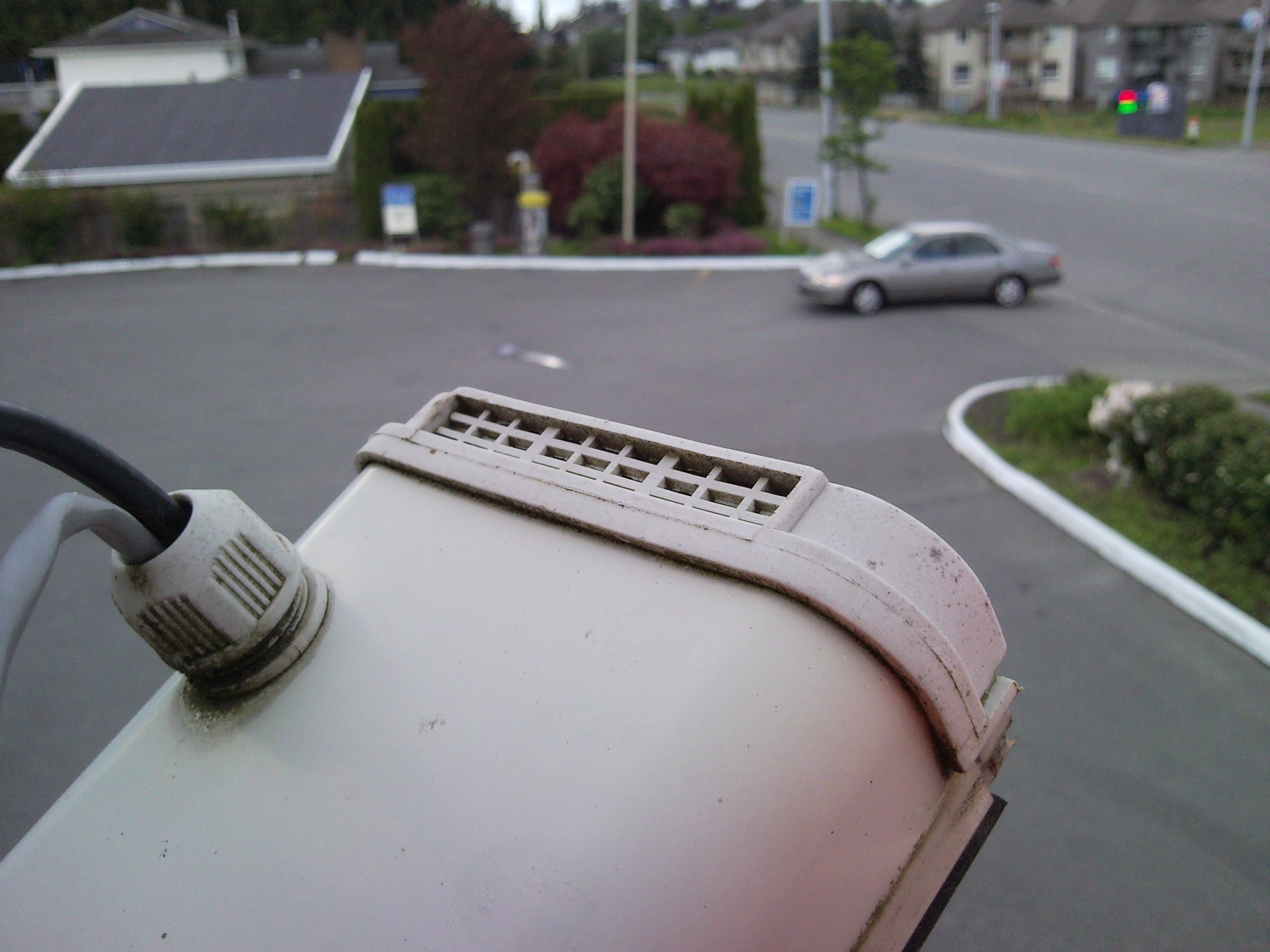

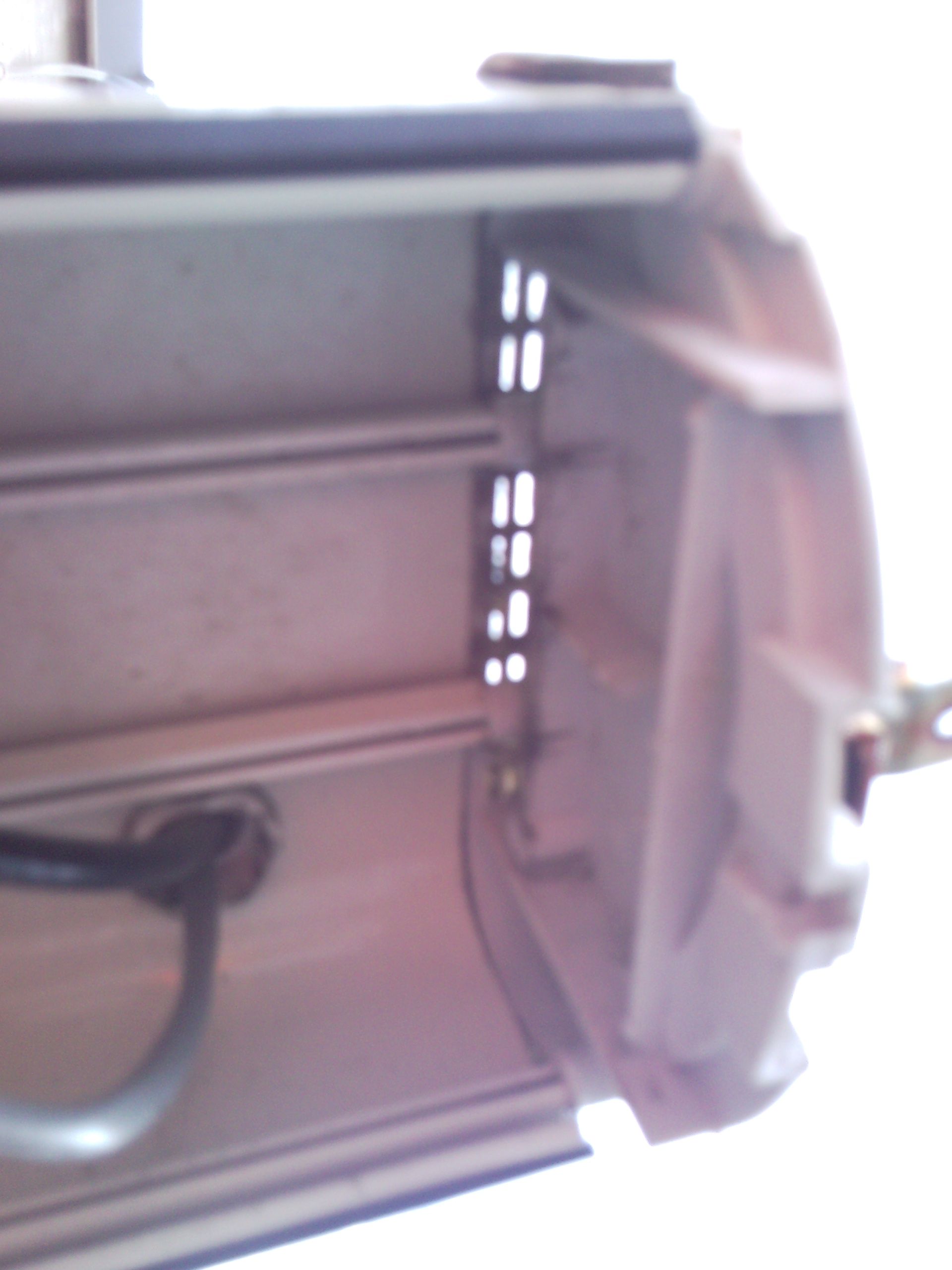

Soundy 1 Posted March 14, 2012 And finally, the fixed cam... looks like a standard Pelco-type housing, mounted upside-down... except this one has vents: Obviously had been some water build-up inside: Fortunately the seal was so poor at the front glass, the water never actually filled the housing... and both cameras still worked! Share this post Link to post Share on other sites
Soundy 1 Posted March 14, 2012 Oh yeah... I told the owner about the 120V running the camera... he said his brother had put all the cameras in. I told him he's lucky his brother didn't cost him his business. When we were done, he said his brother wanted the old cameras... to see if he could fix them. Uhhhh... okay man, you have fun with that... Share this post Link to post Share on other sites

Numb-nuts 1 Posted March 15, 2012 I absolutely love the upside down camera housing with the vent. Of course this is the only way to guarantee that water can get in. I don't often swear but this lot made me so outraged I found myself swearing out loud. I have NEVER seen anything so poorly put together, this install takes the biscuit and I bet his brother charged him a fortune too? Share this post Link to post Share on other sites

SEANHAWG 1 Posted March 15, 2012 Quite the amazing colors that the PTZ has due to the water, I guess that it one positive way of looking at it........... Share this post Link to post Share on other sites
EarlT 0 Posted March 15, 2012 I absolutely love the upside down camera housing with the vent. Of course this is the only way to guarantee that water can get in. I'm sure it was logical to install it vents up if the weather was hot and dry. Best way to vent that excess heat. Share this post Link to post Share on other sites
jeromephone 6 Posted March 15, 2012 You were lucky you did not get zapped from the 110 Share this post Link to post Share on other sites
