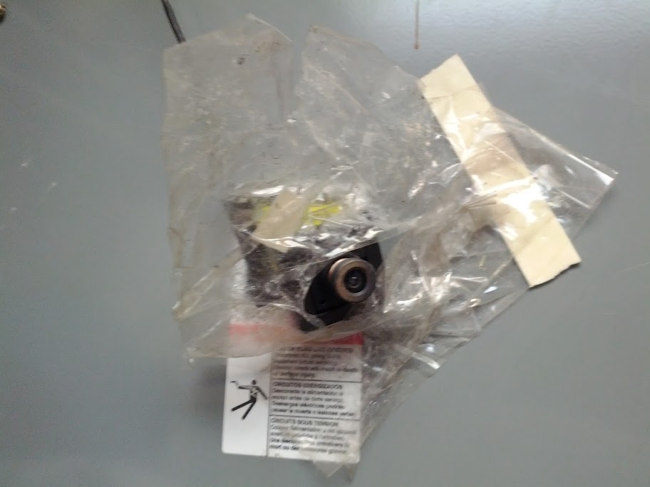

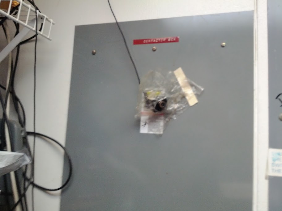

CHoffman 0 Posted April 27, 2012 Came across this gem at a Murphy Oil gas station...I had to swap it out because "it quit working" Yep that's a camera held to the breaker box with packing tape, stuck right to the warning label... " title="Applause" /> " title="Applause" /> " title="Applause" /> " title="Applause" /> " title="Applause" /> " title="Applause" /> Share this post Link to post Share on other sites
tomcctv 189 Posted April 28, 2012 for only $1.29 he could of made a better job with this stuff. Share this post Link to post Share on other sites
myplace46 0 Posted May 2, 2012 Hmmm... wonder why it quit working? Share this post Link to post Share on other sites

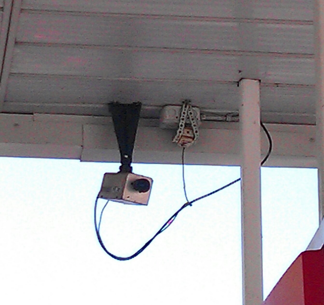

buster74985 0 Posted August 9, 2012 Another great installation at a local school in North Texas. Someone must have found the box of seal-tite and decided that was "good enough"! Share this post Link to post Share on other sites
digiblur 0 Posted August 10, 2012 Found this while browsing YouTube. Not as bad as some of the examples here, but seeing all those wires draped willy-nilly all over the place just makes me cringe. That video was done by a very active & helpful member here who did a first time CCTV install for his home. Actually not bad for a first time DIY job in my opinion. I'll second that. He also provides some much needed perspective and with the tight shots actually has better coverage where needed than some of the "nightly news" shots. I'll take usable shots over a few temporary wires anytime... I do agree on the great resource, no denying that. Just needs to improve a bit on the install, I'm hoping he has since this looked like the initial install. Everybody has to start somewhere and learn from their own mistakes. Share this post Link to post Share on other sites
vector18 1 Posted August 10, 2012 Another great installation at a local school in North Texas. Someone must have found the box of seal-tite and decided that was "good enough"! I bet if you looked on the roof of that building, you can put a ladder on there and still not reach the top of the brick. More than likely, the handy box is the highest point of entry into the building and thats why that installer did what he did. It may look horrible, but I have a feeling there was a reason. Share this post Link to post Share on other sites
dustmop 0 Posted August 10, 2012 Another great installation at a local school in North Texas. Someone must have found the box of seal-tite and decided that was "good enough"! I bet if you looked on the roof of that building, you can put a ladder on there and still not reach the top of the brick. More than likely, the handy box is the highest point of entry into the building and thats why that installer did what he did. It may look horrible, but I have a feeling there was a reason. I've encountered that more than a few times. But I use rigid conduit then. I only like seal-tite for the < 1 foot from the box at the top of the conduit to the camera. It's also cheaper to use conduit than that much seal-tite! Share this post Link to post Share on other sites
vector18 1 Posted August 10, 2012 Agreed, it comes out straighter and cleaner if rigid is used. I was just explaining in case someone did not realize why the guy put a box so far down and than went all the way up. I'm also guessing its covering a large parking lot. And I only like to use seal tight if I have to come off the building with it, not running on the building. Share this post Link to post Share on other sites

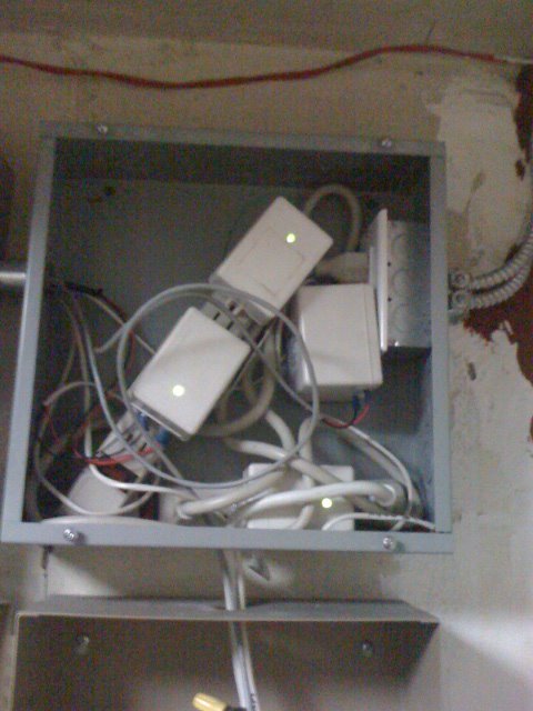

ssnapier 0 Posted September 3, 2012 This is all of the alarms, telephones, CCTV and data links for a main guard house at an Army base. Oh and to make it worse it is right on the front of the guard house so if a car were to ram it, all of this stuff is toast. We replaced a bunch of this stuff recently... they are much safer now! Share this post Link to post Share on other sites
