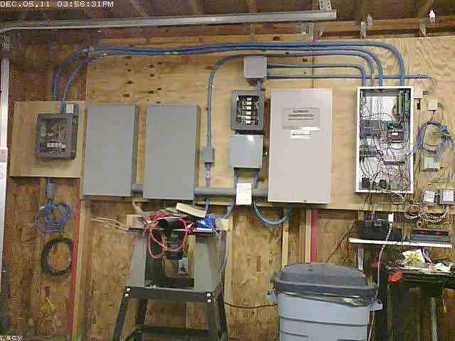

So...I have a Panasonic BL-C210A that I bought for something else. It's not a megapixel camera. It has a 3x digital zoom (like the Axis M5014). With the camera sitting on a ladder about 10' from the "wall" I want to watch, I'm not able to see enough detail, with our without zooming in. Pardon the mess due to the "work in progress", but here is a snapshot taken by the BL-C210A (no zoom)...
Near the bottom right, just below the plywood, there is a grey display sitting on a white shelf. You can just make out the red LEDs. That device monitors my LPG tank level. About the middle of the wall, there is a grey fiberglass box with a clear acrylic cover that has six relays in it. The relays each have an LED that would be nice to see, but aren't visible with the BL-C210A. The similar, larger box on the far left also has relays with LEDs. It also has a water well pump monitor in it that has an LED readout. That LED readout is the one with 1/2" letters that I really want to be able to see with a camera.

Digital zoom is useless.
You need to capture the detail optically. If you are not capturing the information, then no matter how much digital "zoom" you apply, you are just zooming in on more pixelated non-information.
You'd probably be better off relocating the LPG tank display to a location where you can put a camera within 8' or so of it. That would allow you to use one of the cheaper megapixel cameras with built-in lenses.
