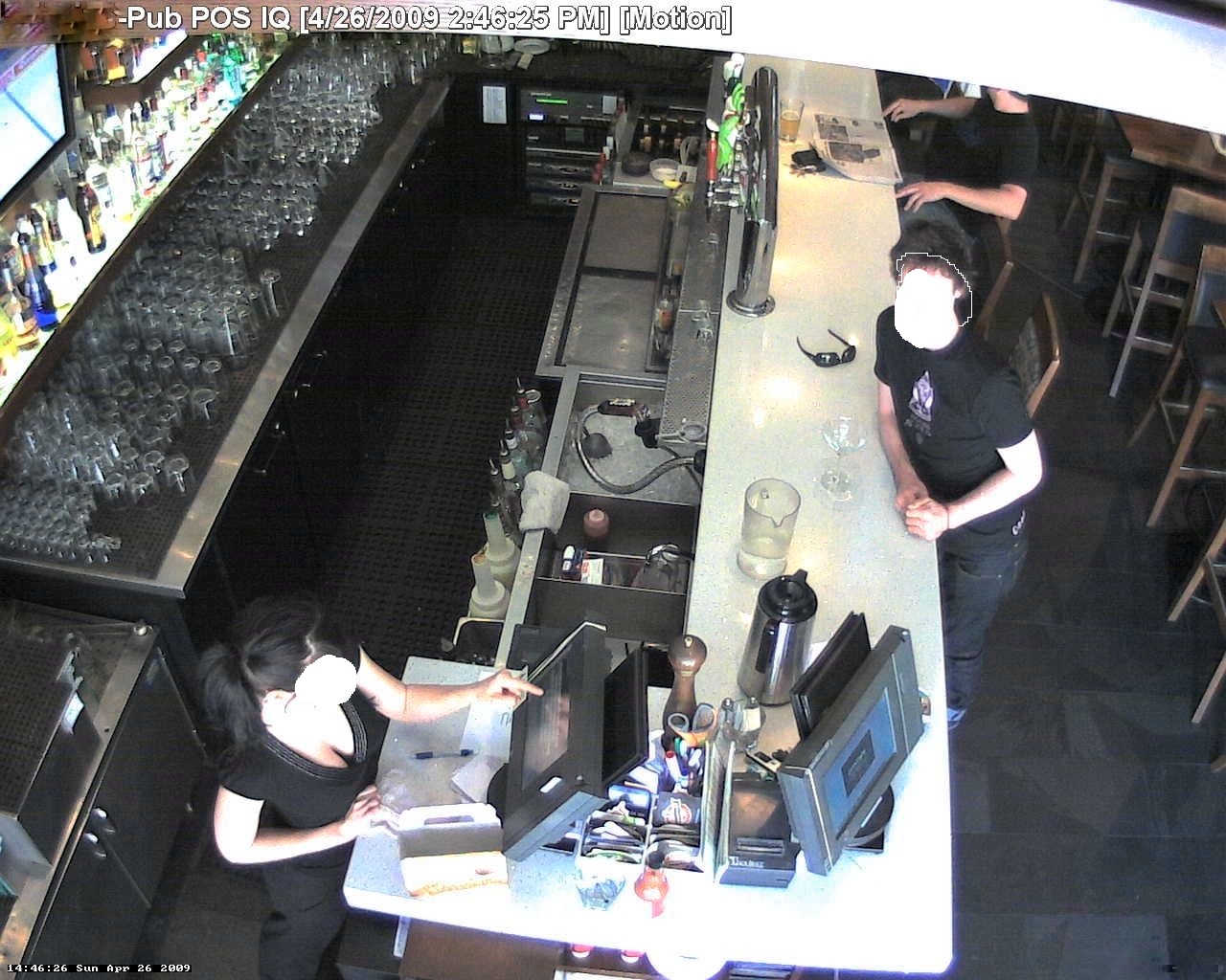

Soundy 1 Posted December 19, 2011 its one reason we use the small stand alone dvr over PC now, they can take the heat where PCs cant. So is there a point of using a pc for a IP CCTV Surveillance System ? Even if I use a server grade components, would that still not do the trick ? You have to remember that Rory lives in the tropics - the heat his systems have to deal with year-round isn't relevant in most of the developed world. PC systems offer some major benefits, not the least of which is how expandable they are. Not a lot of standalones will let you extend your storage with USB, Firewire, eSATA, or network drives, or using RAID storage arrays. Not many support offsite storage, something that can be easily configured on most PC-based systems. Usually, the DVR software doesn't even have to support it; as long as you can give additional storage a drive letter, most software can use it for writing video. Of course, if you are using IP cameras, a PC-based system will allow you to install the necessary manufacturers' configuration utilities, something you can't do with a standalone. You can also install and run backup software, time-sync utilities (if, say, an NTP server isn't an option), mail-relay utilities, etc. You can directly access the file system to extract or backup video files, something almost no standalones will let you do. For that matter, you can remove the drives from a dead system and usually extract video from them or even plug them into a working system and still read the data, something that can be a sketchy proposition on a standalone (some will immediately format any new drive you insert). Share this post Link to post Share on other sites
ssmith10pn 0 Posted December 19, 2011 Nice Cleavage shot! " title="Applause" /> Share this post Link to post Share on other sites
