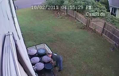

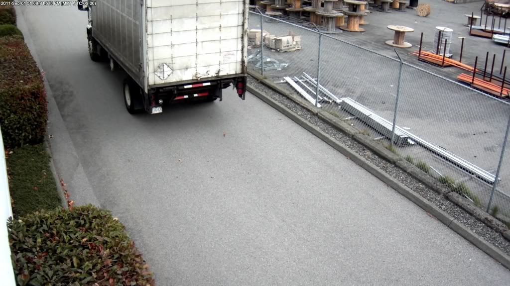

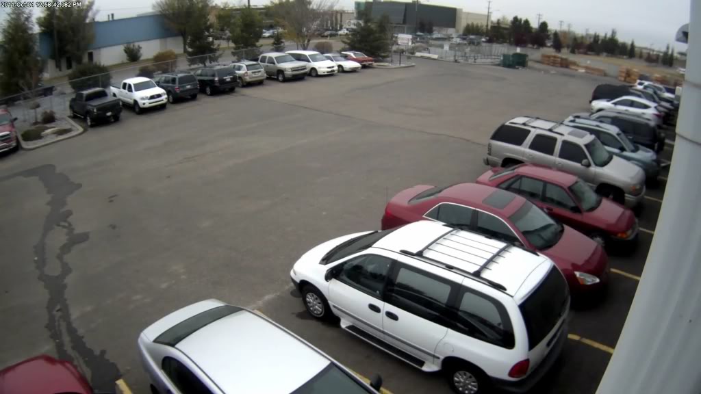

I'm just a diy guy who installed my own residential analog camera/dvr system. Maybe pro installers will disagree with my suggestions.
From my install for illustration-
High shots, like from a barn eve or attic window or up on poles
Tighter shots, better for ID puropses-
A combination of wide and tight shots is nice. I see you got cameras. Don't know what they are, but place them well. I'd guess that five won't be enough. Good luck.
