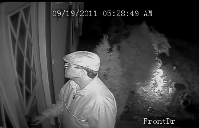

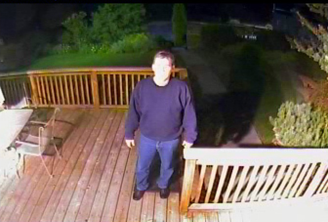

shockwave199 0 Posted January 4, 2012 Motion lights can be good, but they can also give you this when they come on- Different camera with IR and no additional light- The first pic I'm blasted in the face with light and no amount of picture tweaking can get useful ID, and I'm wearing eye glasses in the shot. Not one frame of that footage was useful. The second pic at my home gives a totally useful profile shot for ID'ing, including the clothes and glasses. Dan Share this post Link to post Share on other sites

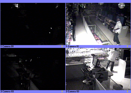

rory 0 Posted January 4, 2012 To be fair IR can do the same thing if you point it right at a persons face. The key is in the positioning of the spotlight. Eg. inside a store, here is a single spotlight, left is before the light activates. PS. this is from 7 years ago ... old Kalatel DVR over the network. Share this post Link to post Share on other sites

shockwave199 0 Posted January 7, 2012 Soundy said: blake said: I see what you mean Rory.I've noticed in residential settings,homeowners typically aim the motion lights a little low.So Dan's issue can be resolved by aiming his lights a little higher and or further left or right to spread the light pattern a little better. They may be using the wrong bulbs for the position as well. Standard thread-base PAR bulbs come in a wide variety of coverage patterns, from very wide floods, to very tight spots. True- all that could help but not enough. Problem is the motion light was there first- a two bulb fixture and the bulbs are aimed wide. And then the camera was installed poorly, imo, with no consideration of the problem to come. Just be aware of such things when motion lights are part of the equasion work the situation accordingly. Share this post Link to post Share on other sites
